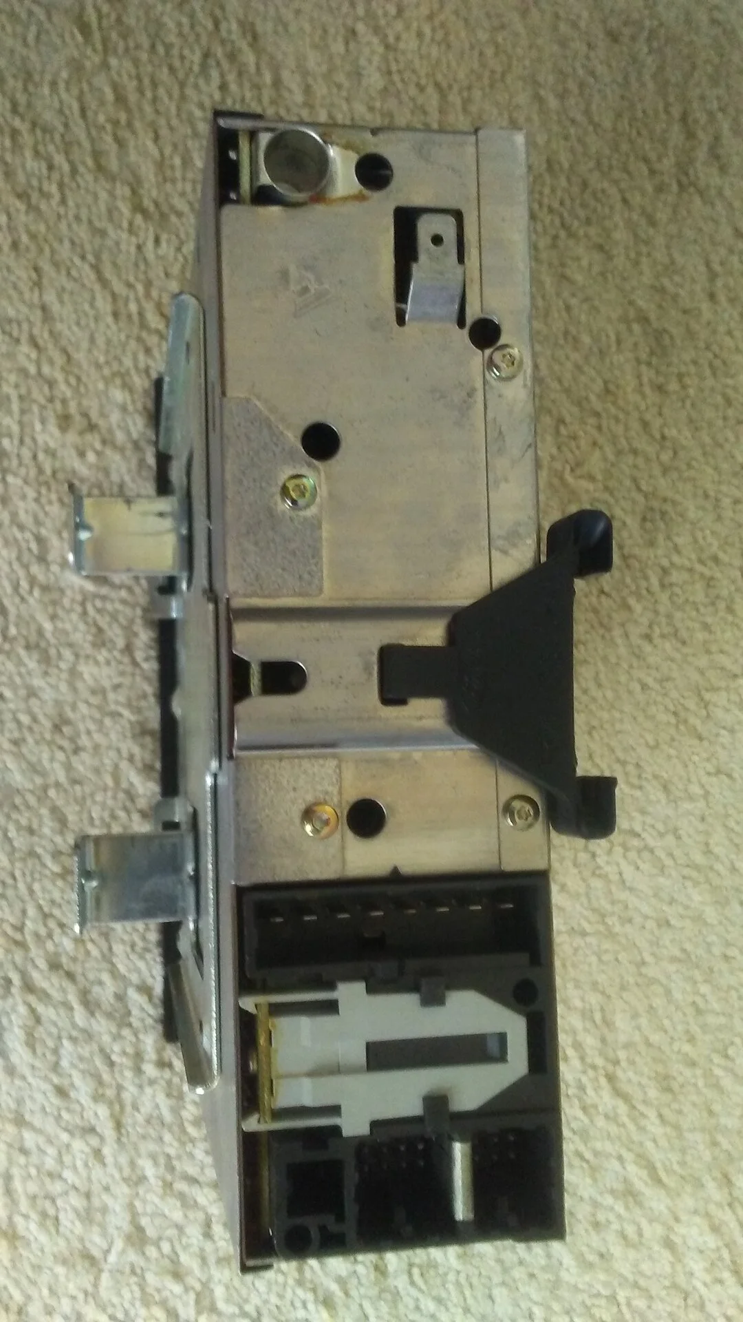

Just looked under the seat and I do have the amp there. In back of radio is 2 clips and antenna wire.

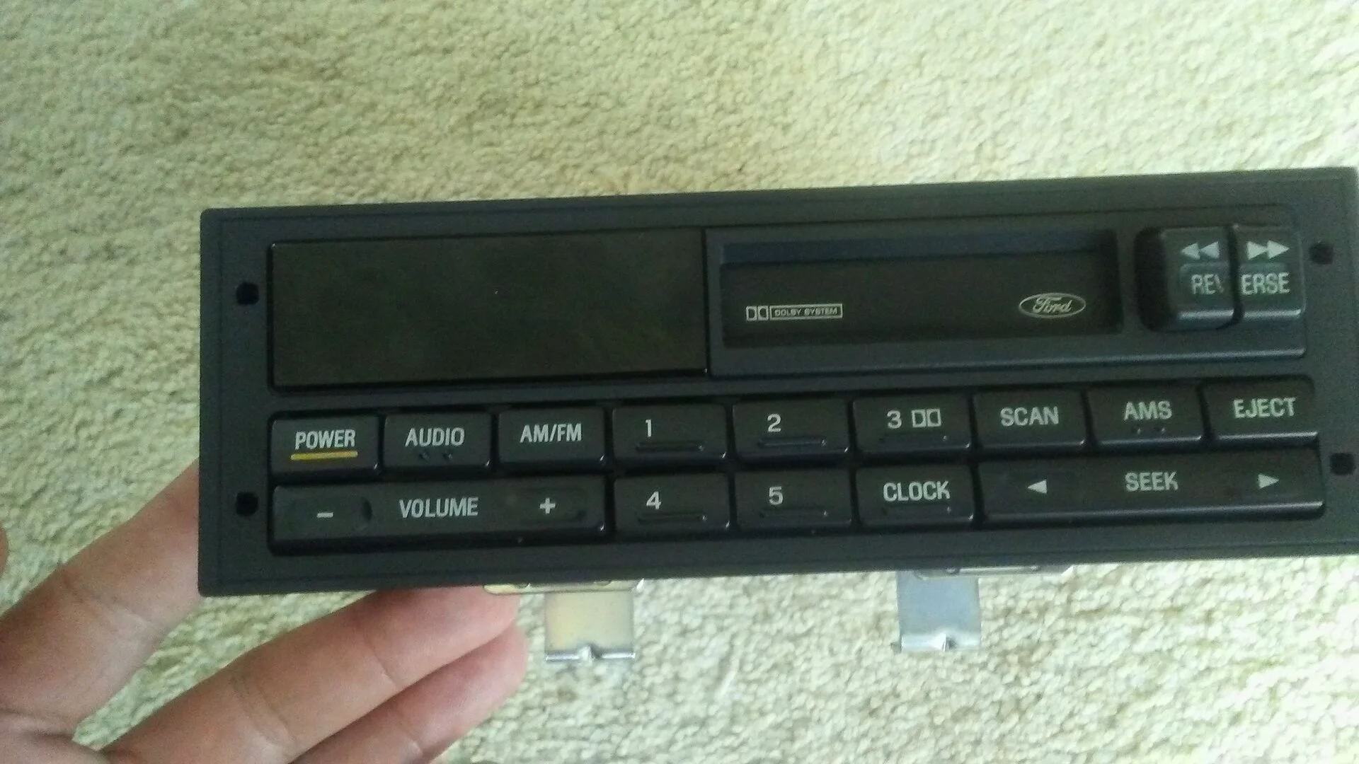

There were two premium cassette players, and one non-premium cassette. Your's is the manual eject premium. There's an electronic eject version as well.

You should have a jumper. There's a way to bridge the pins to get it to work. Did it fall out? Check carefully back there and see if it's loose and behind the console. Without the jumper, you won't have sound.

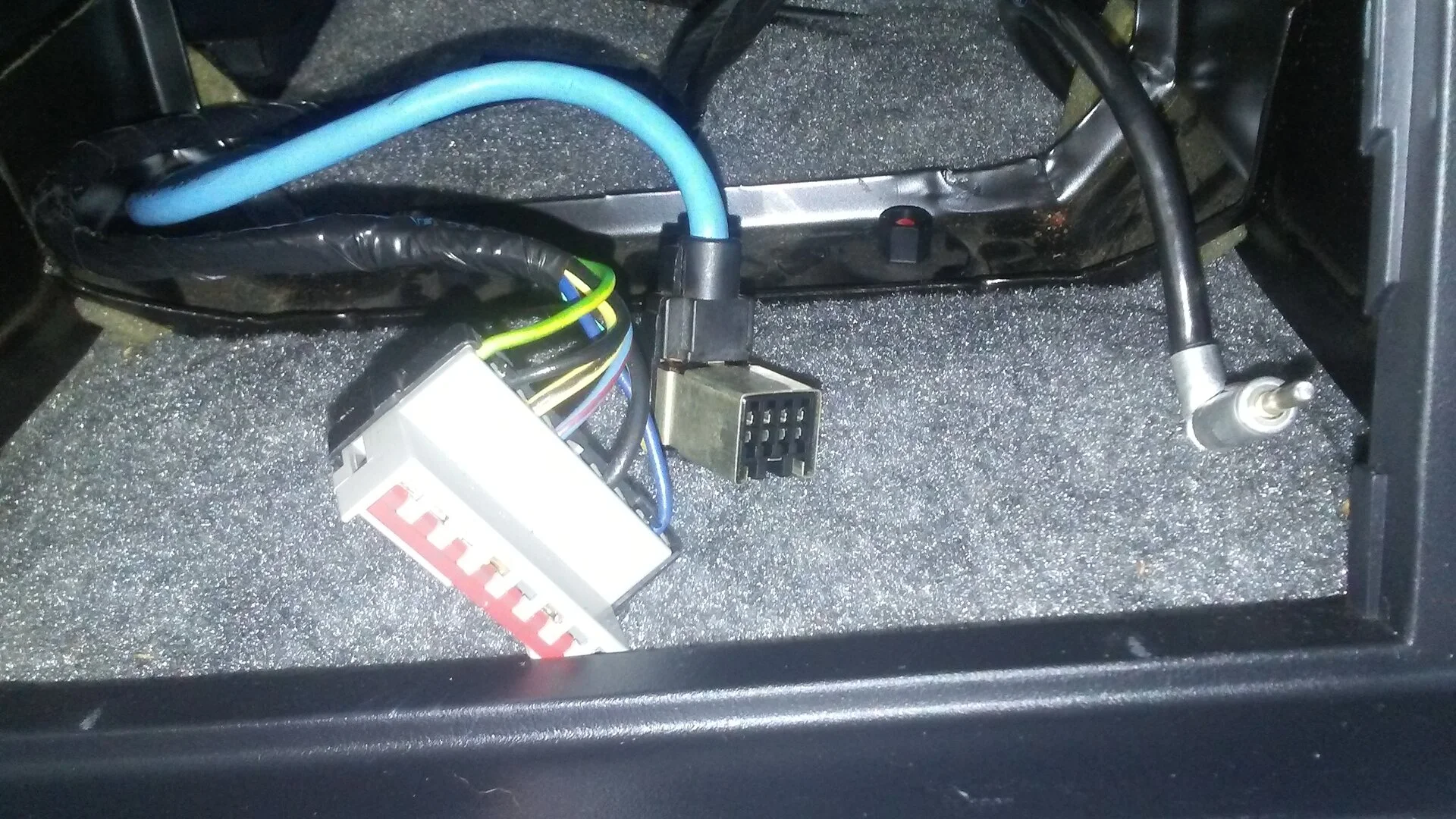

I dont see that little jumper laying around back there. Weird I doubt I ever had one.
These are the clips I have..

That is correct for a 93 premium setup.
If i take my jumper out of my radio, it won't work. I verified this not too long ago for a member who had the same issue.

I haven't seen one, but I know they do exist.

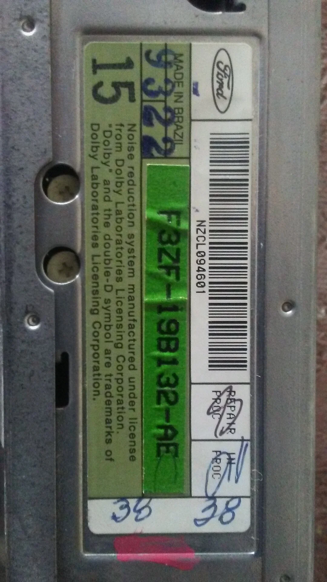

The 1993 Cobra's all got this version. The part number for the electronic eject is F3ZF-19B165-AB. I don't know how it was determined what other vehicles got the version you have but I do know they exist. There's a non-premium version with a different plug setup on the back as well.

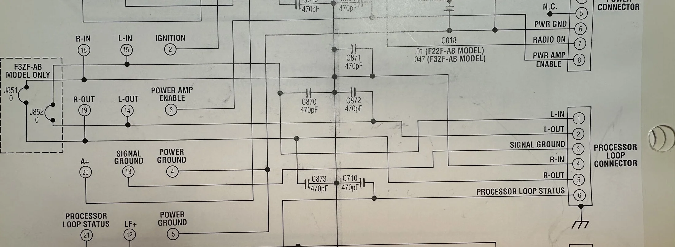

So this one bugged me. But I found out why that particular radio works without a jumper.
I aquired the schematics for the 93 family of radios. It appears the Mustang radios are unique in that they have the jumper internally.
You’ll see below the internal jumpers (far left) so that’s why the external jumper plug is not needed.
Learned something new today
