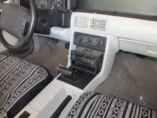

Thanks for the encouragement. Got the heater core bypass in, and tried again on the radio. I think I mistook the instructions on the u-tools. The left side would always wiggle so put that one in first. Then when pushing the right in, just past the contact point it popped out. Think I was jamming it in too far. I'll be back to let you know if that radio/equalizer combo works. Got a couple more questions. The heater control bezel above the radio looks to be held in by 1 screw? It wasn't there. Also, the dash bezel is missing the screw that goes up on the left side of the steering column. If you know where I can find part #'s for these interior hardware I'd appreciate it. Thanks again, you guys rock. Regards, Don

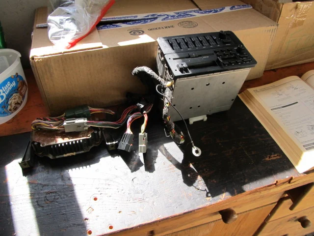

Well, that didn't take long. I thought I could get it to make noise but have a couple more questions. Here's a pic of the radio/eq I have. I'm guessing those flat black and grey plugs will replace what I find on the back of the stock radio. However, neither my Chilton or FSM shows where that ground wire is connected. Also, the FSM shows an EQ filter that bolts under a front seat. I don't have that. Is it required? Any idea where that ground wire bolts to? The geek squad option is looking good at the moment lol!

I'm diggin your seat covers.....
