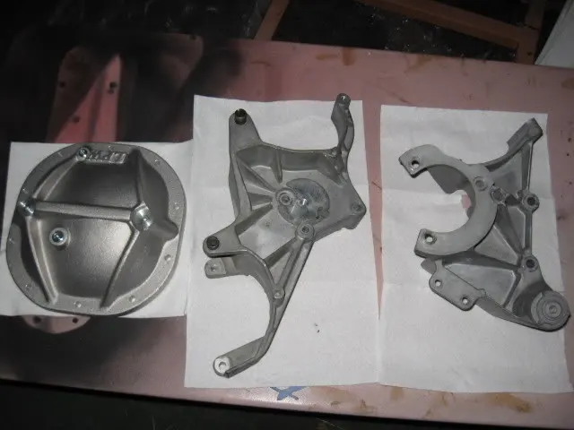

OK, photos for you. The first one is of my Mustang brackets:

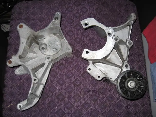

Next one is of the T-Bird brackets. The Alternator/Smog Pump bracket is similar but not the same. The PS/AC/Idler bracket looks identical. Also notice the alignment holes for the belt tensioner are different - a 94/95 one won't fit. Our alternator & smog pump will bolt up to the T-Bird bracket, but I couldn't tell you if they'll clear your engine.

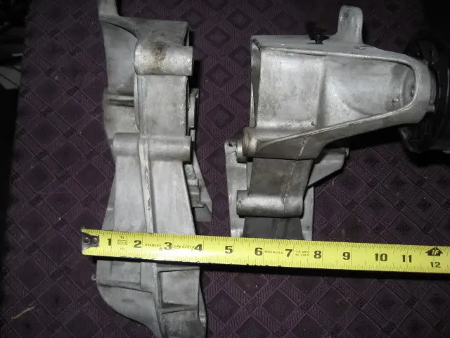

Here's a side profile of the T-Bird brackets with a tape measure to give you an idea of their depth.

Actually, the T birds alternator has the mounting ears at different positions than the Mustang's. Also, the T bird has the small case 3G alternator which is a 95 Amp unit. You can get a small case with 130 amps, but it's an upgrade. You can use that alternator bracket, but like Cynthar said, you must use it's tensionor and a T bird alternator.
