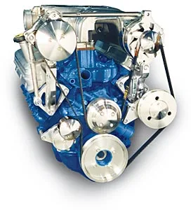

there's only one bracket set that would have any remote chance of fitting but the problem lies in the positioning of the accesories: it's their hotrod bracket and pulley set but they place the alternator and P/S way above the factory spots. I noticed this set because it's the only one they have designed around the short neck water pump that we have in our cars.
http://www.marchperf.com/pg40a.html
That's pretty nice, but the problem isn't where the pullies/Acc. go, the problem is that Ford with a stroke of genuis decided to make our Timing cover thicker, therefore pushing the water pump out farther. If you were to use any after market kit out there, the Belt would not line up correctly. Now if you got an Electric water pump, then you should be able to run the March system:shrug: Just make sure you have a Short belt that wraps without touching the water pump.
Will
I'd have to disagree with turbo's assessment that the belts would be out of alignment- for that hotrod set is designed around our waterpump and the timing cover- if you scroll down a little bit on that page on march's site it says specifically that using that pulley and bracket set requires the use of the waterpump and timing cover from a 94-95.
Due to the slope of our hoods however, setting the accessories that height would create too many clearance issues.
