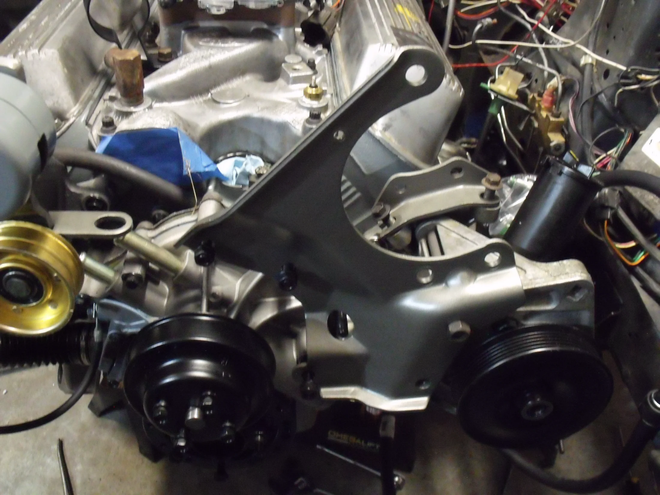

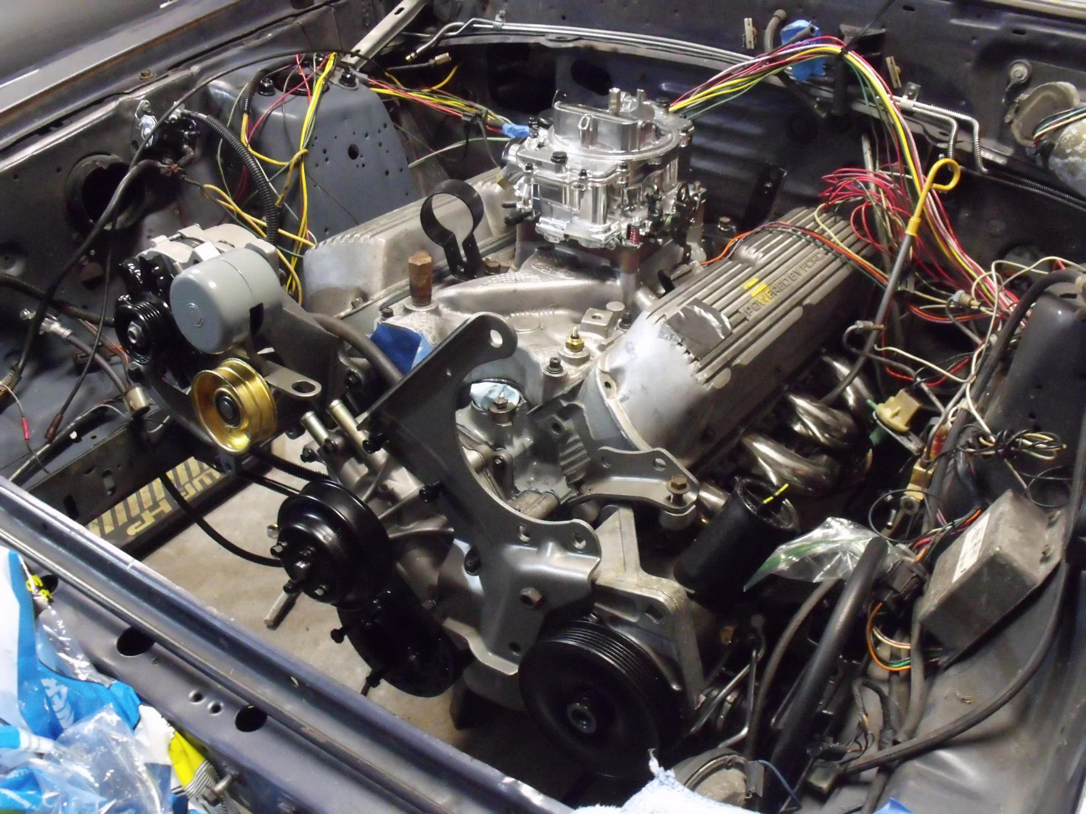

There was no way the brackets my junk yard Mountaineer engine with " p " heads would fit in my 83 mustang. All of my stock 83 accessory brackets did bolt up to the 98 block/GT40P heads....
