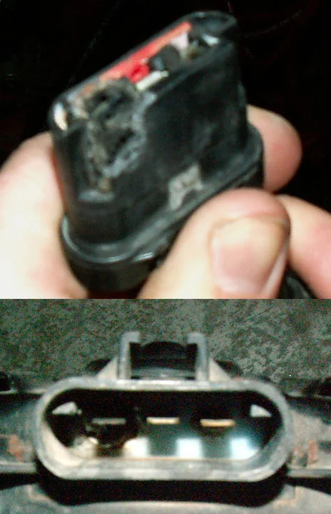

Okay, dug into this deeper at the local Ford dealership.
I had them run my VIN number. My car shows NO RECALLS LISTED. :nonono: So much for trying to get them to give me free parts. LOL
The pigtail is freakin' $32. Guess I'll be going to the salvage yard. He said the pigtail would be the same from 94-97 on both V-8s and V-6 mustangs.
Oh, and I asked the guy at Ford if the V-6 fan was indeed different from the V-8. He said yes, the fan speed is different.

Just a small update of a fuzzy pic of my fan connection:
