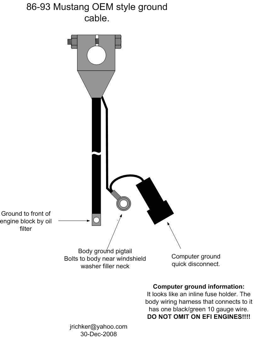

Do the simple stuff first...
Clean the battery posts and block grounds.
Make sure that all the ground places are clean and shiny bare metal: no paint, no corrosion.
The main power ground is from engine block to battery: it is the power ground for the starter & alternator.
The picture shows the common ground point for the battery , computer, & extra 3G alternator ground wire as described above in paragraph 2. A screwdriver points to the bolt that is the common ground point.
The battery common ground is a 10 gauge pigtail with the computer ground attached to it.
Picture courtesy timewarped1972
View: https://www.youtube.com/watch?v=kSkbTmtBZUc
The battery posts and inside of the battery post terminals should be scraped clean with a knife or battery post cleaner tool. This little trick will fix a surprising number of no start problems.
The clamp on with 2 bolts battery terminal ends are a known problem causer. Any place you see green on a copper wire is corrosion. Corrosion gets in the clamped joint and works its way up the wire under the insulation. Corroded connections do not conduct electricity well. Avoid them like the plague...
The secondary power ground is between the back of the intake manifold and the driver's side firewall. It is often missing or loose. It supplies ground for the alternator, A/C compressor clutch and other electrical accessories such as the gauges. The clue to a bad ground here is that the temp gauge goes up as you add electrical load such as heater, lights and A/C.
Any car that has a 3G or high output current alternator needs a 4 gauge ground wire running from the block to the chassis ground where the battery pigtail ground connects. The 3G has a 130 amp capacity, so you wire the power side with 4 gauge wire. It stands to reason that the ground side handles just as much current, so it needs to be 4 gauge too.
