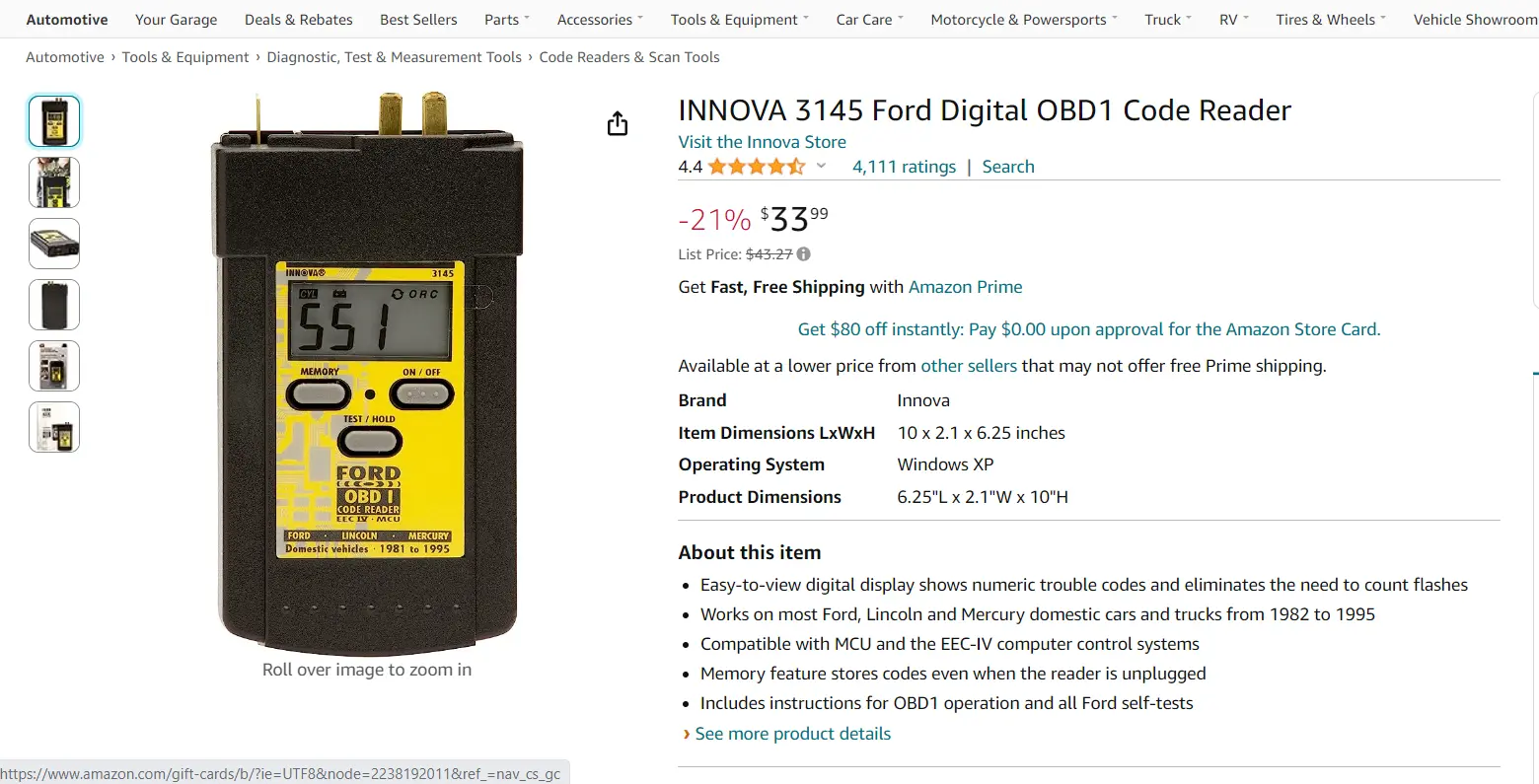

Are you plugging the scanner in under the hood on the passenger side? There is a diagnostic port under the dash but it will not do anything,
You are using a OBD 1 scanner right? The 94-5 models are change-over years, setting up for 4.6 and obd II.
I bought this one at Autozone it works good for my 95 5.0 for that connector in the passenger side engine bay.
