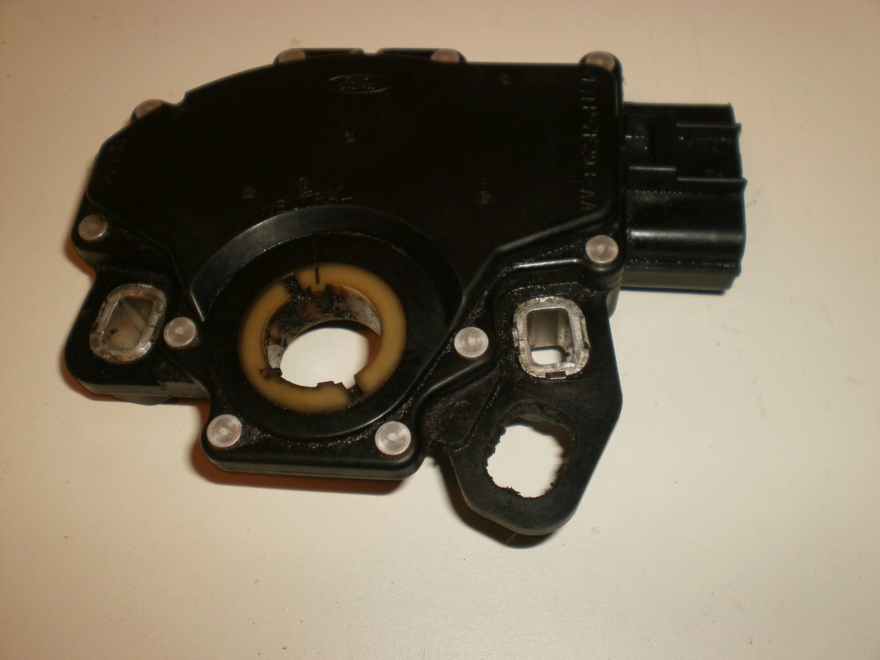

So, you've adjusted the TPS so the two lines on the center ring are aligned? The TPS tells the computer what gear you're in (D, N, R, etc) The switch is on the driver's side of the transmission where the shifter cable attaches. It should look a lot like this:
You can loosen the two bolts holding the sensor on, and rotate it until the two lines on it line up. Beyond that, I'm not sure what could be physically wrong with the linkage to cause your problems.
