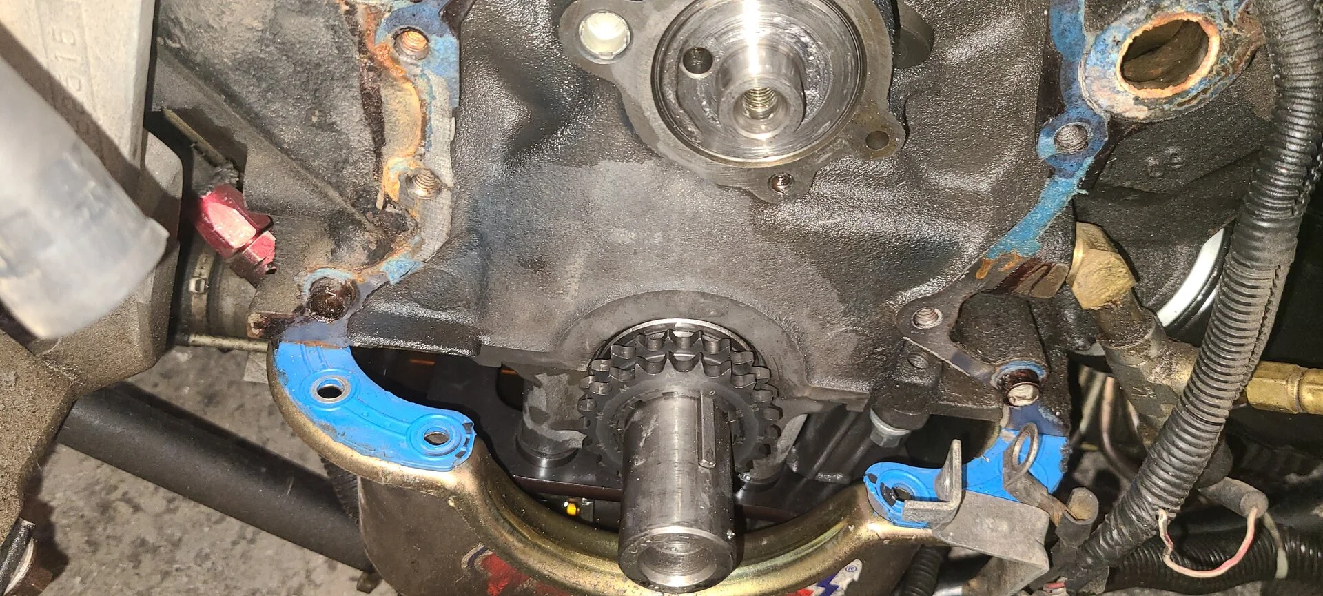

Well, I just heard from the guy doing the work.. and yep. The bolt holding the timing chain in place worked it's way out somehow, and kaboom.. it came off and fugged stuff up. He said it sheared the bolts and front cover off the cam, and did a little damage to it, but it looks saveable.. I only had to go a few hundred feet but I know that's an eternity while this is going on..
He is scoping it now to see if I bent any valves or dinged up any pistons... blah.
Least it wasn't seized lol.

Ok so now mechanic wants to take oil pan off/lift motor...what for? Cam looks ok...
Why take off the oil pan? If something broke, it will usually end up in the pan. Sparkles in the oil mean that some of the bearings are failing. At this point, you're probably looking at a full tear-down to find out went wrong. And I would recommend a full rebuild just to make sure there are no hidden problems inside.
And I just can’t imagine that if the timing chain stopped turning while the bottom end continued around that there wouldn’t be all kinds of bent valves, but maybe these engines aren’t interference with stock or small cams.
You can see a girdle on the main caps, i’d expect it to have an aftermarket cam with enough lift to be of concern.
All a valve had to do to get bent was touch the piston..scoping may or may not show that.
there is stuff in the pan, when the bolts sheared, that’s where it went..I’d do more than just remove the pan. Theres no way i’d just throw another cam and timing chain on this and call it done

I agree. If the bottom end kept spinning and the camshaft wasn't, I'd be amazed if a couple valves didn't kiss a couple pistons. These engines are interference. I'd be pulling the engine apart and checking everything after a timing chain failure like that.

I agree. That's probably the ticking noise when cranking. Scoping isn't going show much unless they're really bent. Leak-down test is the way, plus it will tell you which side is bent based on the location of the leakage air noise / flow (intake side, exhaust side, or crank case).
Lost a timing chain (gear blew apart) about 20 years ago on my T-Bird 302 (1984 non-HO low-compression non-roller so not the same thing entirely) and the pistons hit the valves hard, all of 'em. Pushrods were all kinds of interesting pretzel shapes, but the pistons were undamaged. I ended up replacing the valves anyways since I had the heads off to inspect everything (no $15 borescopes back then) but none appeared bent on removal (they could have been damaged enough to lose compression, just visually seemed ok). So while this is an interference engine, the pushrods are the weakest-link by-design so there's some small but not insignificant chance the valves and pistons are undamaged. Check all the rocker studs / bolts too, one of mine sheared off in the process of bending the pushrod. Agree with @WhiteCobra95 leak-down test should be easy after you pull all the damaged pushrods and you don't need to replace anything until you know (a compression test you'd need to repair everything first). Keep your fingers crossed and say your prayers, you might get lucky.
