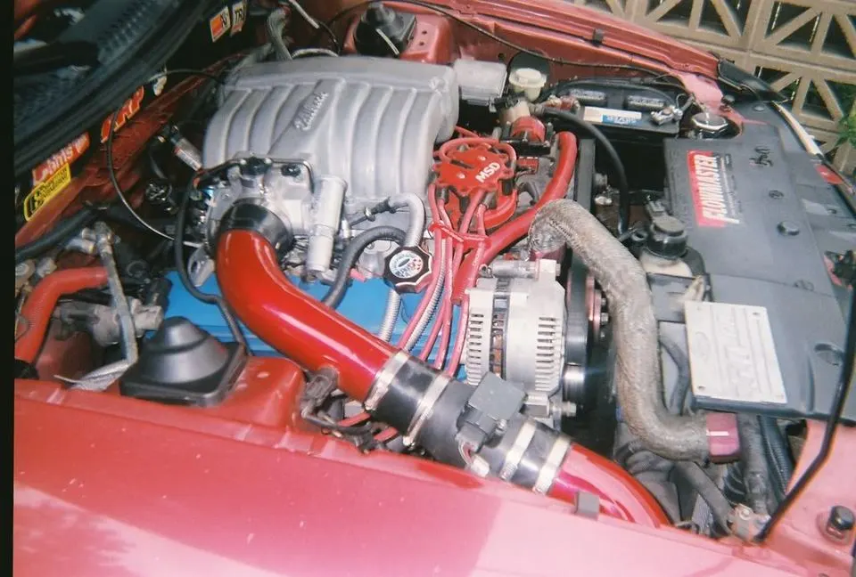

My mods are not at all like yours (I'm sure others have done so). My turbo put a lot of heat into the engine bay, but I was able to see the temps and adjust when the fan comes on with the Quarterhorse -- Bama should be able to adjust that for you, for me it made a bigger difference than the old-school low-temp thermostat -- the big intercooler opening in my ugly bumper helped too). You can guess how hot you're actually running based on when the fans come on (the stock tune turns them on at 208, and to high speed at 224) assuming your temp sender (the one that feeds the ecu) is good.
There are actually 2 temp senders, one tells the computer how hot the coolant is, the other runs the gauge, so they don't always match up. You can "test" using a laser thermometer on a coolant hose, or as you mentioned install an aftermarket gauge, and see how hot you are when the fan kicks on -- you should be around 208 degrees. If not, the sensor being used by the ecu might be off. You can also then check where the gauge sits, and whatever letter is your baseline for 208.
The high-speed fan goes off at 220, and the low-speed goes off at 204, if that helps in your troubleshooting at all.
I believe that should read "low-speed fan goes ON at 220* and OFF at 204*". High speed ON at 230* and OFF at 220* or ON with the a/c on at any speed less than 48 mph.
