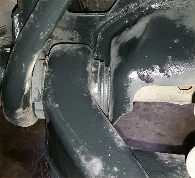

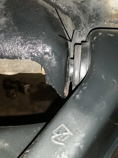

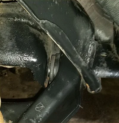

There seems to be a gap like a bushing is missing on the drivers side Lower A arm.
Can the Lower control arm bushings being bad cause a front end shake when braking?? That part I don't know?

Here's the driver side rear part of the lower control arm. Is there something missing?
Another shot.

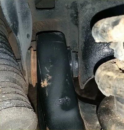

The front part of the lower A arm drivers side.

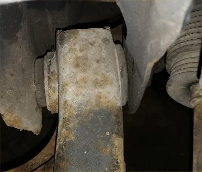

Passenger side rear of the lower A arm....Don't have a gap like the drivers side?

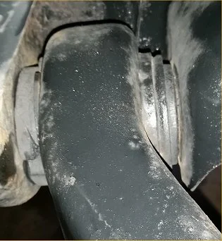

Another shot
Front of the passenger side lower A arm

My buddy looked at it, and said the lower control arms cannot cause the shaking when braking???

So the lower control arms don't normally cause shaking when braking?

From my experience no, but that's not saying it doesn't help.
