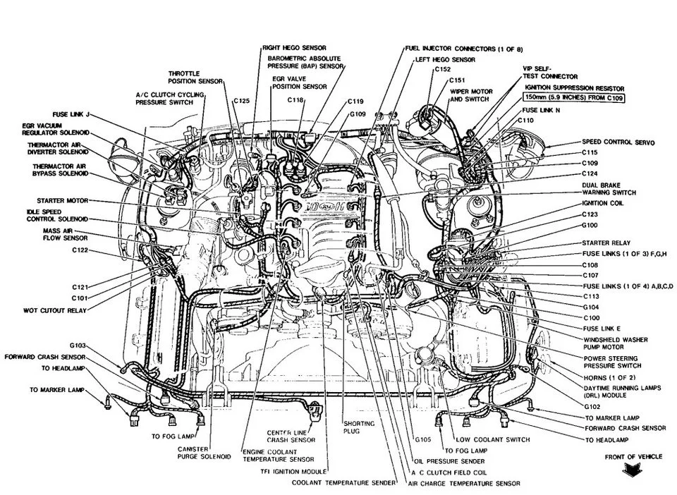

Can some give me a picture or show me what the ait is? Im not sure if its hooked up or not
If you don't have the OEM air-box, you can put it pretty much anywhere in the inlet tract.
This may help:
