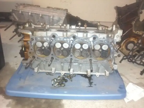

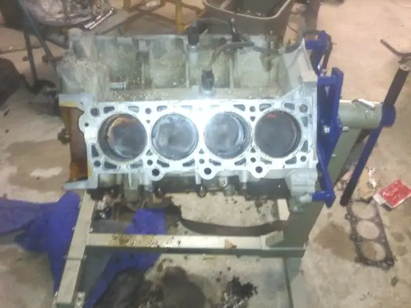

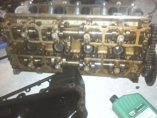

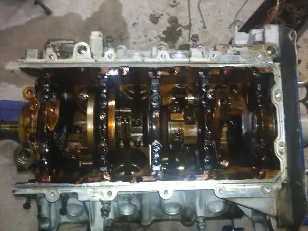

Here are the pictures:
My bad. I saw "head swap" and assumed you meant swapping 4 valve heads onto a 2 valve block. So I change my vote to head swap. Sorry for not reading thoroughly.
The Cobra block has a forged crank but the bearings, rods, and pistons are the same material as the GT.
If you do get the Cobra block then I'd advise you to take your time with it and put new bearings in it. It is already halfway disassembled so you might as well put fresh stuff in it. You could even buy some new rods and pistons for a few hundred dollars. That way you'll know that everything is reliable. But I still say go with the heads and cams swap!!

We need more info on the Cobra motor. How many miles, what car it's in, ect.

Personally, I would not toss bearings into a engine unless I was going to disassemble it all and have it machines and checked and re checked by me. Knowing it runs well and has reasonable miles and you don't have much $$$ in it, go with it. I would, however pull a cap or two and check them.
