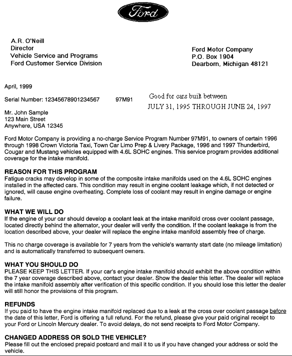

You can try using this as a search starting point. good luck
It has undoubtedly been edited for various reasons but there may some valid points in it.

I don't think our cars are covered anymore. The problem was a long time ago and if not fixed by now, I doubt Ford will do the fix at this point. I just sent someone a manifold with the aluminum crossover for free. I even paid for shipping. The recipient didn't act too grateful. But, oh well.

The extended coverage was for 7 years. The coverage for a 96 expired after 2003. Sorry.
