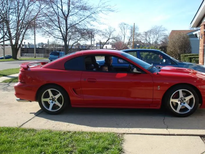

If you post a picture of the car I caould prolly tell you which springs they are by the ride height. :nice:
Hope this works.

nice car,I see a good deal at a.m. on eibach pro-damper reduced to 450.00
She needs some tires next though,probably in july I will get the suspension upgrade and possibly a lower control arm.trying to slowly build her up for a vortech s.c. thanks for looking.now Its time to start saving the cash:D
