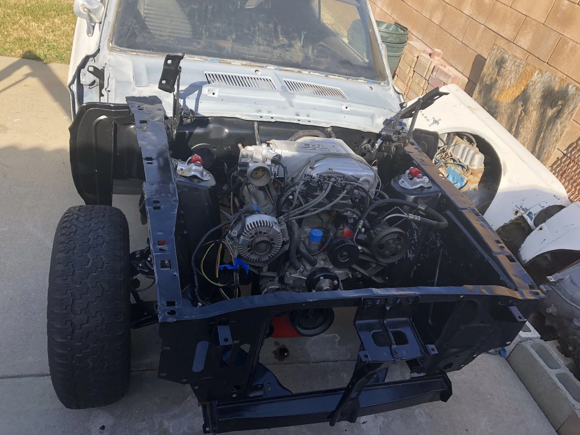

I'm actually doing almost the same swap. I have 97 explorer 5.0 with AODE into 67 mustang. I did a lot of research about modifying the explorer existing wiring harness to work in 67 mustang. I found a forum about a swapping explorer into a bronco which explained how to modify the harness . https://classicbroncos.com/forums/showthread.php?t=257251. Maybe this will help you decide if you really want to get into it.

I'm doing a similar swap now, but mine is from a 90 mustang. I got a wrecked 90 and got the engine, ecm, and the complete wiring harness. I mounted the ecm on the right kick panel and had to cut a large oval opening in the firewall for the harness to pass thru. It comes out under the fender and turns to go thru the inner fender to the engine compartment. I also bought a wiring schematic for the 90 mustang to make sure I got everything wired right.I'm not done yet so I can't guarantee it's going to work, but if everything is connected the way it was there is no reason why it won't. Yours may be a bit more complicated because that transmission is computer controled.

this is exactly how my mechanic did mine. my computer is also under the passenger side kick panel, One thing we found was that the ECM needs to have a code light. So my guy wired up a small light underneath the radio dash. so if a code is thrown, itll light up. Hasnt ever so i guess we are good. He did mention the car wouldnt crank until he wired that up.
I think there was something else going on because the pre-OBD II (pre-'96) ECUs don't care if there's a check engine light (CEL) installed. It would be a bad idea to manufacture a car that is completely disabled by a burned-out light bulb behind the dash cluster. I doubt the OBDII '96-04 computers care either.
The CEL is useful to have, but I've never known its absence to disable a vehicle.
Did you get yours in? I am at the end of this swap now. It is running, I just need to work on some fine details.
