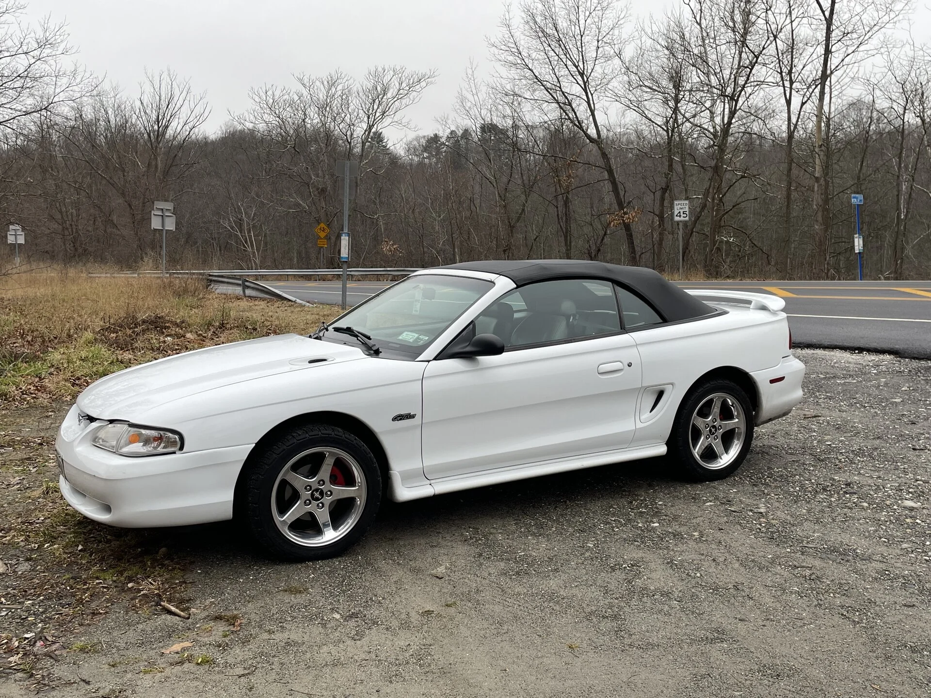

Hello all. Happy New Year. I have a 97 gt convertible with 93k miles on it. I have always had excessive what feels like body roll with this car. I have full length subframe connectors, new koni strt orange shocks and struts, STOCK Springs,stock front strut tower brace the triangle brace, stock k member brace, rear shock tower brace tack welded in, new bfg G force comp 2 tires, fresh alignment, 17x9 cobra rims and 245 tires around, new upper and lower control arms, stock replacement uppers and poly mm lowers, poly front sway bar end links and stock size front and rear sway bars. New steering shaft and rag joint, tie rods have no play, new ball joints. My problem is it seems like no matter what I do this car always seems like it has excessive amounts of body roll. Over bumps especially! Hitting a bump while turning sometimes feels very sketchy. The only things I have not replaced are the springs and front control arms. I really do not want to lower the car because it already feels stiff with the stock springs and koni shocks. Plus the Pypes h pipe will come very close to scraping everything is I lower it. To me Lowering it will just intensify the feeling that the car is going to self destruct. I had a lowered 03 and hated it. That car also felt like it was going to self destruct over bumps with frp b springs and orange koni shocks. Anyway is there anything else to check that will make the car have crazy body roll? Are there body bushings that the shell sits on? It just feels like no matter what I do this thing always feels like a boat on the ocean. Tramlines also. So add the traimlining and loose feeling over bumps and you know how that feels. I know it’s a convertible and you don’t not have the top structure for support but everyone I ask that has a stang very says theirs feels fine. I do not get and I don’t want to sell the car just yet. Please any help for me? Thank you!

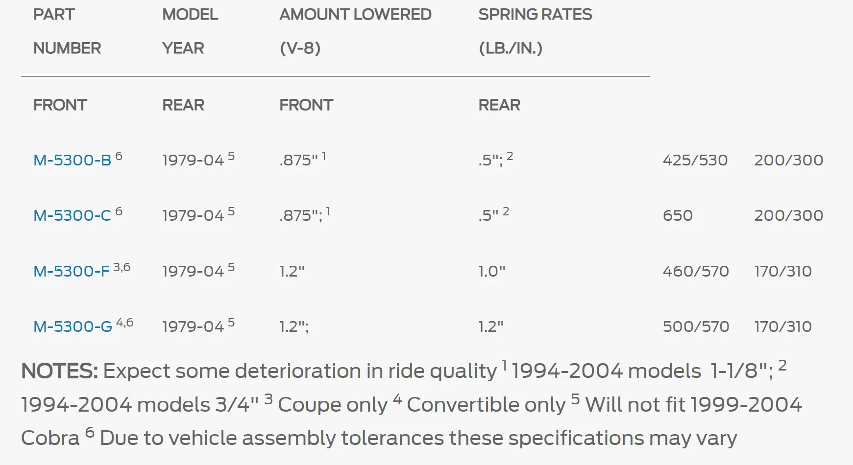

I have the Ford M-5300-C springs, and I get the issues of lowered as far as clearance goes. Of course lowering, in and of itself, does not make the car stiffer. For the "C" springs, the part I feel is the 650# front spring rate. I think I needed the stiffness in the back, and, except for the occasional speed bump, I don't mind the lowering. The car does handle better. You might consider the "B" springs. I believe the rears are a little stiffer than GT springs (same as the "C"), but the fronts are the stock GT rate. I'm thinking of swapping to them to get my wife back in my car. :).

Here are some specs for 1979 - 2004 Mustang spring rates for the factory springs. I hope some of this helps. I do think your answer will be sway bars.

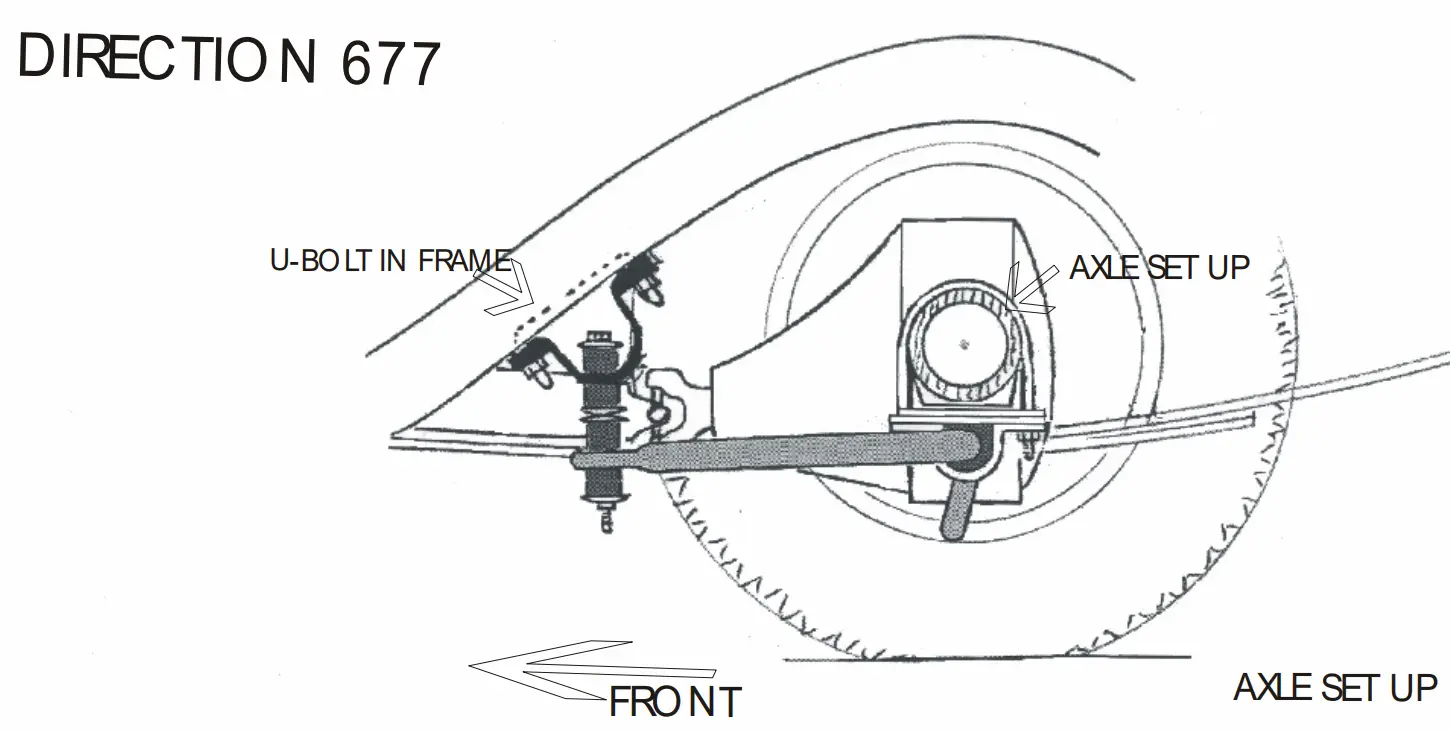

This picture is a bit misleading (we don't have leaf springs), but it locates the bar appropriately.
So, under the axle, not between the control arms like the factory bar.

Just clarifying: I have installed the sr performance sway bars from Americn muscle. I’ve also added aluminum rack bushings and the car now rides amazing. I’m very happy with the outcome. I forgot I even posted this. The car has been riding great lately.
