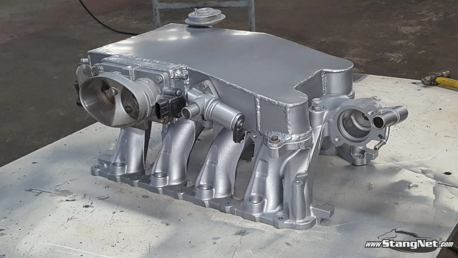

Just bad ass dd
  • Media owner Porkchop84
  • Date added Jan 22, 2018
Clears the Cervini ram air style hood just fine with only 1/2" k frame spacers on the stock k member. Custom sheet metal upper with the Navi lower half.
Where there's a will there's a way.
Haven't got tuned or dyno yet. Numbers are?
Fresh build .040 over pistons.
.020 shaved from the heads, polished and ported.........stock Navi cams.........

Custom
Built by yours truly Navi lower half......custom sheet metal upper......Navi twin blade throttle...

Why did you leave the EGR mount on the intake? Take that off!
Reactions: Porkchop84

#11
  • Jan 24, 2018
  • #11
Wasn't sure of I'd need it or not. So I mounted it.
Rather have it and not need it than need it and not have it.
My tuner guy said to leave it on as well.

I've got upgrade to bigger injectors and a better MAF before I able to tune. I'm probably a month out from the dump.

#13
  • Jan 26, 2018
  • #13
thats odd. Every tuner I know turns that EGR crap off in the ECU.

#14
  • Jan 27, 2018
  • #14
Tuningbyjames.com
He's works out of Brothers Performance in Deland Fl
