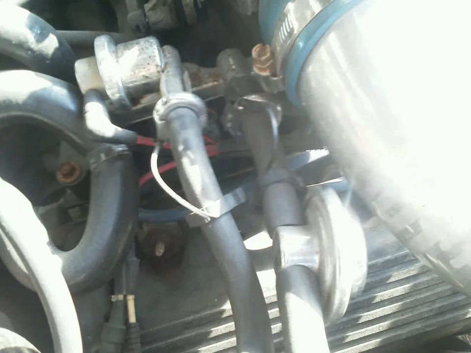

If its return use the 94-97 pump...if not then grab a walbero pump...they just came out with a direct fit pump for the 98-04 return style cars...check the build date on your car...if its early 98 then you have a lot of choices...late 98 is the returnless style...I can't tell without seeing a pic though but it sounds like you need the 94-97 pump

Damn tapatalk app, will get a new picture after work.

984.65spd:
Thanks for the picture. It is exactly like mine so your car has a return style system. "vitoGT" gave some very helpful info about the SVT Focus pump: plop it in (and you can use your old basket). Thanks, vitoGT!
