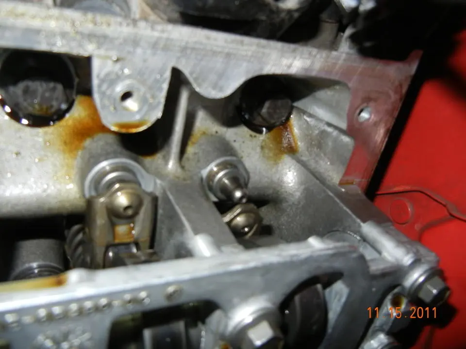

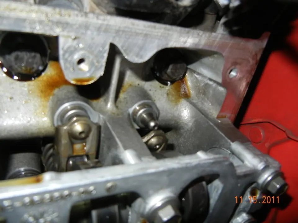

Got the valve cover off, had to remove both the throttle linkage and clutch cable, then the cover came right off.
Sure enough, the finger follower was laying in the head. As I sat there staring at it, I think I can recall exactly when it came out. I had just changed the oil and went to start the car, there was a strange sort of metallic 'ding-ding' sound, which at the time I couldn't place as I had never heard anything like it. That must have been the follower falling out of place.
It appears that the valvetrain is oiled via the lifter or lash cap. Is there also oil pressure on this? I'm thinking that when I changed the oil, it must have lost pressure and allowed the follower to slip out.
I'm thinking that if I apply air pressure via my compression checker, if a valve is stuck open, I should hear it, either out the exhaust or intake, right?
About slipping it back in... I can get it most of the way:
How do I get it that last little bit? I'm soooo tempted to loosed the cam girdle to gain a bit of room as slip it in - would this be a bad idea?
Thanks!
Thanks!

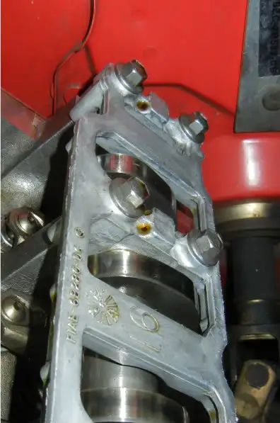

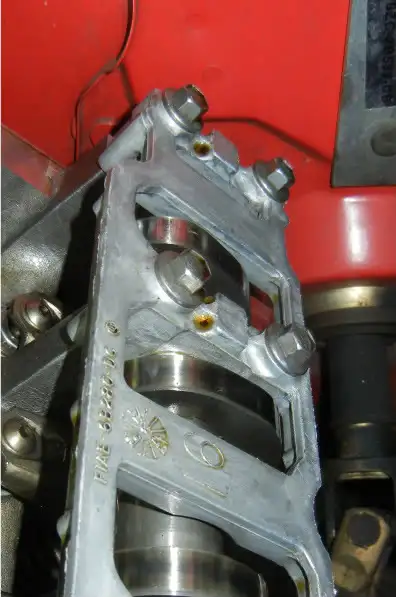

DO NOT LOOSEN THE CAM HOLDER! Take a pry bar and compress the valve spring a little so the rocker arm will pull up a little more allowing u to get the lash adjuster back in.
Take a Philips ("star") head screwdriver and push down on the dimple/hole in the lifter plunger to try to compress it. Right now it's at full extension because there was no counter to engine oil pressure. If you do that you should be able to slip the follower back in.
I agree: Don't touch the cam cap bolts. Try compressing the lifter or the valve spring a bit if that fails.
And yes, forcing compressed air into the cylinder will tell you which valve is open. Looking at the pic and the valve involved I believe you're going to find it's the intake on that cylinder (someone correct me if I'm wrong...)
If you have zero compression and you suspect a valve is stuck open you have a larger problem. If you have been running this car with a valve stuck open, it is more than likely that the valve has come into contact with the piston. You could have a whole in the piston now. Now is the time for that bore-scope.
Draining the oil or even loosing oil pressure while running will not cause the follower to pop loose. The follower popped off on its own... it WILL pop off again unless you fix the problem. Keep digging. Look at the valve springs to make sure they are fine. Could also be a sunken valve seat, bent valve, bad lifter, ect ect.

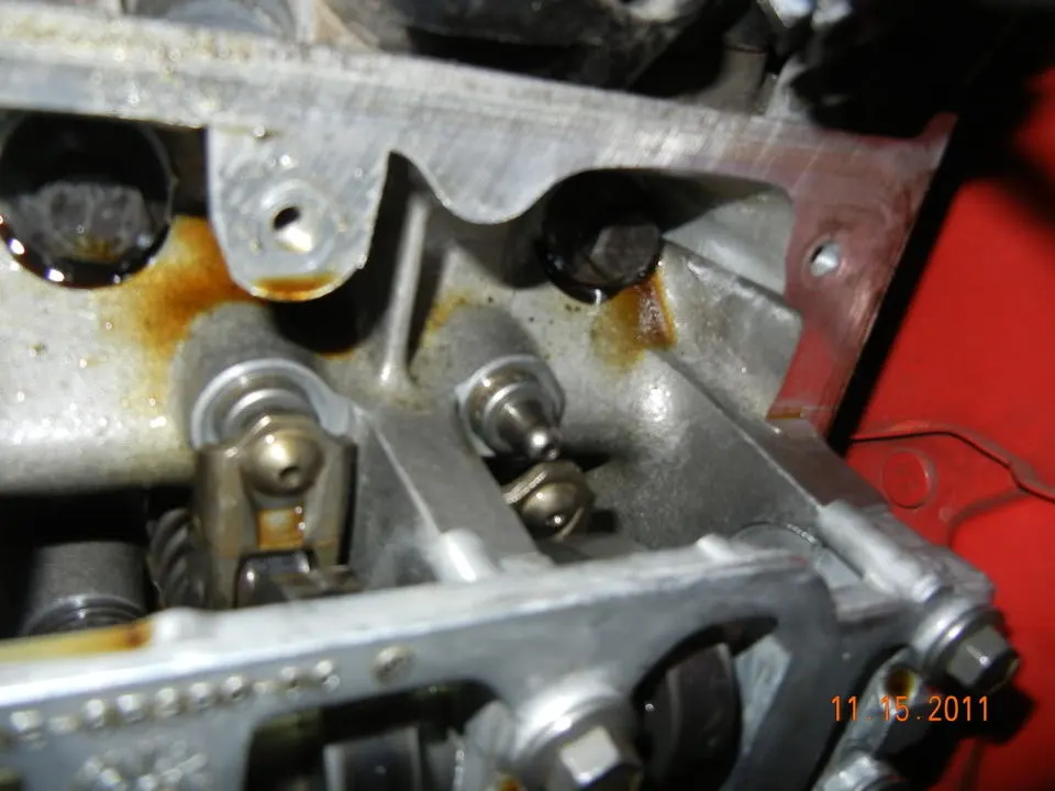

Well, thought I'd update everyone with todays progress. Although the ending is as strange as the beginning...
I was able to get the follower back in place via 2 screwdrivers, one the upper side of the cam pushing down in it, and the handle on the other end on top of the spring. I don't have a leak down tester, so I fabbed up a pressure tester using the end of my compression tester. I turned the engine over to get both the lobes of #8 on the base circle:
(sorry about the photo, I rotated and cropped it on Photobucket, but it's still showing the original)
This was at least as close as I could get. I should have paid attention to the warnings to not keep my hand on the ratchet, while letting air into the cylinder. Of course, the engine spun over and slammed my arm into the radiator tank. Oh well, some lessons you have to learn over and over again. I now have a nice bruise on the inside of my left arm to remind to me pay attention...
Now, the bad news, I opened the valve and let air in and it all escaped! I couldn't pinpoint exactly where the air was going, it wasn't the exhaust, I don't think it was the intake, so that leaves the crankcase, right?
Anyways, I put everything back together and it fired right up. I could tell instantly that once again it was firing on all eight cylinders! Nice idle, no more smoke and back to even temps at the exhaust tips! Woo-hoo!
So, I took it for a drive. My heart sank through the floorboards as I took off down the street and it had a definite miss. Power was back, but still it had a miss. Thinking that this must mean a bent valve, I almost turned around at the end of my street. But, I said, F it, and kept driving. Somewhere between 1-2 miles, the miss cleared up. I kept driving - it now runs fine, just like it's supposed to. :D
I guess the miss could have been a bit of carbon on one of the valve seats? Dunno, but I'm happy, to say the least. It appears all my issues have been resolved and I consider myself very fortunate to have dodged bigger issues.
Thanks Stangnet! I couldn't have done it without all you awesome guys!
