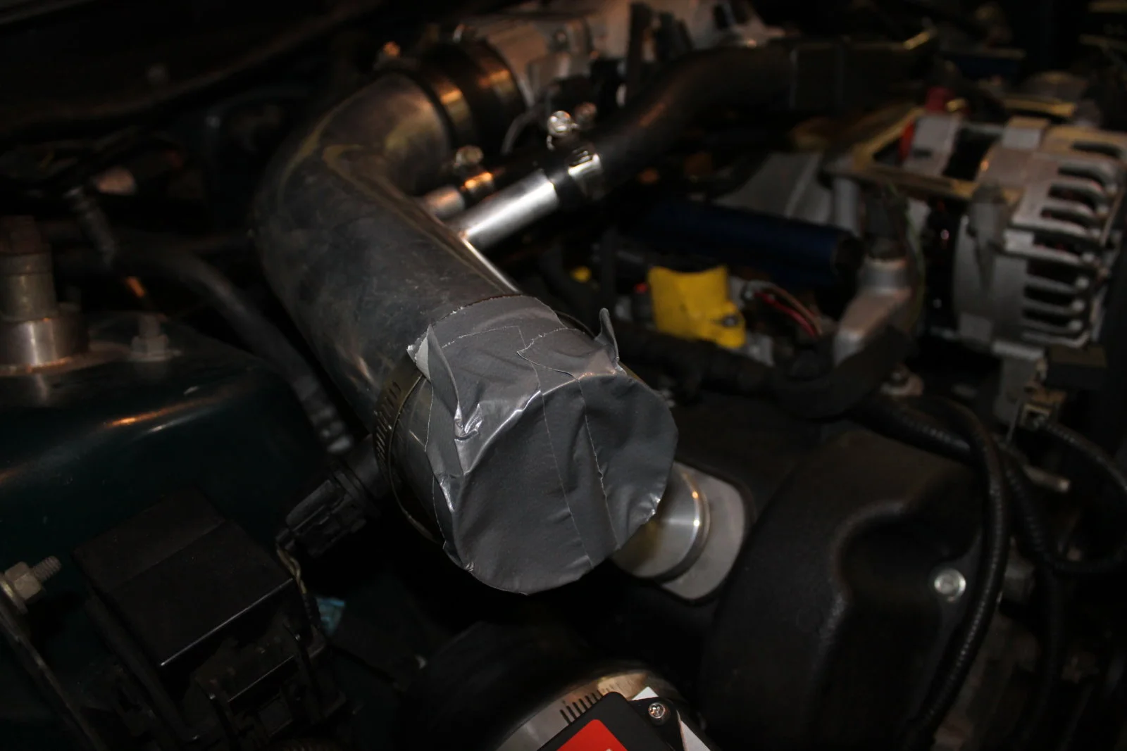

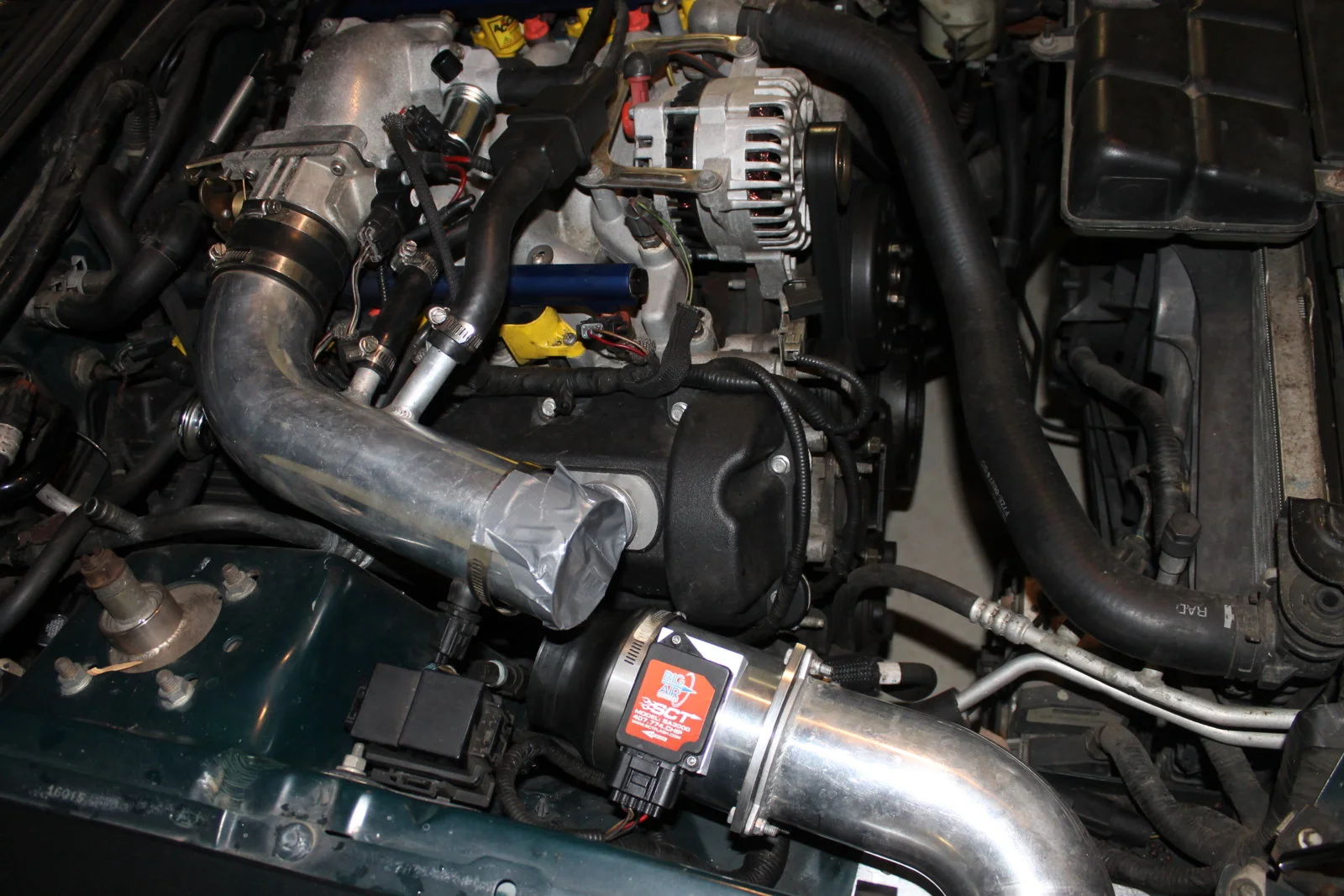

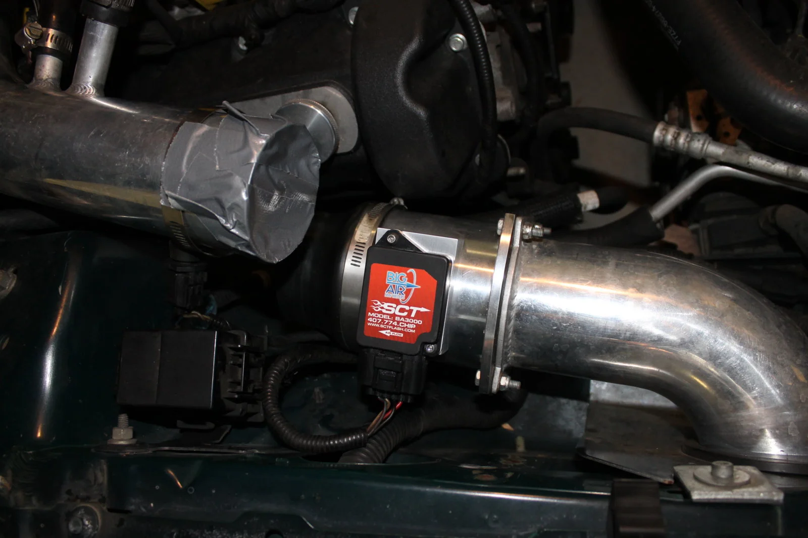

So I have a problem. I have been troubleshooting a start idle stall issue. Today I decided to block off my air intake with duct tape while my MAF was connected and she starts up and idles perfectly. Possible vacuum leak??? She must be getting air from somewhere but can't locate it. But when I connect the cold air intake back up she starts then immediately dies and wont run unless I hold the gas peddle down. Can the MAF have incorrect settings so when its metering the air its throwing it out of loop. I'll post a picture. I just replaced the maf because it was doing the same thing before and thinking maybe the maf went bad was the issue. So replacing it isn't the fix. I'm now stuck to thinking its the IAC causing the headache.

The fact that the motor runs at all when the intake is blocks "proves" there's a vacuum leak somewhere. Consider a smoke test.
Regarding the MAF. If you want to know then graph the MAF flow. But does it seem reasonable to blame the MAF when there is proof that a large amount of un-metered air is entering someone else.

IMO you may be over thinking this.
The MAF is installed in such a location that the MAF is able to meter all of the air that the motor is using. In this case there's a motor that continues to run even when the intake air tube is TOTALLY blocked. Just like a human being chocked at the neck, there is no way this motor should idle. But it does! The vacuum leak must be HUGE.

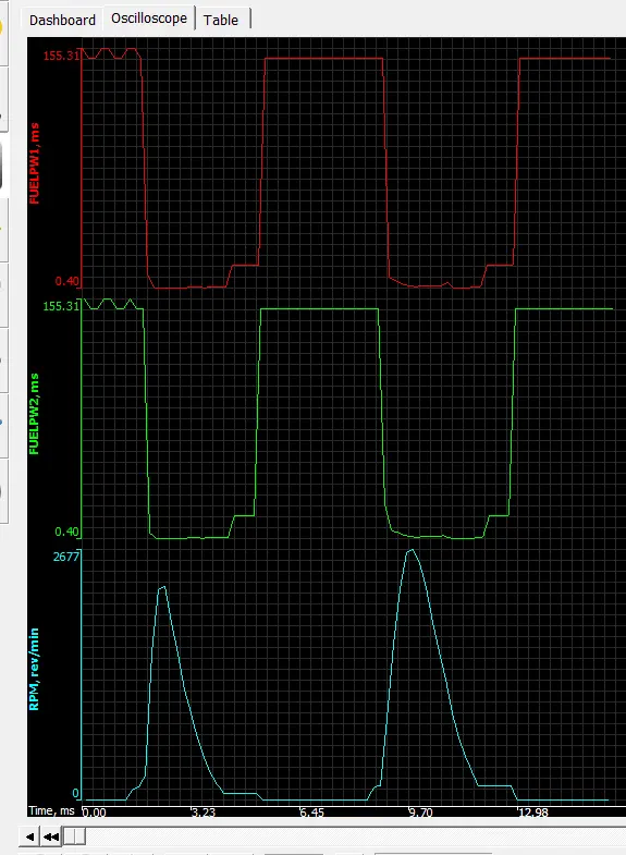

The tune for my maf sensor was incorrect. This can happen after upgrading to a different maf sensor which in my case that's exactly what I did. Or by drastically changing the airflow or fuel system, which would require a new tune. Remember maf sensors are used for measuring the amount of air coming in to the intake. My tune got corrupted in my case and I didn't realize this until after replacing my IAC, TPS, and maf sensor. I went through weeks of testing each individual piece according to my ford mustang manual thinking I also had an electrical issue. If I had only downloaded the software earlier and reviewed the maf airflow to voltage and a few other graphs I would have had this problem solved much earlier without throwing money at it. Ill post some pictures of my before and after using the software to diagnose my maf sensor issue. It just needed calibrated which any tuner can do that owns the software.
Below is a picture before the tune. Notice how much distortion there was on the bank 1 and 2 fuel trims. They were super high and super low. Once I posted this on this forum @a91what was able to tell me my tune was off. All for 30 bucks I solved my problem and knew what I needed to do to fix it.
The actual forum of my problem and how I resolved the start and stall issue can be seen below.
