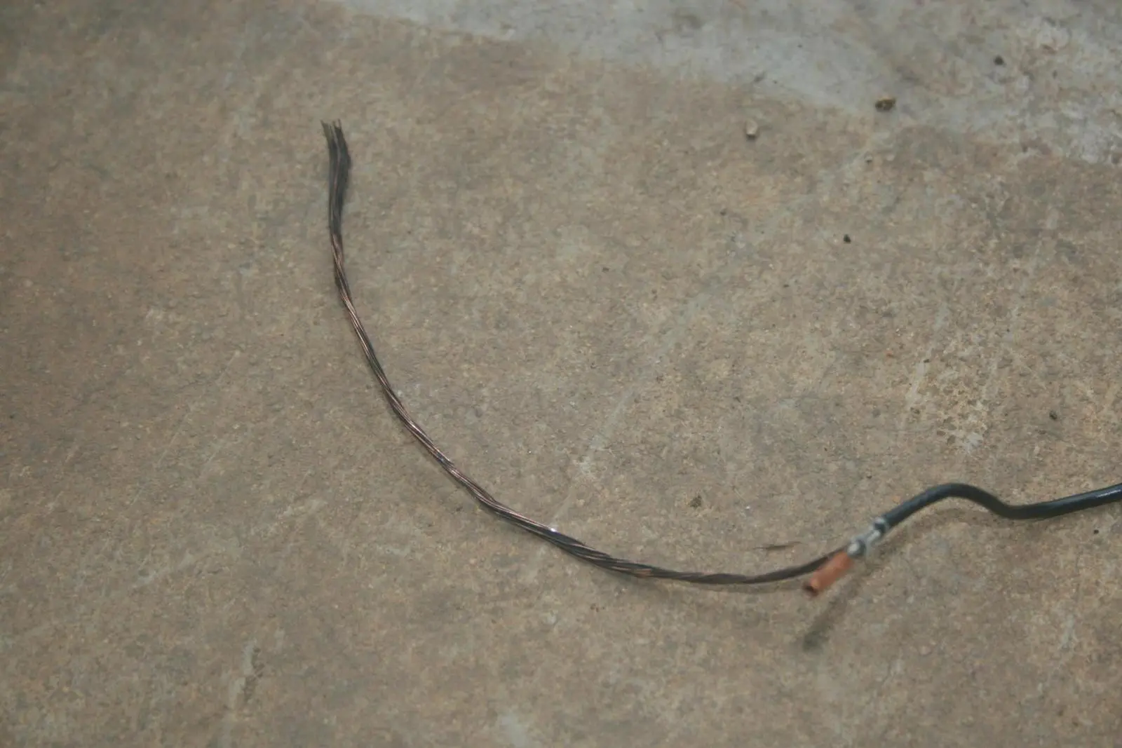

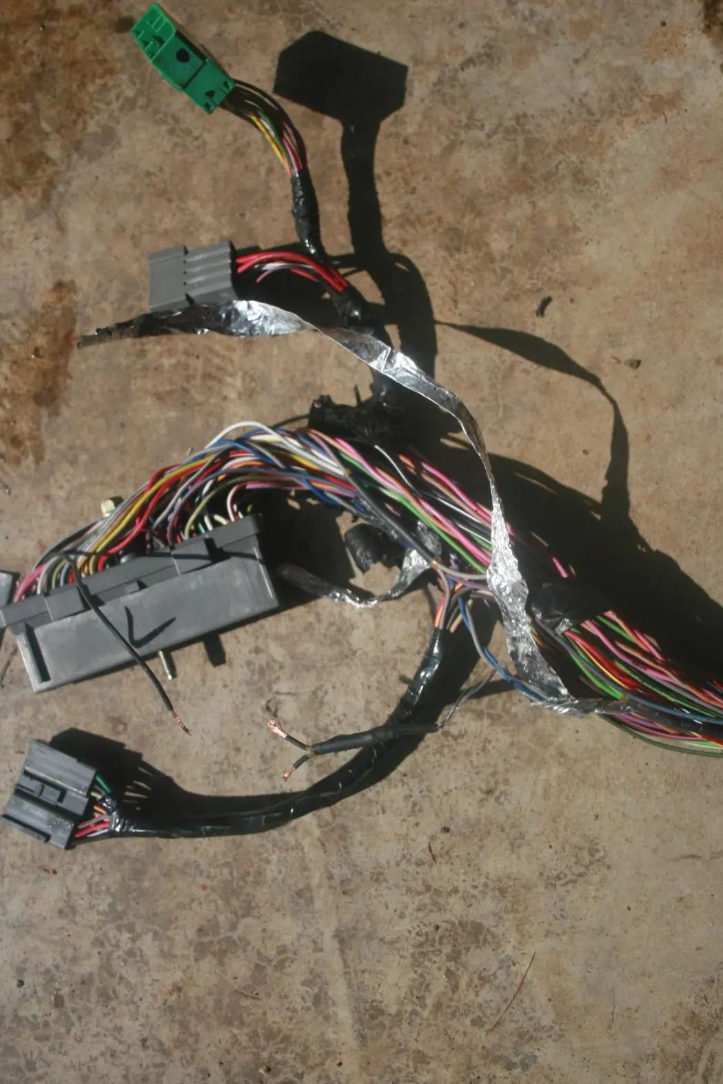

I havent had time yet today to do much but I did take some pics I hope will show up. In the first one you see on a concrete floor, the removed and now unused 99 GT main computer harness wiring that was behind the passenger footwell. You will see three shiny 11 year old bare ends of copper wires. These are the ground, the two connected to the exposed/bare wire wrapped in silver "metallic type tape" are: one to the computer harness which is the third wire you see closest to the big plug which was accidentally cut, the other is the one which goes to the green bolt to ground the wire to the body behind the footwell. Which is what you now see in the second pic. The footwell with the 03 Mach 1 wiring. You can see at the bottom of the second pic the green bolt I refer to which is between the red wires and black covered wire loom. The Mach ran perfectly without this green bolt grounding the end of the wire. It was bare and unconnected in the Mach 1. I used the end of my GT wiring as it had the proper sized eyehole for the green bolt and shrunk wrapped them together. AFTER this problem started I then ran the GREEN wire you see going from the corner of computer chassis to the same green bolt. No change in how it ran. This is maybe because as you can see on the newer 03 wiring, the end of the ground wire seems to be corroded or something. I cut as close as I felt comfortable without getting into the elec tape of the wire loom trying to find shiny copper strands but there were none. Could this be my problem as it is the only ground wire between that point and the ground by the radiator on the passenger side? I disconnected the ground in the pic to show the difference in color of wire mustang fix pics 012.webp
The foil is the ground shield for selected sensors. It is there to reduce stay electrical signals from being introduced. Unlikely this is your problem. In any case, your repair should be effective.
Note, the PCM has multiple ground wires connecting to chassis ground.
IMO, you should diagnose this problem as a no-start problem. Think FAST. Fuel, Air, Spark, Timing.
Ok I added a much closer pic in my garage of the bad wire. Couldnt add here, said I used too much memory. I will fix it tomorrow as I feel I will probably have to remove the loom from the fender well to trace it all the way back to where I can get a perfect connection. This is also the body ground for the big square bolted plug that comes from the engine into the tight corner near the hood hinge on the passenger side, also, that is the only ground for the entire wire loom behind the pass fender plastic which passes thru hole into front eng area and includes the MAF, AC plug and cooling fan plug. What do you think would cause this problem as I dont want it to come back. I will also just go buy a MAF and stick it on since you feel I have most likely damaged it. I did spray quite a bit into it. :o) Oh well, the price of an education..I will post back tomorrow with results. Thank you Burns I will try your suggestions as well, they will be helpful if this ground is not the problem

I did everything to create a good ground. All five grounds, frame to eng mt(driver side), two by battery, one by radiator and the one at passenger footwell were methidically cleaned , body surface to shiny metal and BOTH sides of the "eyelet" at end of wire and the base of the green bolt. Still same probs though with a short somwhere im sure. I cannot open the windows, the power seat only goes backwards. When I try to open window,move seat everything goes dim and the courtesy light will go off. Understand I can EASILY crank and crank, sometimes it wont start, with the headlights on, and then crank again to start. No battery charger has been put on the car to get it to start except at the dealer when they drained battery doing the brake flush 4 times. The battery has plenty of juice and the charging system seems ok (I will test tomorrow) because I have started the car at least 20 times since Thursday. mustang fix pics 010.webp This is the ground wire to the computer. It was uncut in the pic showing it in the footwell. When I took the whole loom out thru the fender to fix the ground wire I could see was bad, I decided to cut this one and see how bad it was. Then I just took it out of the large plug that goes into computer and cut all the wire out of the insulation and as you can see it is black all the way to the pin. I replaced it with the 99 GT pin and put all together again and same problem. I didnt get MAF but it wouldnt be causing the dimming of everything when I try to open window or power seat. Power locks work fine though. It did run fine for about 30 seconds. The odo brightened up and everything (window,seat, snap accellerator and no bogging) worked fine. I got a lil woody thinking it was all good, then right back to the BS. Could this corrosion have worked its way into the computer and caused an intermittent ground issue within the computer?

I really feel that you have a couple of different problems that may or may not be related. The foil covering the DB and GY wires is the shield for the crank shaft position sensor. If you look at the wiring diagrams you will note that the foil is only grounded on one side. It does not carry a signal. Even if it is not connected, the sensor will still work (for the most part).
