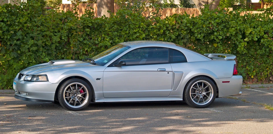

I cant add much to the above suggestions but I have everything in my car that has been discussed. Blistein struts/shocks, F/L subframes, isolators, h&r springs, C/C plates, lower adjustable control arms (perfect for getting the rear end height where you want!) . I also did the panhard bar and torque arm so I could remove the quad shocks. I redid the rear end because the gear whine was absolutely awful and I upgraded the differential and upgraded the 28 splines to 31. So I know exactly where you are with things. This is my advice...
1) Do not ever cut a spring that is just ghetto as hell. The isolator just stops metal on metal grinding. Electrical tape is going to do jack s*** to protect you.
2) Because there is no real adjustability in the front, unlike the rear adjustable control arms, you going to have to get coil overs to get that perfect stance. I would get them with a 300lb spring.
3) After all suspension work is said and done, get a alignment. why do all the work to not finish the job. Do it right the 1st time.
4) As for a rear end rebuild I got this.... http://www.latemodelrestoration.com...ine-Severe-Duty-Rear-Axle-Kit-5-Lug-373-Gears
you will have to buy new ABS rings and some open ended lug nuts if you dont want to cut the lugs down to size.
I have the exact same problem with my front just like you, I want to do a full k member swap but I just dont have the skills to do it myself, and the labor to pay to do it, is almost the same price as the kit.
fortunately a coilovers are cheap and easy enough to use on your stock arms and k-member. I am going to wait it out until I can do everything once.
here is a pic of my setup
View: http://imgur.com/a/f097Y
