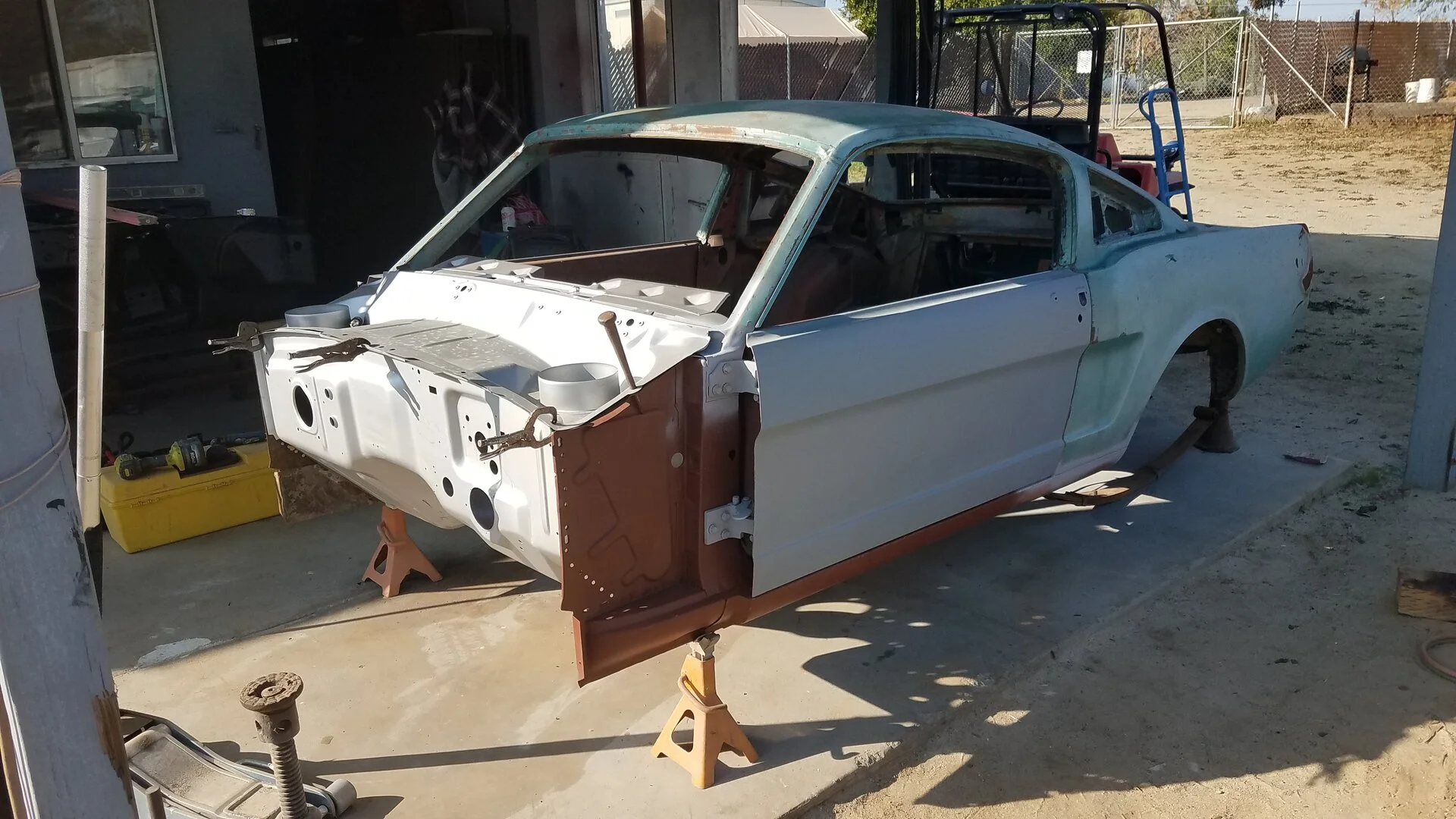

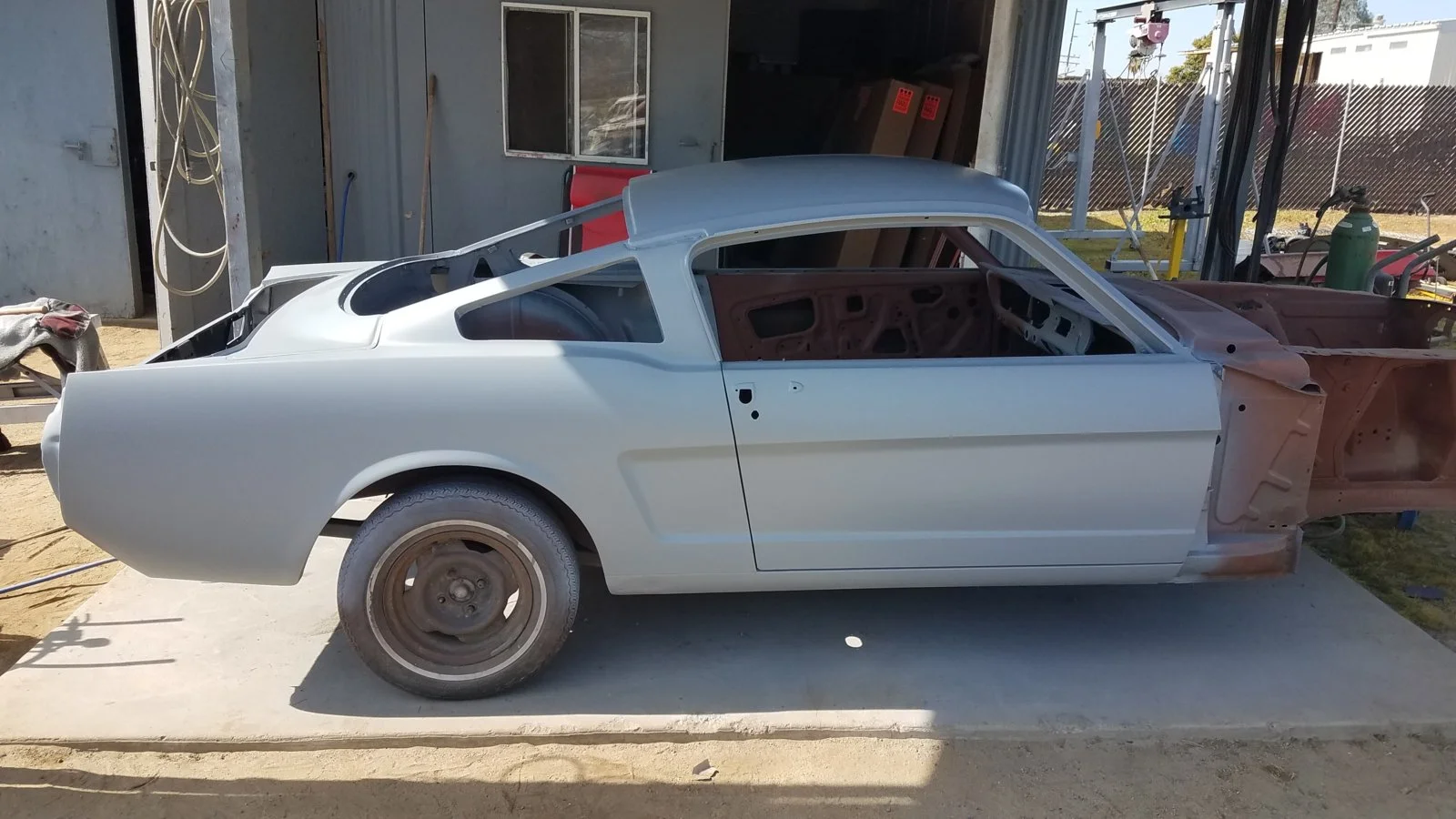

After selling my car collection two years ago ,i finally decided it was time for me to have a Mustang once again . This poor old 65 fast back had the front end knocked off several years ago when it was ran into a bridge pillar . The impact ripped the frame rails right through the floor taking out the cowl and the dash . Amazingly it didnt damage or twist anything else . I have already removed all the damaged areas,including the floor ,leveled it to check for twist and started buying parts .
It is a 289 2v 4 speed ,silver blue with blue and white pony interior ,had factory disk brakes San Jose car .
The plan is Saphire blue with white shelby stripes ,347 stroker and new 4 speed .
The parts have finally started coming in after about a month of waiting but i cant find a radiator support anywhere !

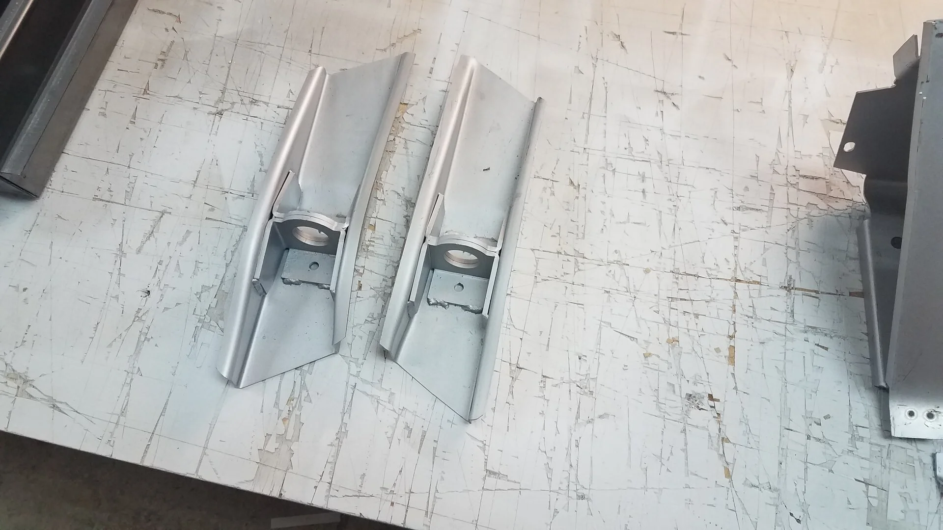

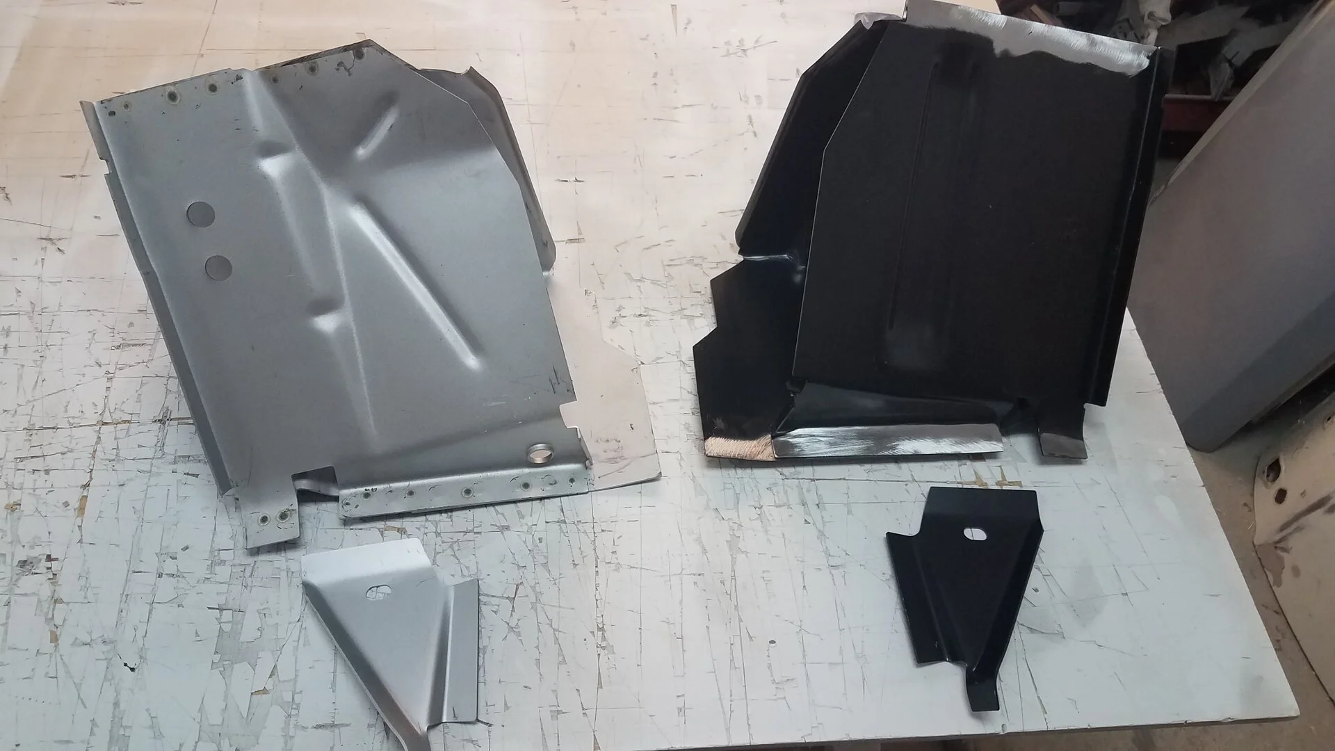

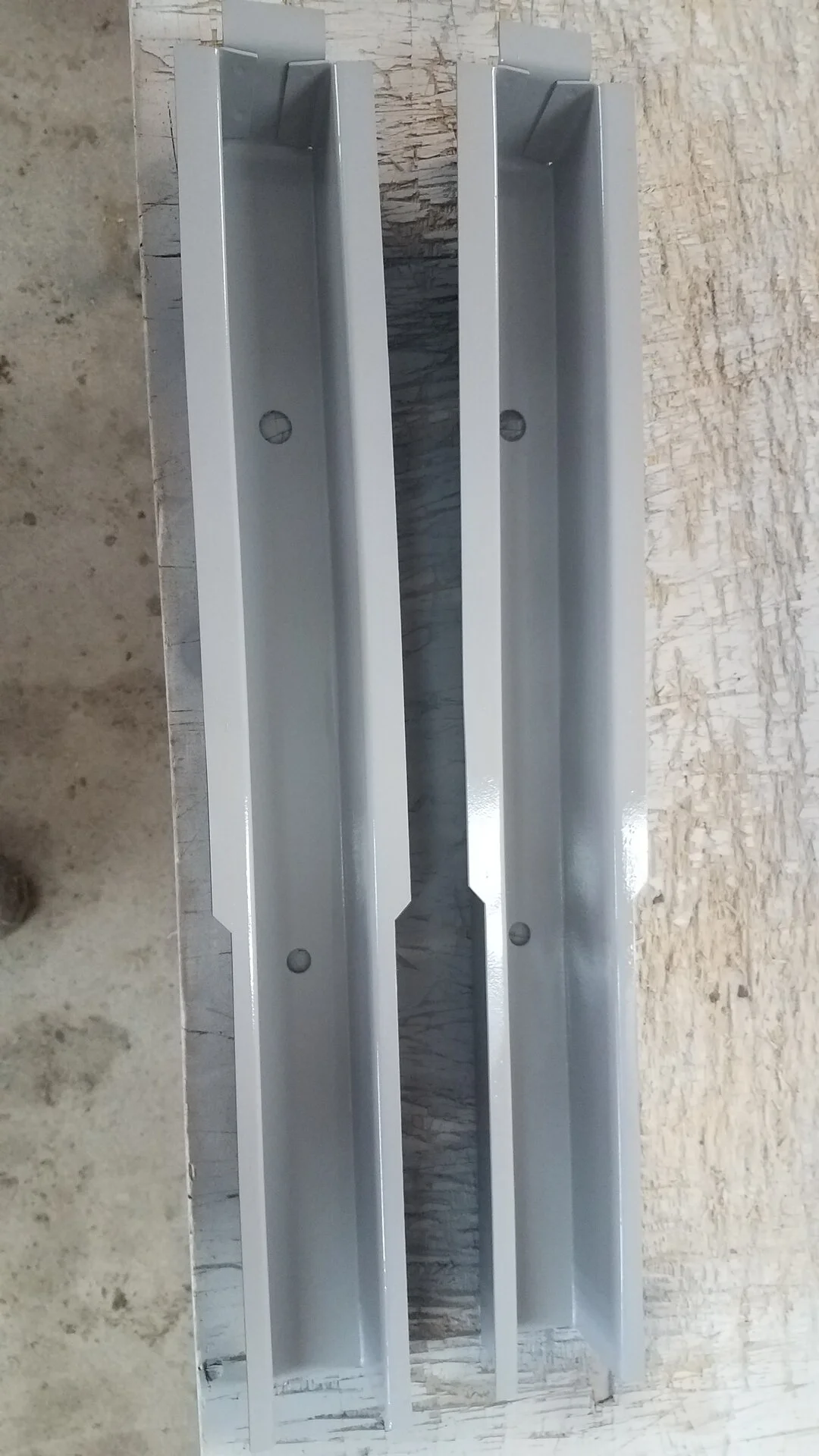

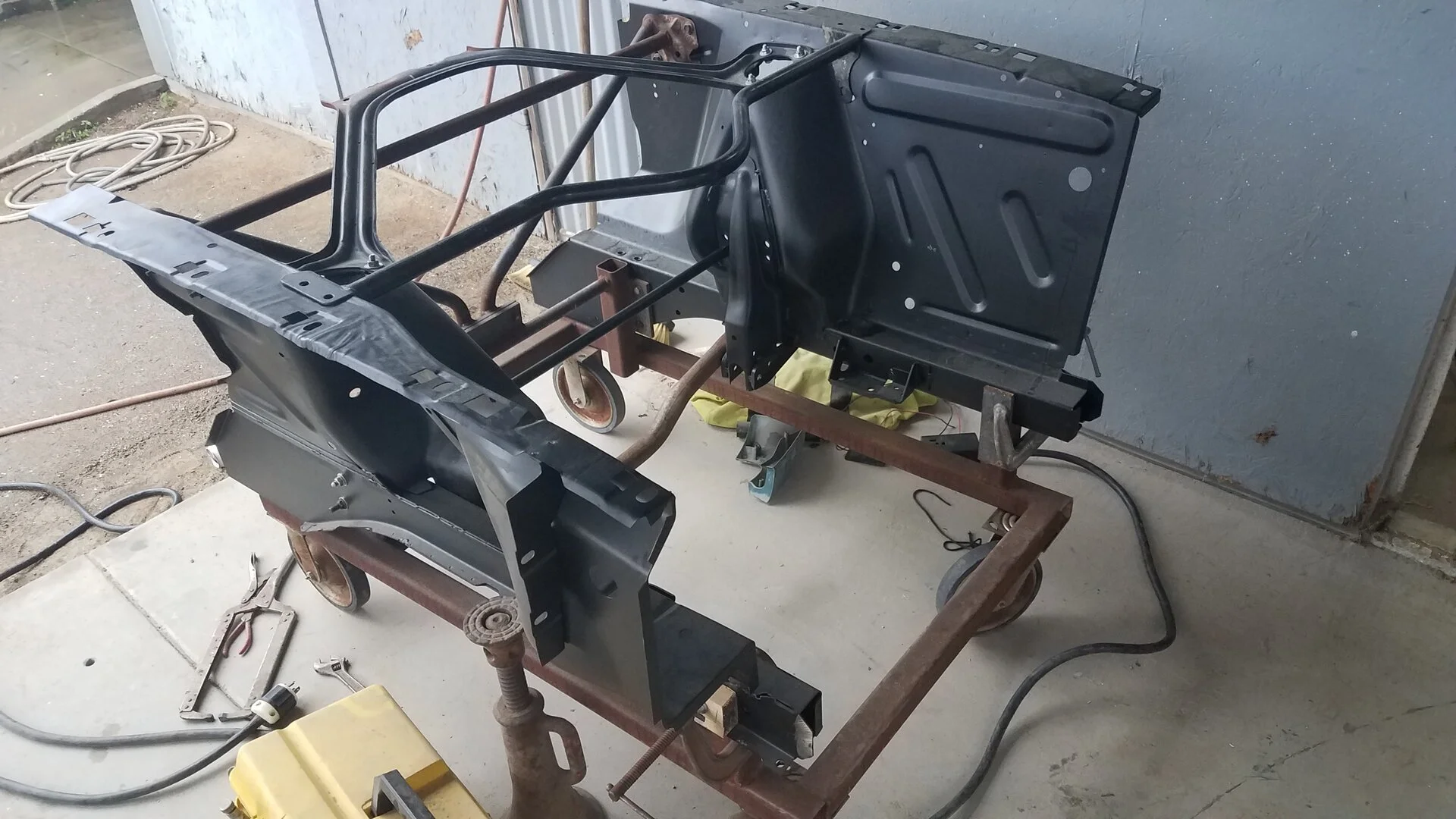

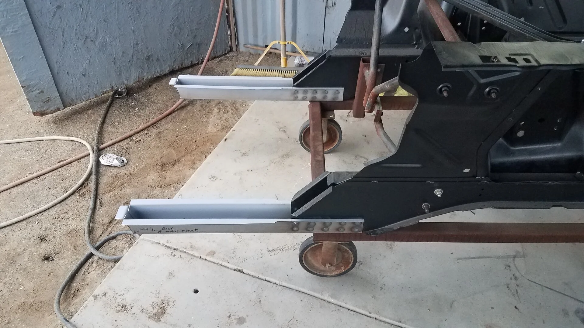

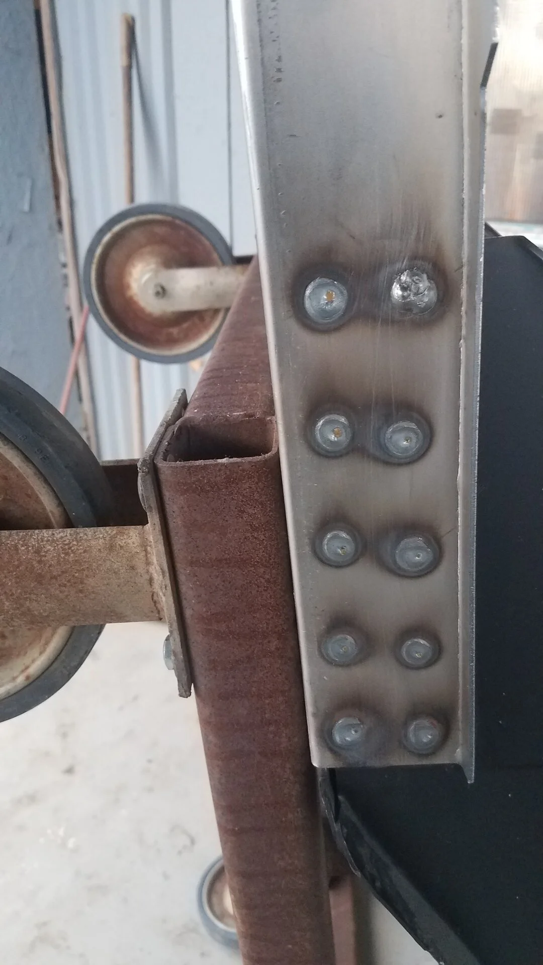

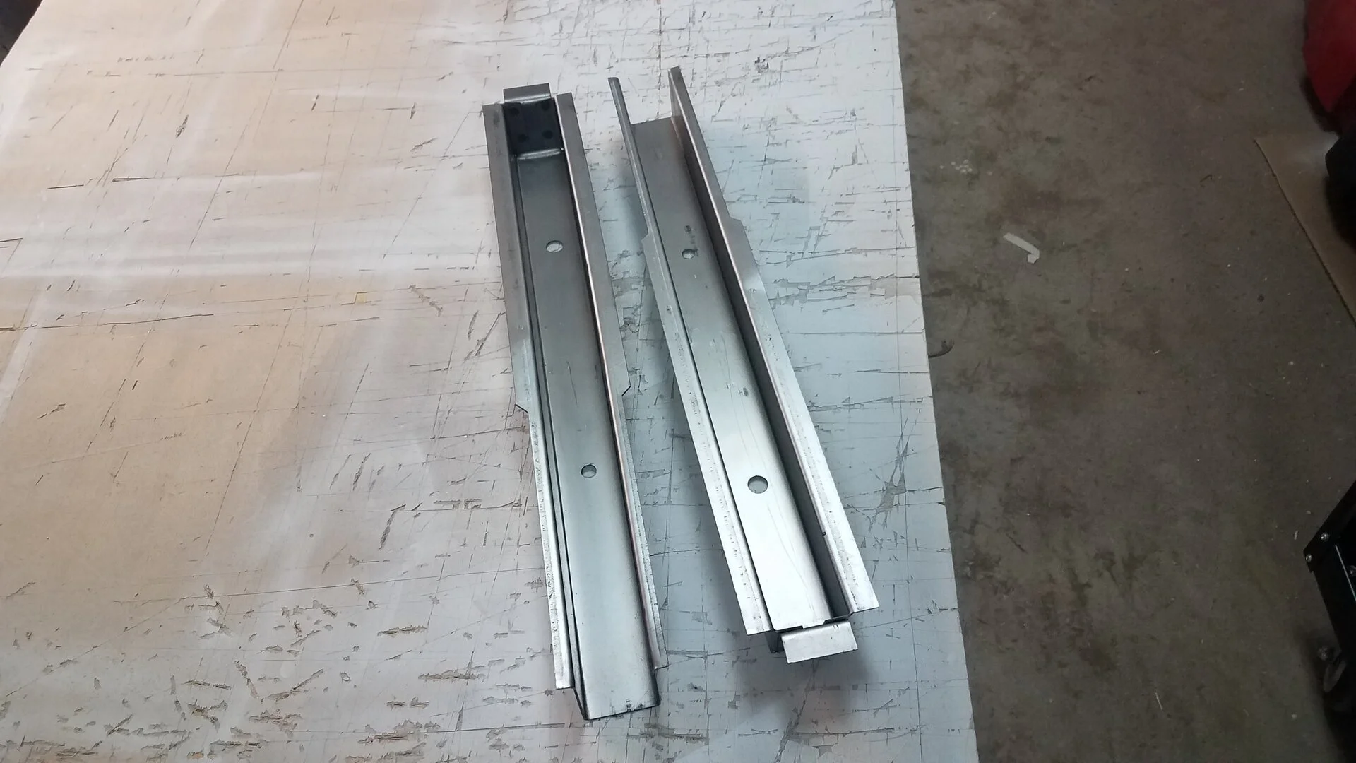

Most of my parts came in yesterday ,took a long time to get them but that seems to be normal everytime i order somthing . Torque boxes have been welded together ,the floor supports can be welded to the front frame rails now and the front clip will will be complete with torque boxes and fire wall welded in place ,it will slide in as a complete clip .

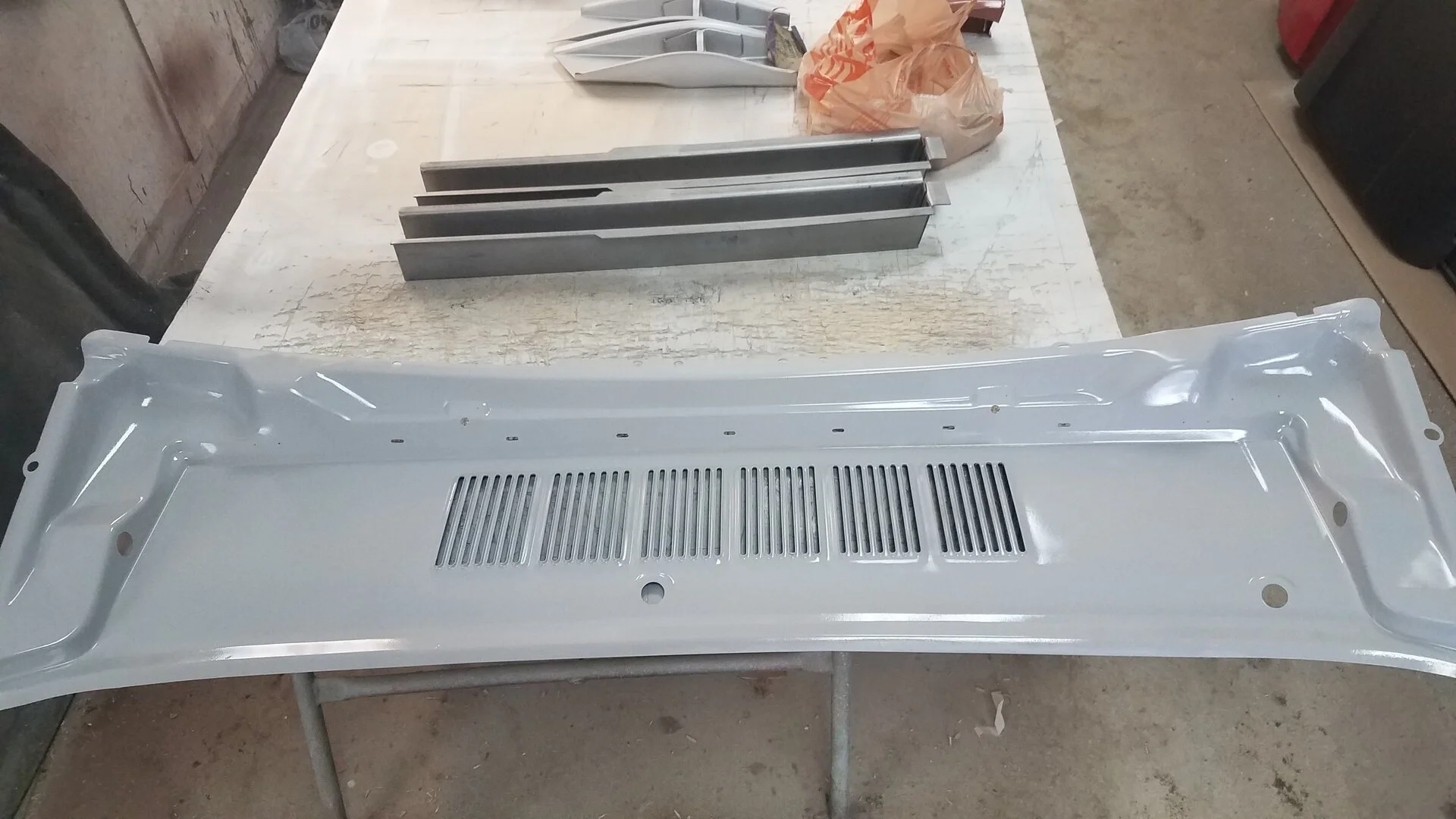

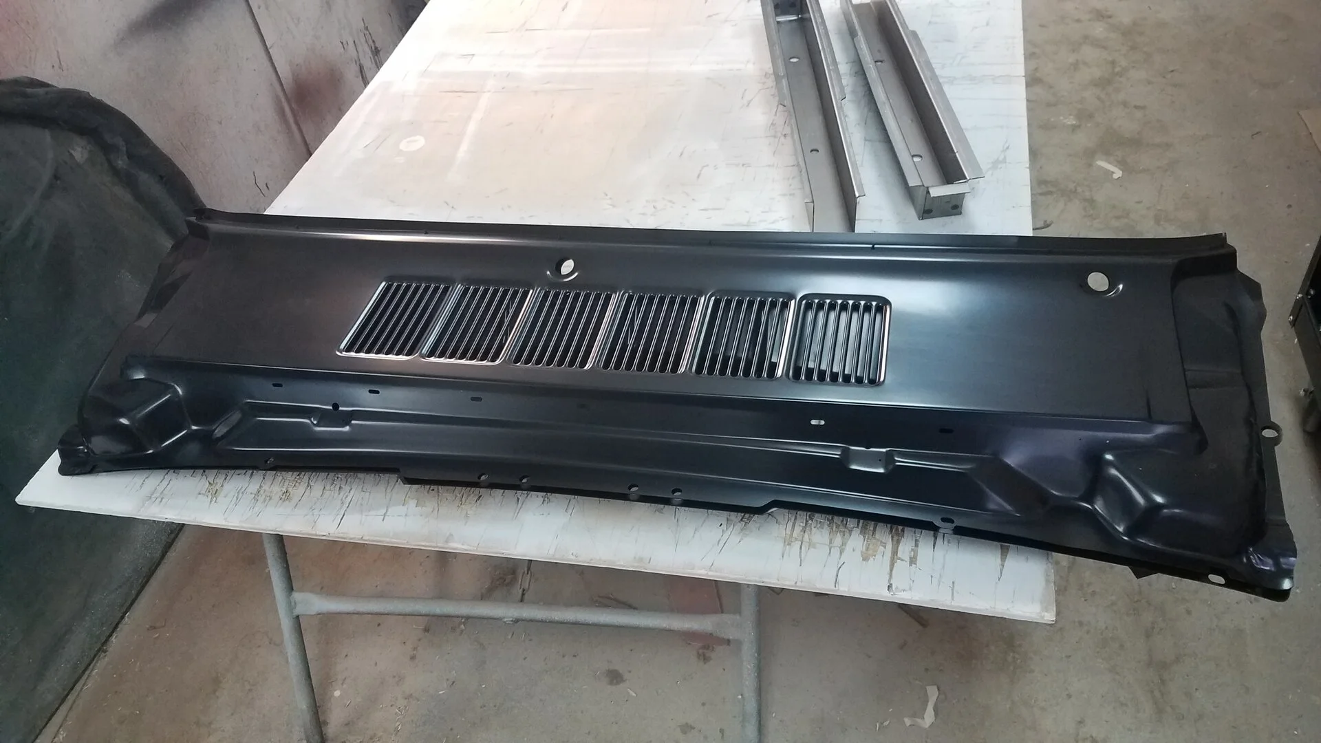

The cowl is really nice ,not a mark on it ,i will sand the inside and epoxy prime before the top and bottom is welded together ,it will be welded in place completed.
I had one very nice 65 front fender but i had to buy a Dynacorn passenger side .

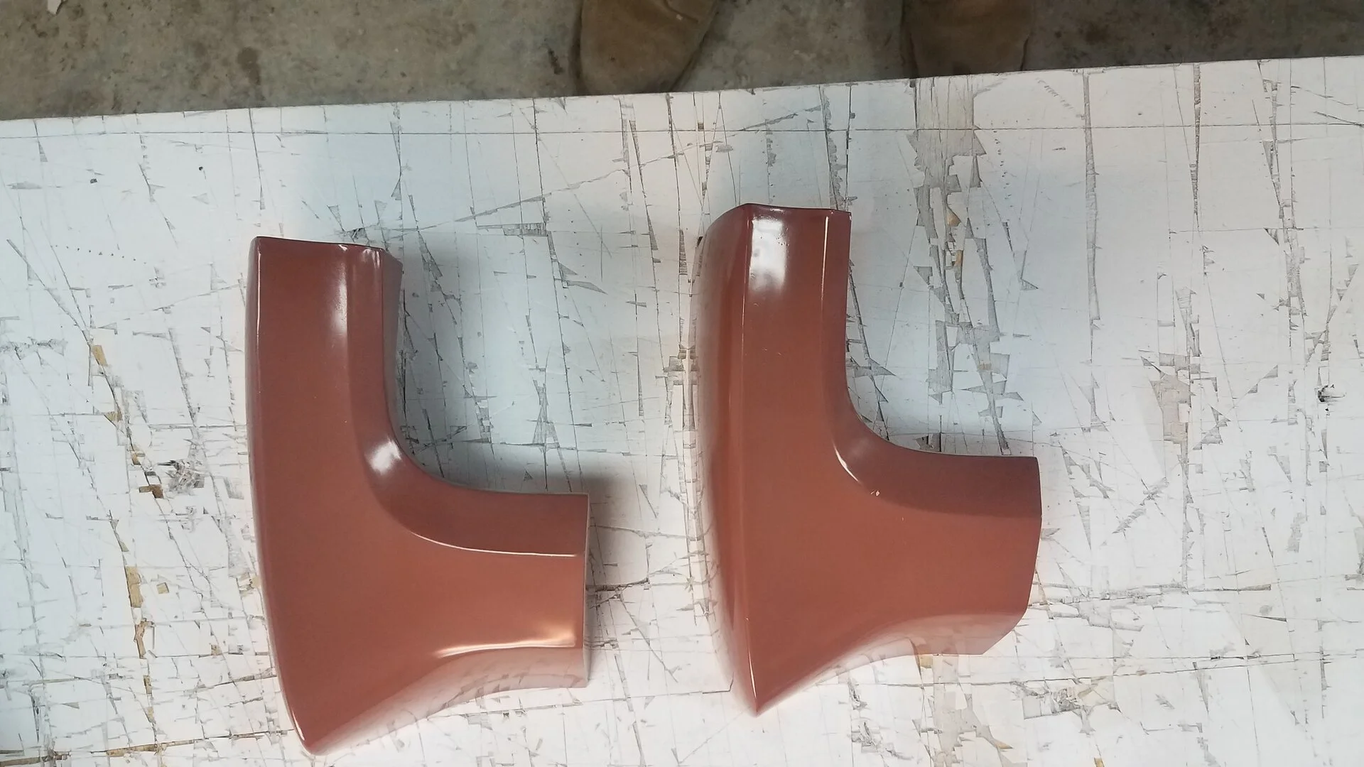

Does any one notice something wrong with the new end caps i bought ? And by the way the fit on these is just about perfect !

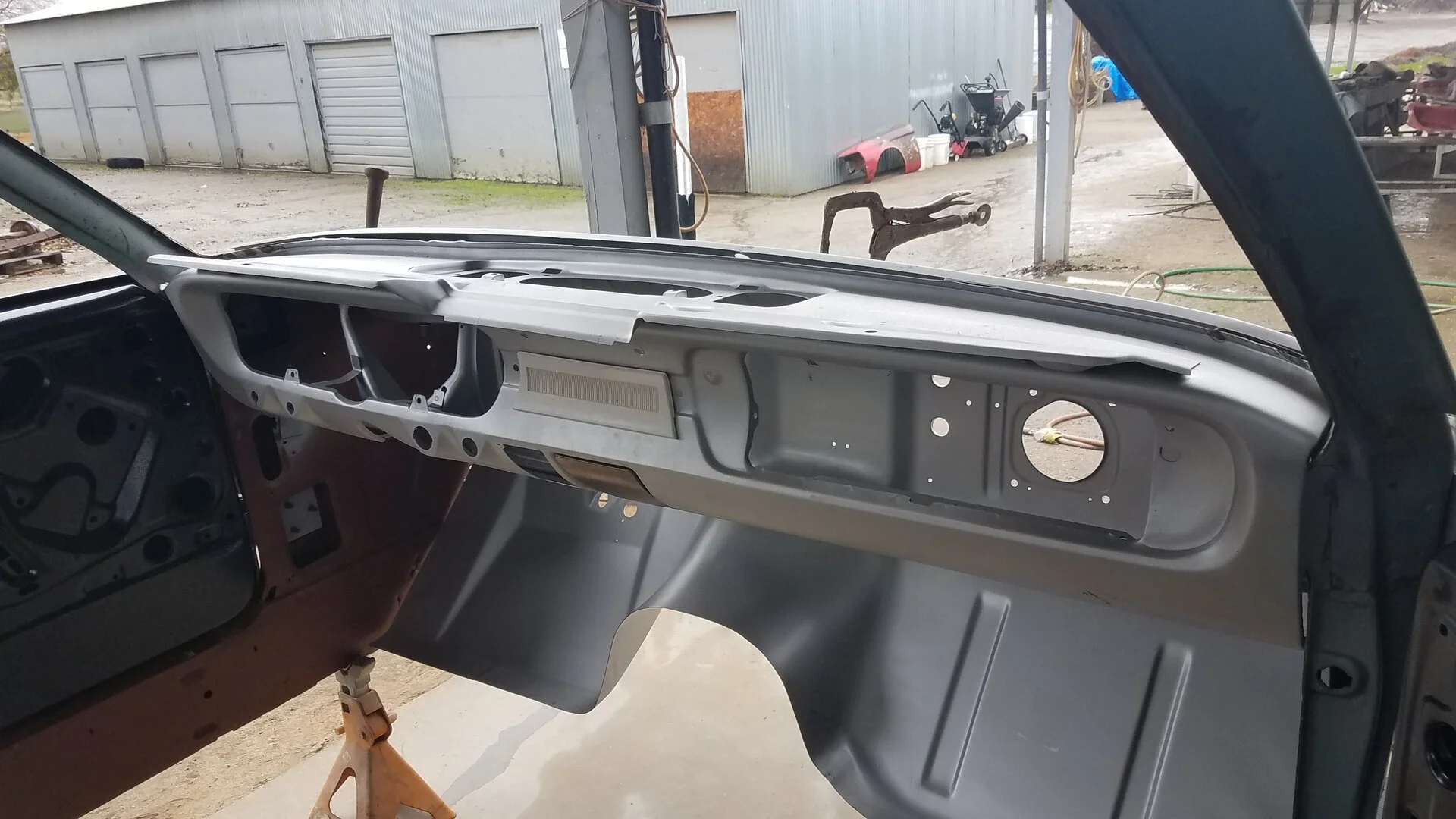

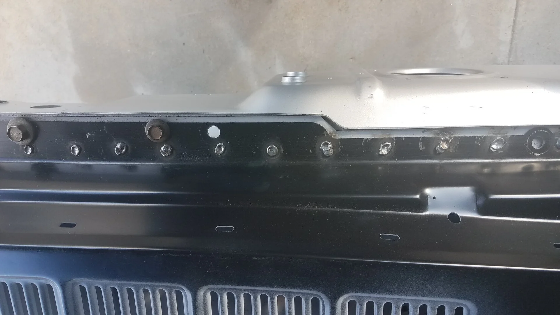

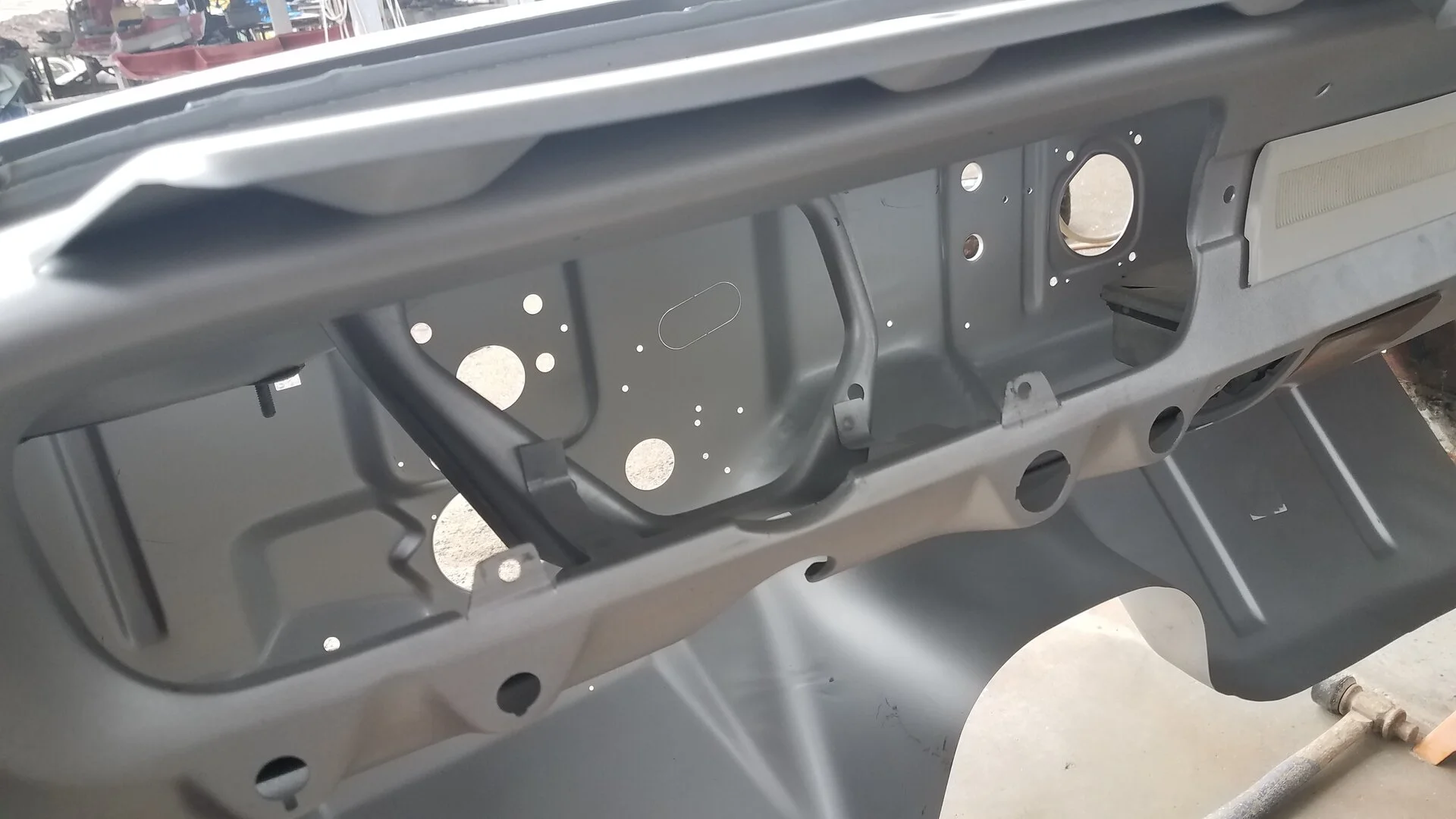

I already have the dash welded in place ,it is helping keep the rockers the proper width . The only thing i didnt like about the new dash is the notch below the gauge cluster ,it shows when the cluster is in place ,the original dash does not have this and will have to be filled in .

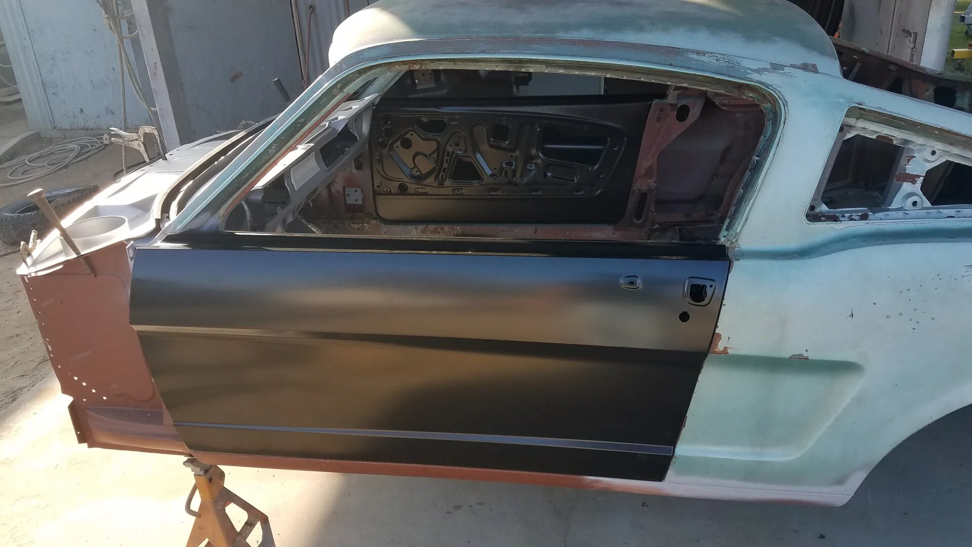

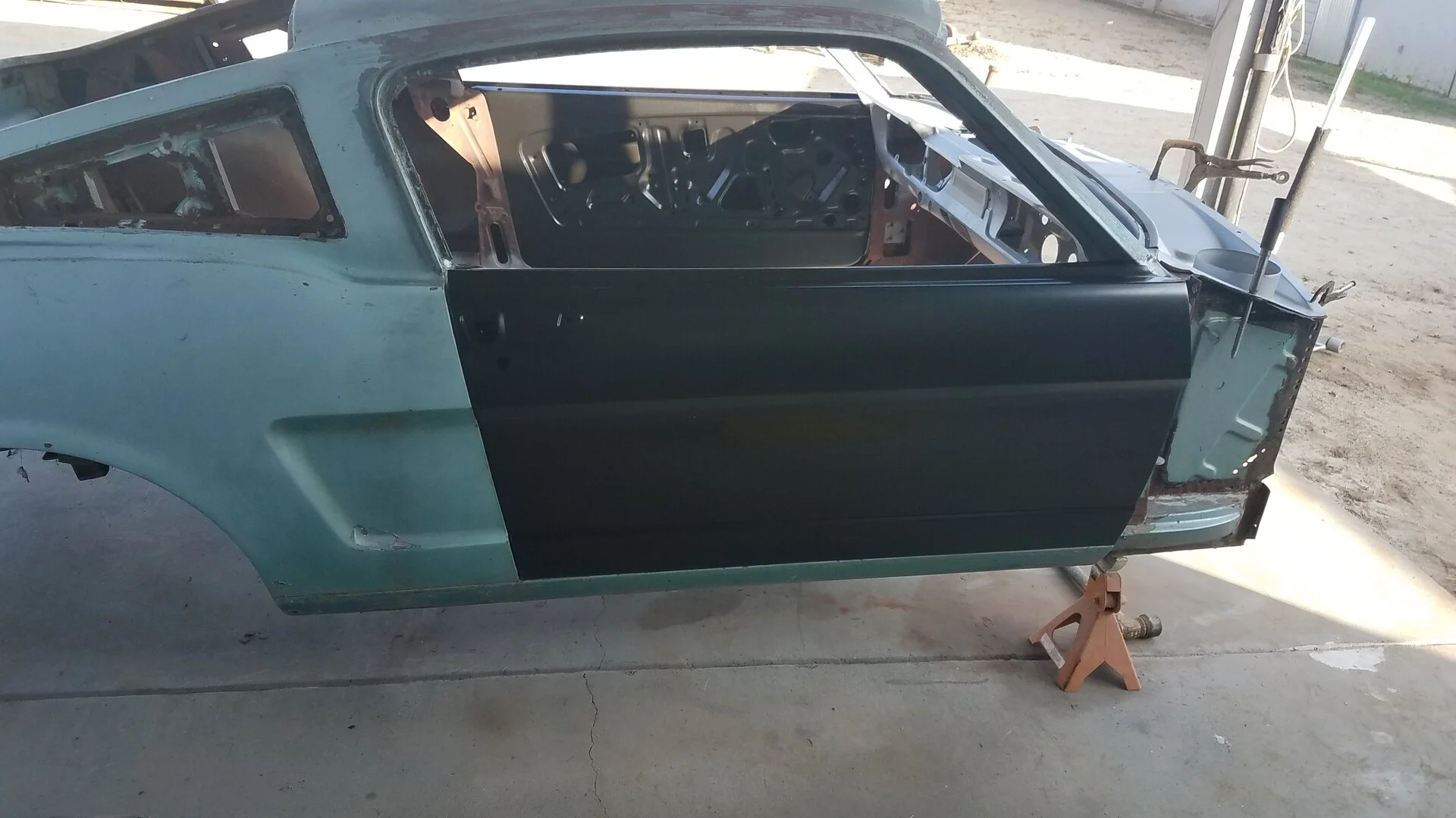

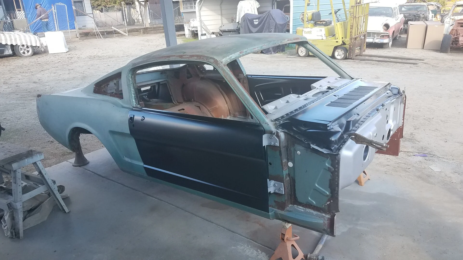

I used the doors off my nephew Nicks 65 fast back to make sure everything lined up ,bought new Dynacorn doors and they just about bolted in perfect right out of the box . I think i got Nick ready to get back into his now ,i keep sending him pics of mine everytime i get a part haha!

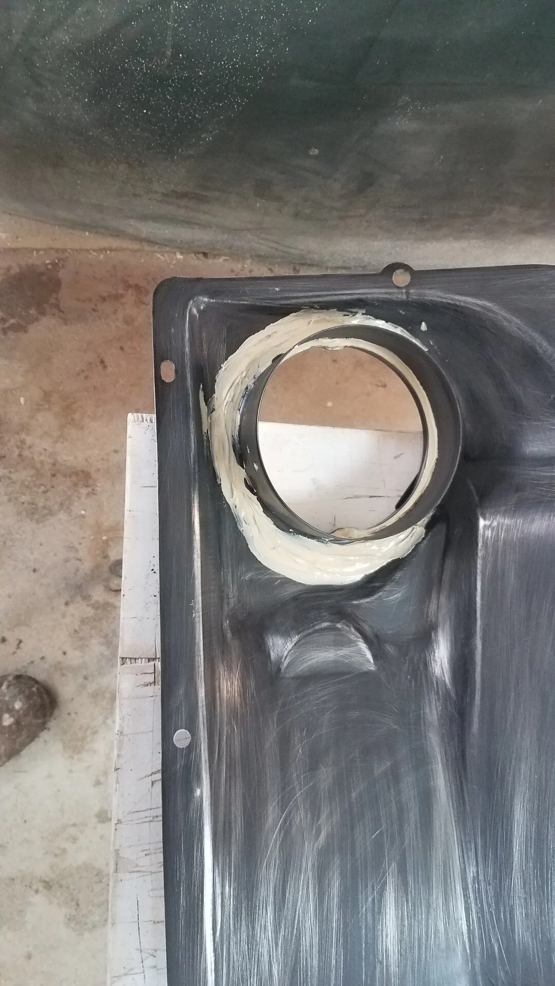

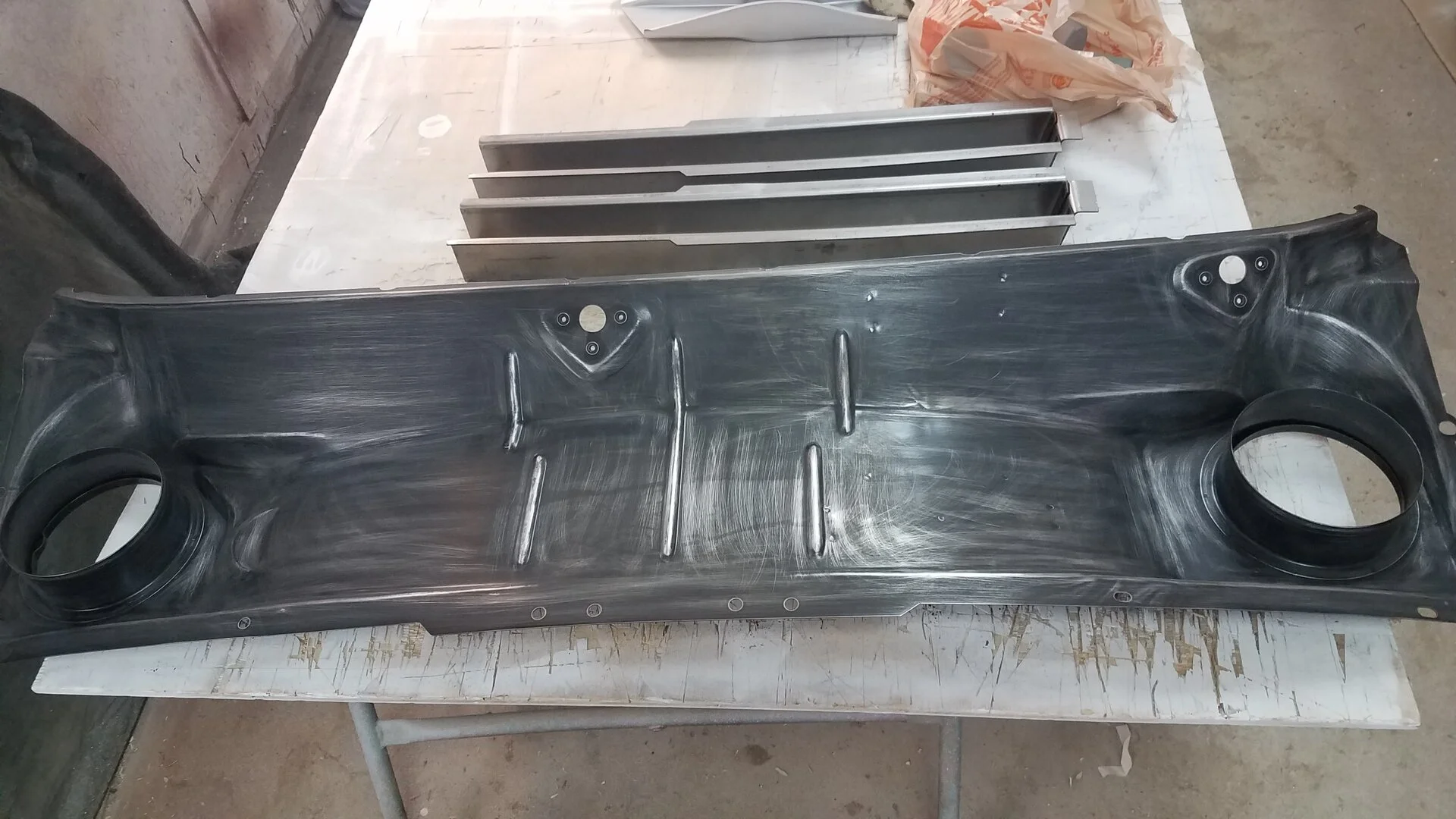

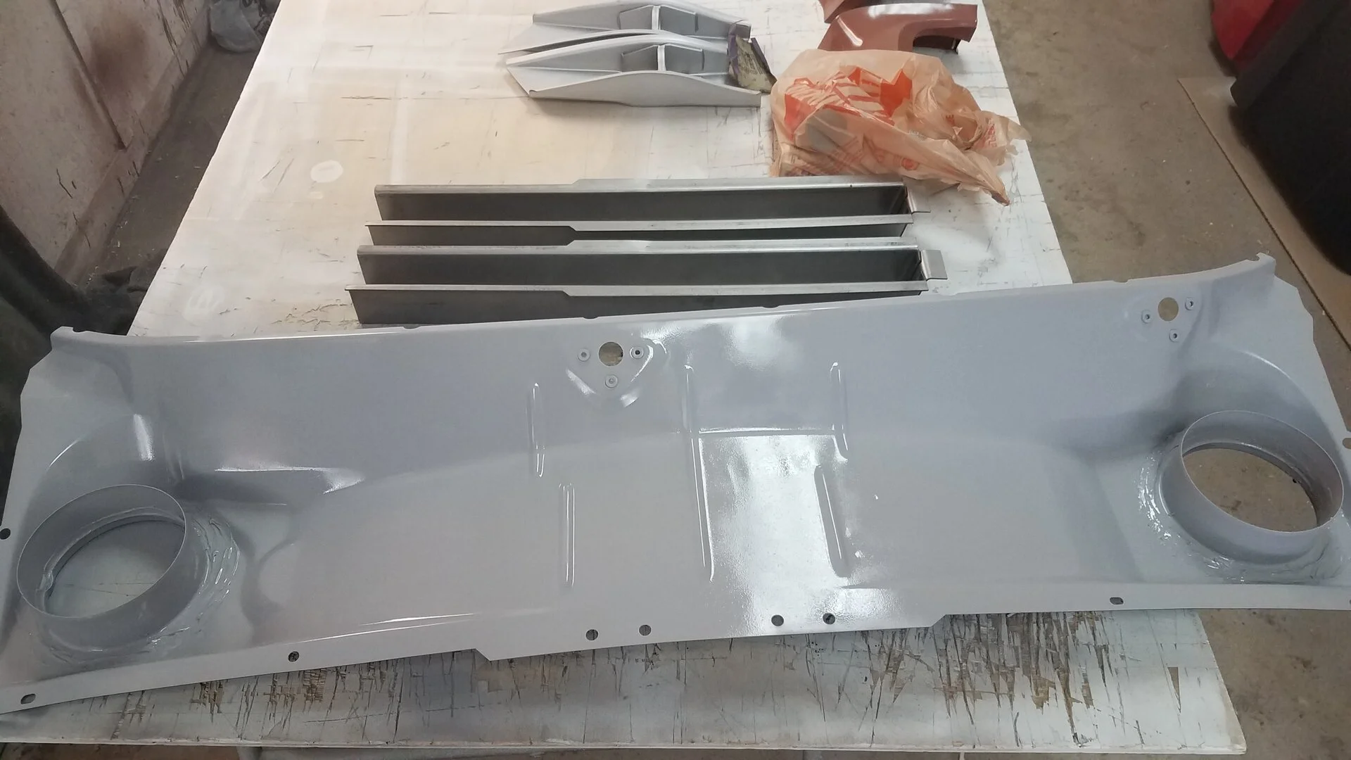

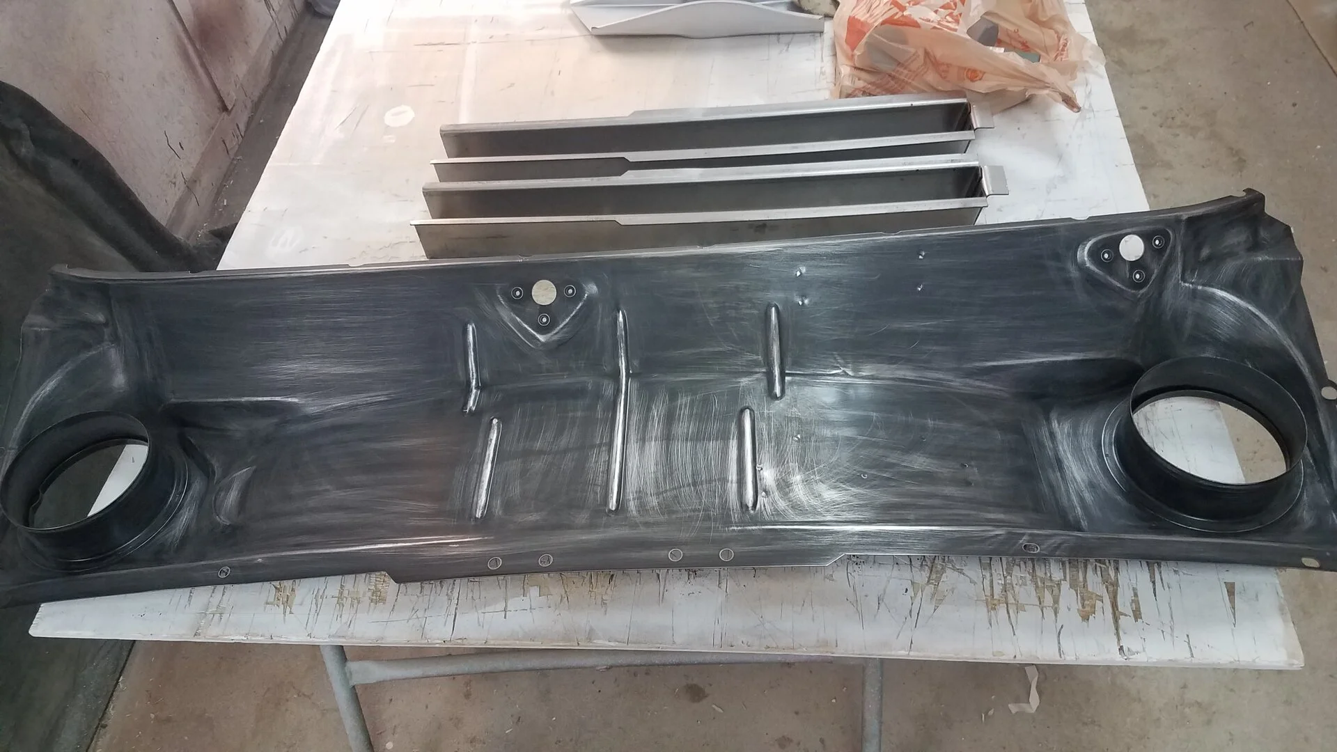

Sanded the inside of the cowl top and bottom ,seam sealed the air vents or water would have ran right through them . I used 3M tan seam sealer ,it looks just like the factory sealer . I primed the inside of both halves with epoxy and now they can be welded together . I also primed the inside of my floor supports

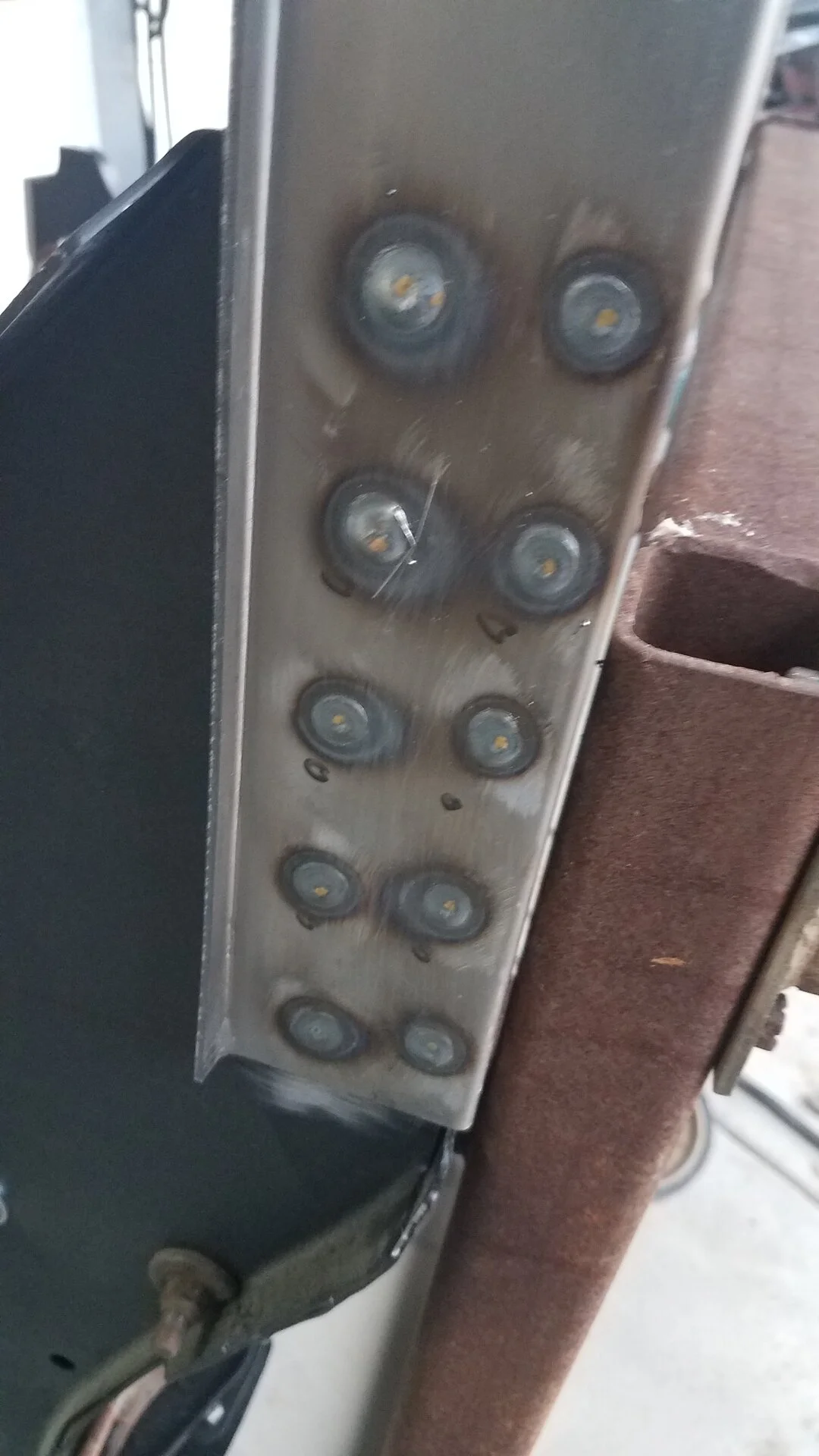

Ripped all the spot welds out and just peeled it away ,this is the second one i have seen do this ,this is why they need torque boxes
So, besides using more spot welds and not running into something solid, do you have plans for reinforcing your own car with a 347?
This looks interesting, but a pita to work around. How much help are subframe connectors on a 65?
Edit, this is still amazing work.

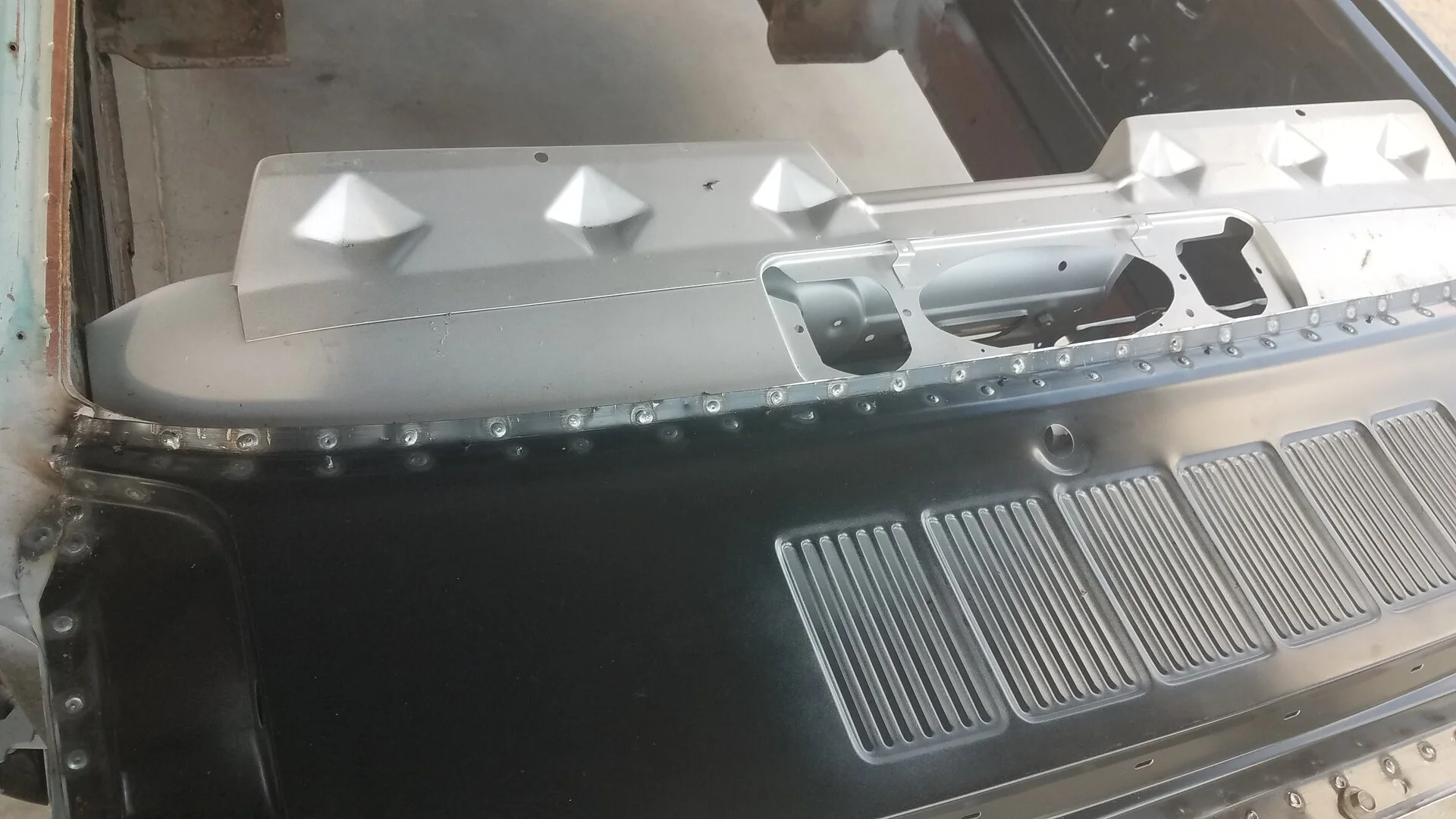

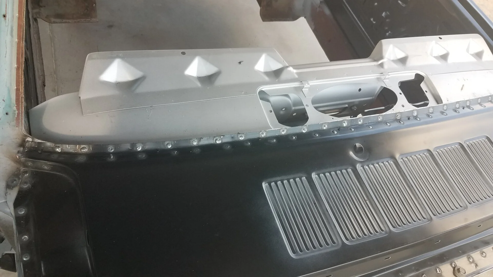

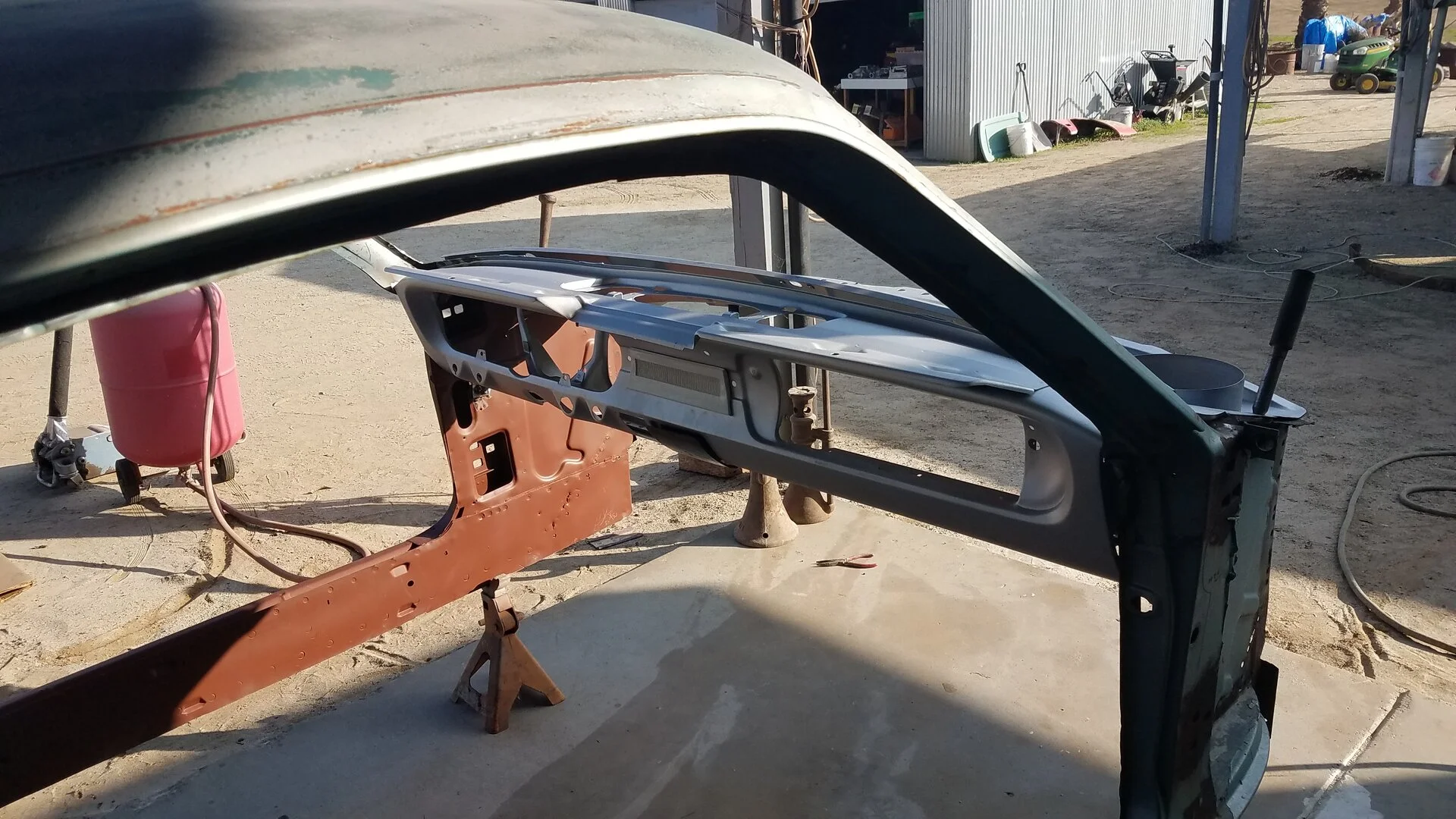

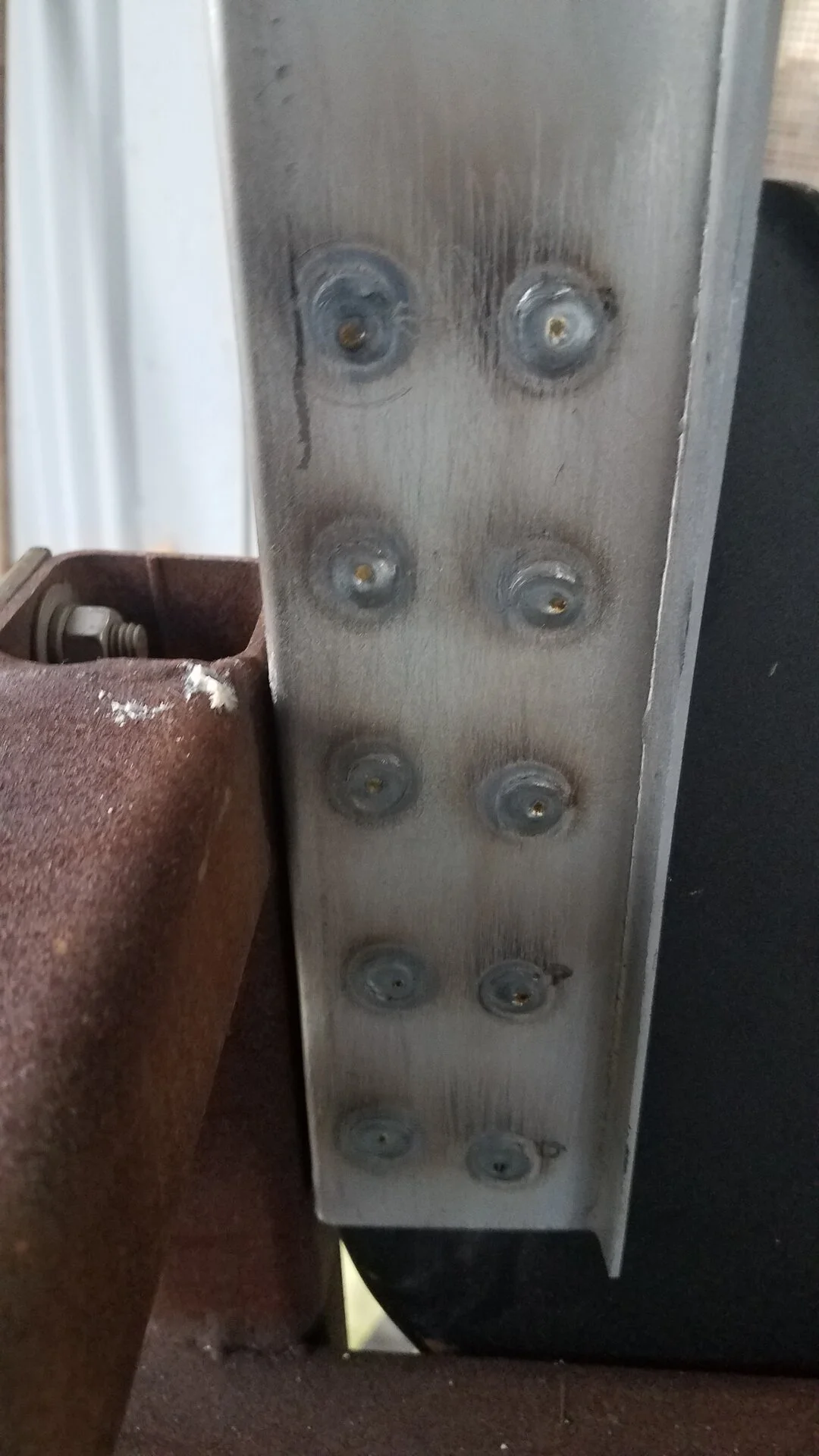

A long hard day drilling plug weld holes and the cowl is in . Welded great until i got to the front lip and pop and spatter started acting up ,made some ugly looking welds but it welded. The welds will be ground down any way and holes will be drilled between them to weld the cowl to the fire wall . Now all i need is the radiator support and the tranny tunnel brace and i can put in the front clip . I tried an original windshield and it fits perfectly .
