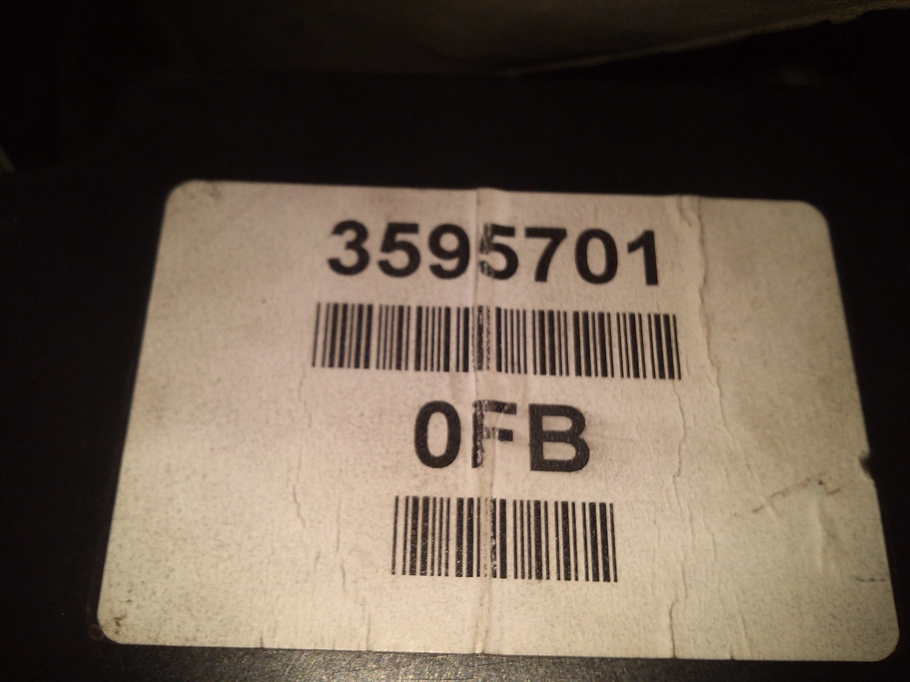

Ok, so no luck at any salvage yards. As it turns out most of them didn't know what a CCRM was or where it was located. I took a pic of mine and the number is not a Ford OEM number. So I have one call out to a guy in Danville that is parting out a 99'. If that fall thru I guess I will have to go thru the Ford dealer.

Update...well i was prepared to bite the bullitt and buy a new CCRM from my local ford dealer. Called...they had one in stock, $262.00....drove over there....they didn't have it, another dealer had it 10 miles away. Drive to other dealer...wait 40 mins in line...get to counter, they don't have it! this is a saturday and i've wasted enough time. the guy tells me he can order it...i said "do it", he says..."can't order it today, gonna be monday till i can do that...takes 3-4 days to get it". Fine....but he gave me the part number so i could call it in monday. So, defeated i go home, get on the internet and type in the new number i got from the dealer. BINGO, a place called DriverSide Inc. has several of them...$150.00. Ordered immediately, arrived the following Tuesday. Installed and the A/C works like a charm.
