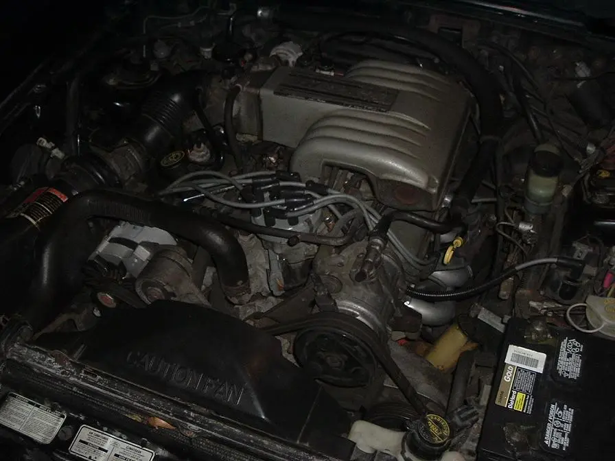

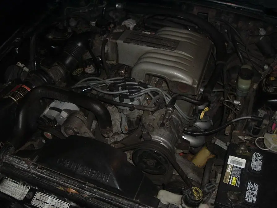

Hey guys, I got home at 12:40 today. Worked at 5:30 so I said what the hay I can take off the a/c and smog pump in 5 hours. Got started at 1, it was my first time, so with struggling to find all the right tools, seeing exactly what I had to take off and how to take it off, and figuring out how to put on the brackets, I got done at around 5:30. THEN came trying to find the right belt, me and my buddy took 3 trips to the parts store to find the right belt. I started at 70.5" cause thats what most people run. But I had to get a new alternator and they gave me a big pulley, so finally got to 74.5" and it fit snuggly. I ended up getting to work at about 6:40. They were pretty mad but oh well, theyll live plus my car was "broken down" lol so I had a pretty good excuse. The smog pump took about 5 minutes to get off. I still need to take off the all the lines, canister, that little box by the radiator etc. But she runs good, and if I were to do it again, I could do it in 2 hours, its really easy just alittle time consuming. I didnt feel a difference but she sure does look GREAT! and I know I lost some weight. Heres the pics.
Ill try and get better pics once I get all the wires and stuff out, It was dark out so their pretty blurry.
Heres a pic with everything apart, that stud was a BITCH to get out.
Heres some before pics
Heres my new alternator, I was pretty mad I had to spend money for an alternator and couldnt spend the extra for a nice 3g but i owe my dad 88 bucks cause I didnt have the money. It blew up in a parking lot, I needed one RIGHT away, didnt have time to look for a cheap one online or go to a junkyard and find a 3g, oh well it looks pretty nice and charges a whole bar more then my old one so im satisfied.

And heres some more pics from today, still gotta get all the lines and stuff out.

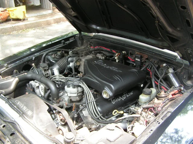

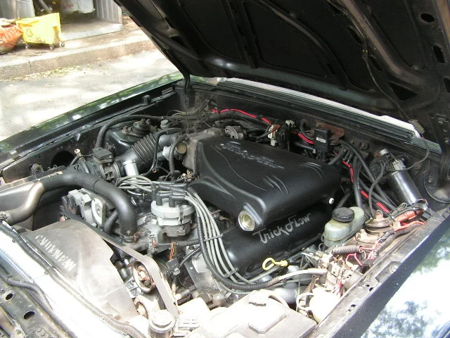

Well since we decided to make this an a/c delete thread, heres the trickflow delete. Relocates tensioner...I sure as hell dont miss my A/C, Id rather have the windows open listening to the exhaust. Also, the car feels like crap with the A/C on.
Before:
After:
