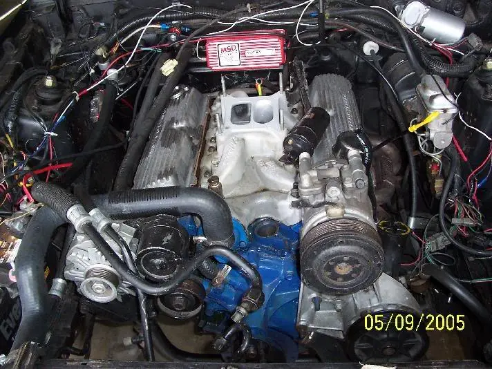

+1 for ford kit, althou on my setup my PS and AC bracket were one giant piece of aluminum, i had to get a PS bracket off a newer car.
here, best pic i have of the monstrosity
