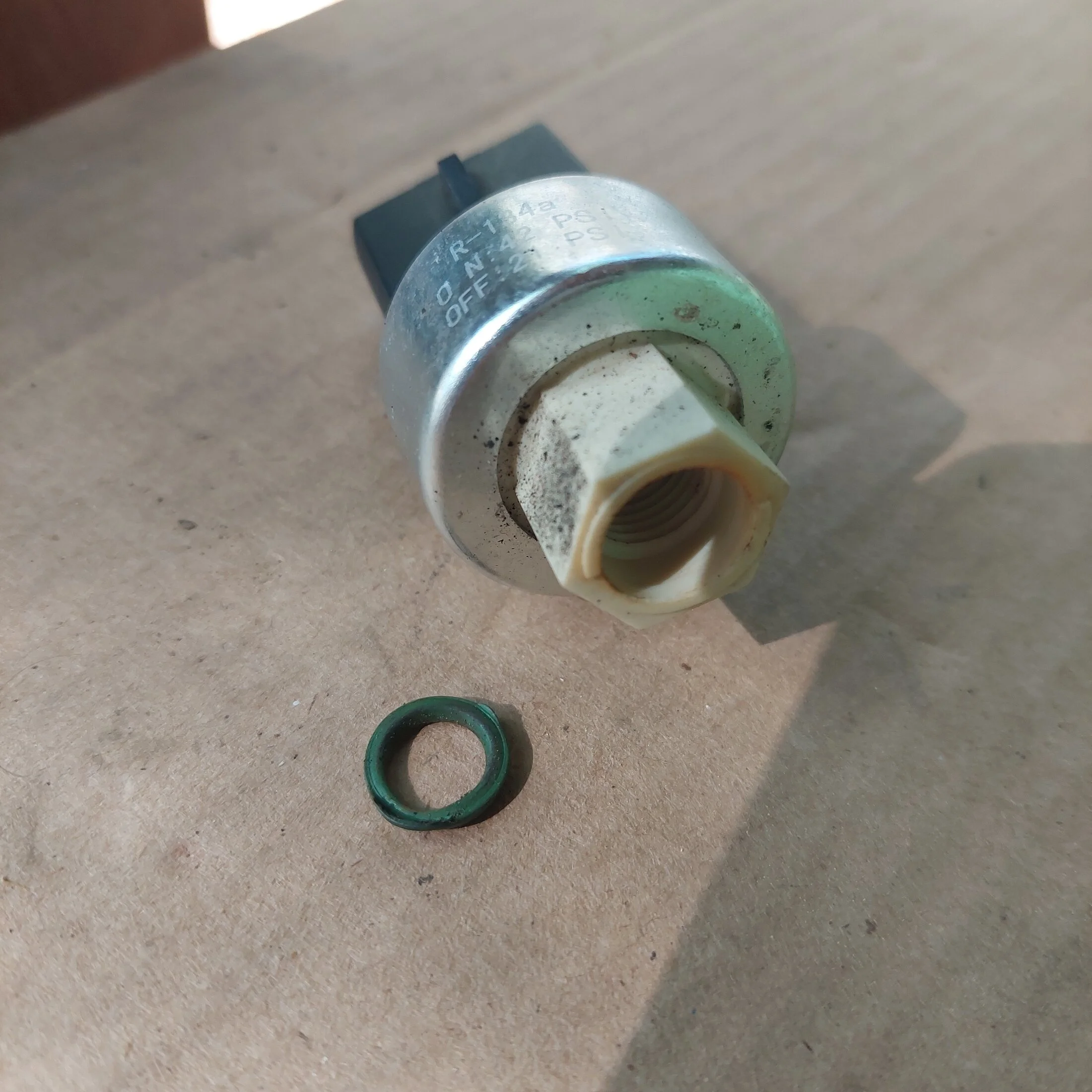

Lets try something new. No overabundance of boring details... Sorta. Me and my good friend have both tried to get the proper low-pressure switch for my car. 88GT. He owned the Napa in my town since we were kids (his dad started it back then.)
Finally, after much grief, we found that this is where the leak was back then.... About 5 years ago.
I have a kit with every size green oring available. None fit correctly to me. The one that comes new with the low-pressure switch isn't even close. Here's what I think the problem is. The threads on the switch are plastic up in there. When i put the switch on the fitting it's very wobbly. I can't imagine that's correct. I finally got it to seal back then but I guess not completely. Very slight leak. It would push the green oring out of the bottom when twisting the switch on. It presses the Schrader valve as y'all know. There's a flat ledge up in there that the oring mashes against. Anyway....... Help!

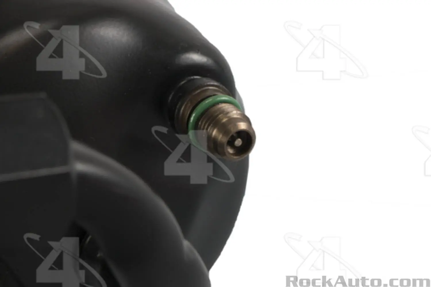

Put some Teflon tape on the threads of the Schrader valve leaving the first couple threads bare. Some pressure switches have an o ring all the way inside where that flat piece pushes the valve. Haven't looked at a fox pressure switch in a long time.

Here's a couple views. I've tried putting the oring up into the switch hole first and also on the schrader valve housing like the other pic. Apparently, I couldn't get either to work like they should or I wouldn't still have a leak after all this time and effort. Supposed to be a simple screw off then on fix.

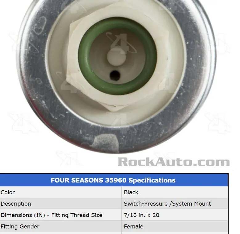

I could try the teflon tape but I'm sure I did back then. Just can't remember doing it. I want to fix it right this time though, so still interested in someone telling me why the dang switch is so floppy. If this were a bolt, it would be like having one size too big/small depending on how you look at it. I can almost pull the switch off once the threads are engaged but not tight yet. That's how much it wobbles. Everything I find says those threads are 7/16-20. Can anyone tell me if all of these are the same threads? Thanks.

Thanks Mike. I guess I'll drive the car over to O'Reilly and grab a few to see which will fit correctly. Then i can fight with the oring after that. Weird to me is that all of those dryer fitting are 7/16-20. Seems like any of them would thread on snug huh?
Let me clarify something. Without the o-ring in it it's wobbly. I wanted to check it like that to see if the threads were engaging properly. Tell me if I'm wrong but shouldn't the threads still be snug even without the o-ring in there? Like I said above it feels like when you put a metric or standard bolt in the wrong hole. You can tell the threads are engaging but they're not the right size. So Mike, when you said that the switch on yours is really snug does that include without the o-ring being on the inside?

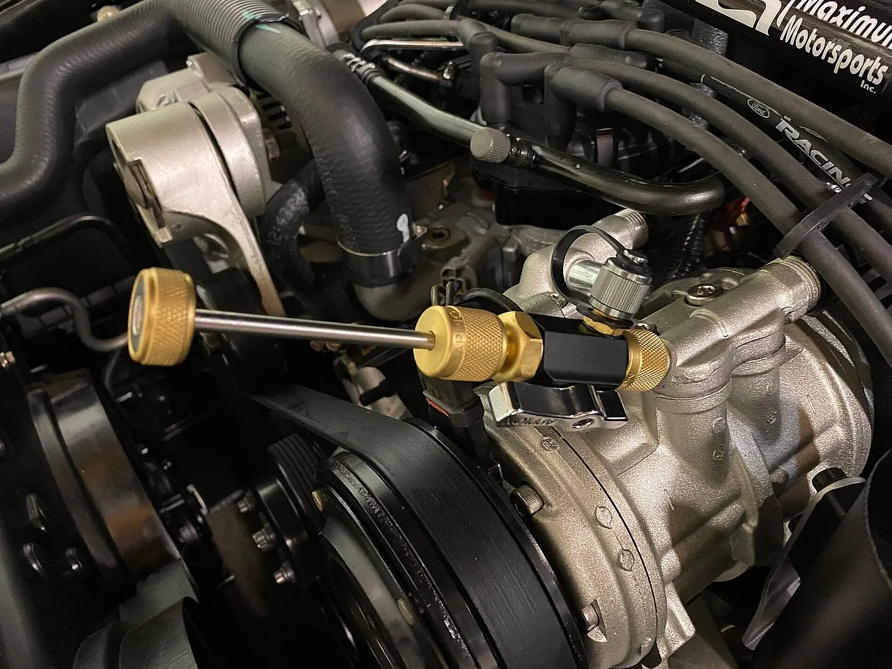

Appion MGAVCT 1/4" MegaFlow Vacuum-Rated Valve Core Removal Tool https://a.co/d/fqsQ2pB
Confirm that the accumulator port fitting is the same size as the low pressure fitting. If it is, this will work.
I can also send you mine to use if you’ll cover shipping.
But this will allow you to swap cores on a fully pressurized system.
