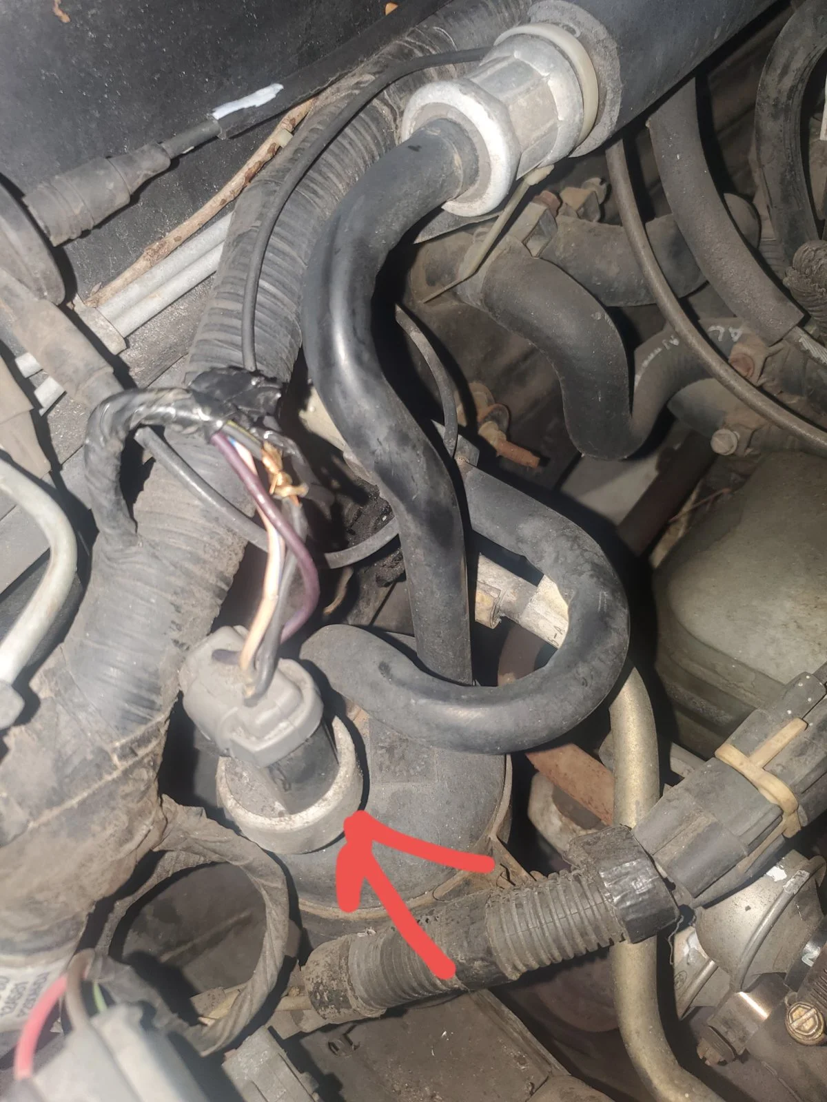

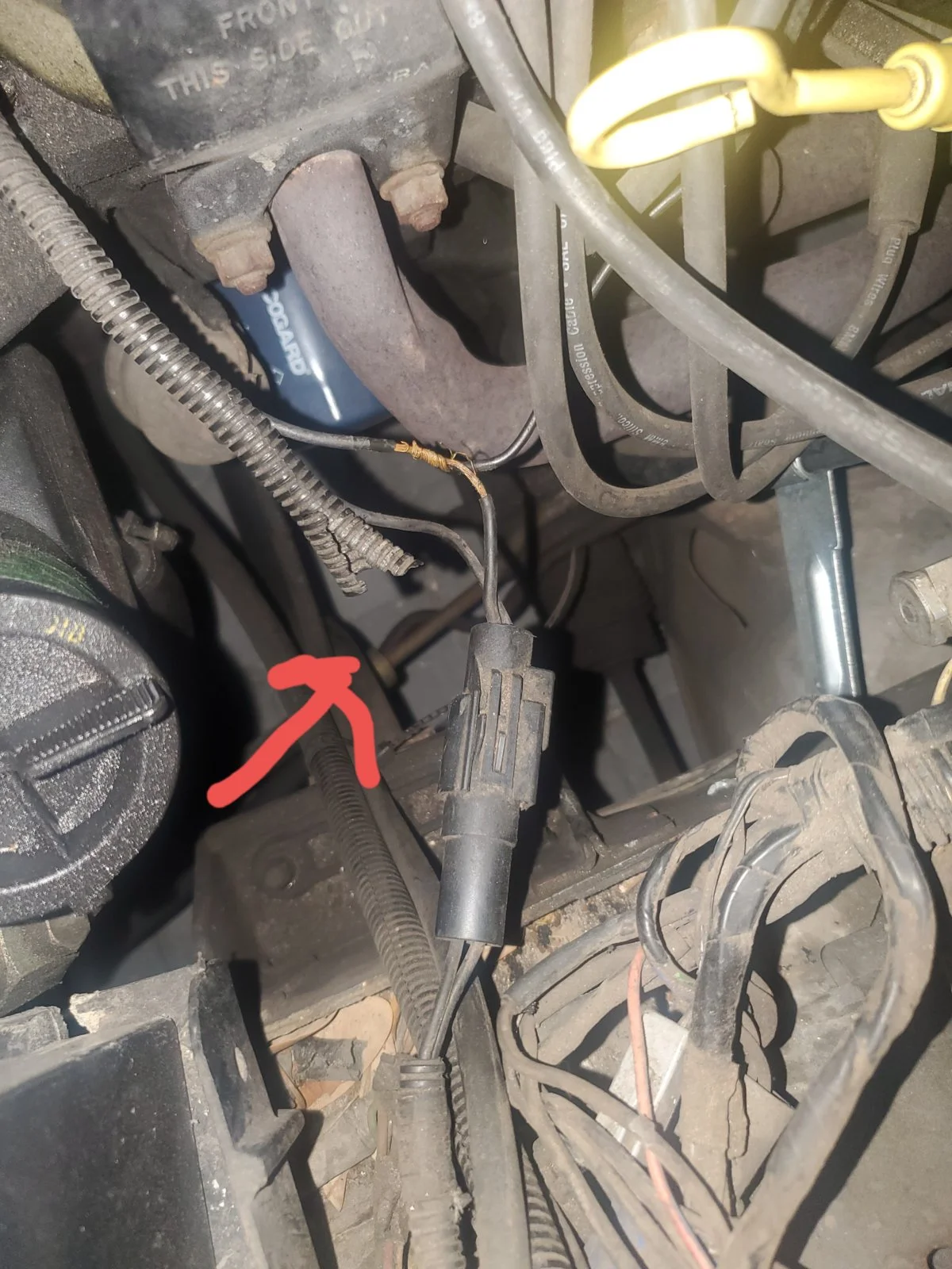

Alright so I pulled the connector
Jumped and closed the circuit saw sparks ac
clutch didnt click
Hoping it was the right connector
Also found a black wire that was tied in above that connector all the way to connector that goes to the ac connector seems to be a ground idk why it's there

Did it jumped the connector and the clutch didnt click or anything
You need to jump it and check the connector at the compressor with a test light. If you have power at the connector then you need the clutch assembly. This part is usually cheaper at the local parts store.
Unplug the compressor and jump the switch. If no sparky then the clutch is bad. No spark when tapping wires means the circuit isn't complete. If it sparks it means it's making it all the way to ground...or a short. If you unplug the compressor and it sparks it means there is an issue in the wiring somewhere. There is a diode in the wires about 8 to 10 inches from the compressor ( may be little further or closer ). There are two wires...one is black w/ yellow stripe....one is black w/ green stripe. Im not diffe which side has the diode...but I think it's the yellow one. I've had compressors not work because that part was burned out interrupting the current flow.
So I unplugged the connector from the compressor and there was no spark so I guess it's time for a new clutch
