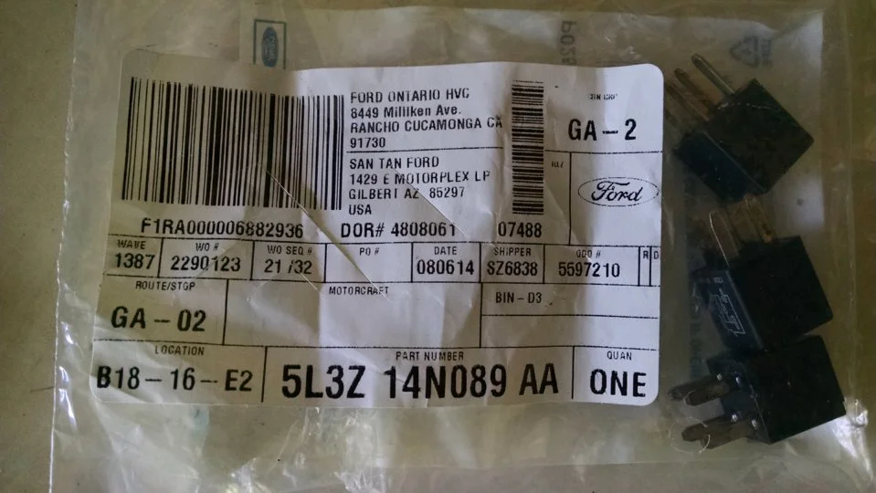

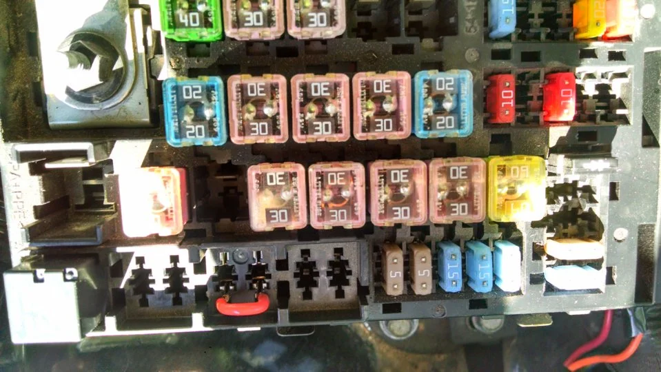

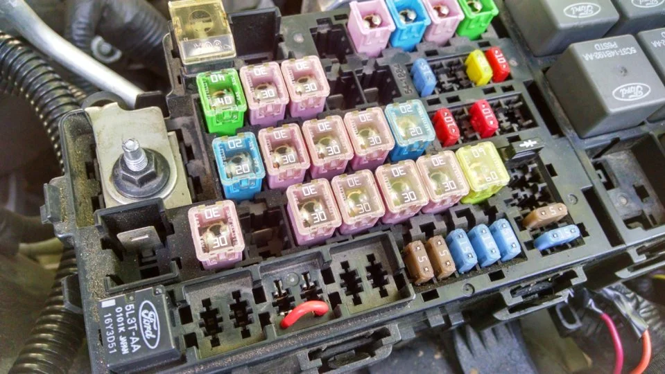

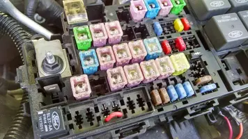

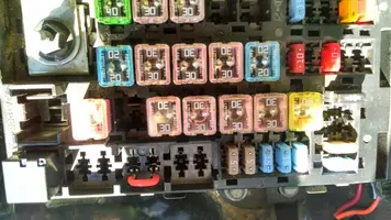

So I figured I would recharge the whole system as I know there's a pressure sensor in the A/C compressor that only engages if it's to a certain level. So Brake Masters took care of that for me, and didn't charge me as it was done less than a year ago, but they said it was an electrical issue I was facing as the compressor is not kicking on. They claimed they checked fuses, but I wanted to be sure, so I checked the specific fuses for the A/C Compressor which are 25 10A** A/C compressor relay and 43 G8VA relay A/C compressor relay in the owner's manual. The fuse was fine and the relay is questionable. I came to the conclusion that if I run a jumper wire from one end of the relay to the other, the compressor's clutch engages, and BOOM! The A/C is as cold as could be. So I said it's the relay! Which are like $35 from the dealership, and I found one on Ebay for $10, so I ordered, waited a few days and tried the new relay today, no dice. So I swapped my other relay for the Fuel pump (41) thinking I just got a cheap relay, but that didn't work either. So either my relay for my Fuel pump and this brand new relay is faulty, or I have some other sort of electrical issue. I cannot figure it out and really need some help before temps hit 115 out here.
Here's the red wire I've been running to let the compressor clutch engage.
