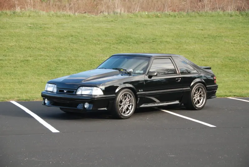

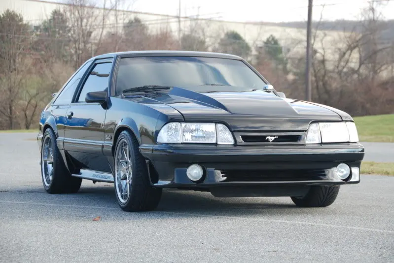

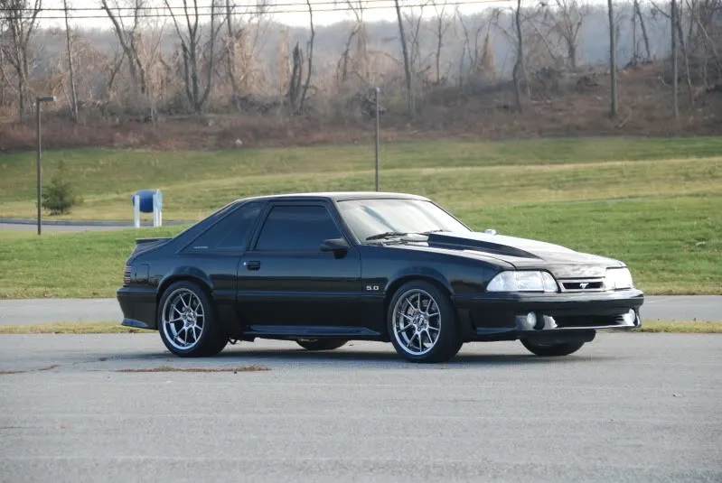

I put some BBS RK Plasmas on recently. To me, they really look all business and lack the "show" of the Saleens. They are also extremely light. I go between these and the Saleens but for right now I'm going to sport them.

thats a damn good looking GT, nice job and the new wheels look great!

New wheels ftw. Not only do they look all business but it's a refreshing change I think. Not that there's anything wrong with the Saleens.

Thanks for the positive feedback everyone. I'm still trying to decide if I should just chrome the BBS wheels. I'll have to think about that one for awhile.

Looks awesome! Any issues with those tires rubbing? Eventually I plan on getting the MM Road and Track but don't want any rubbing at all in the turns or on a road course.
Not on my setup but it is also adjustable through the front coil-overs and rear weight jacker LCAs. Rubbing (outside of the fender) can occur on the front coilover depending on wheel/tire size. My front Saleens (9") with a front 255 tire is very close but does not rub. The front BBS (8.5) w/ 245 tire has plenty of clearance.
The Road & Track kit doesn't have any adjustability (front coil-overs or rear weight jacker LCAs). It would seem that you shouldn't have any issues with rubbing but you also won't be able to customize the car's height.

Welcome back! I am loving the BBS wheels on there, a nice change of pace.

89drop said:
hmmm...feels like an oyster in my pants after looking at your car. very sexy and well done! what are your tire sizes front and rear?
Saleens:
Front 18x9 wheel w/ 255/35/18
Rear 18X10 wheels w/ 285/35/18
BBS:
Front 18X8.5 w/ 245/45/18
Rear 18X10 w/ 285/35/18
