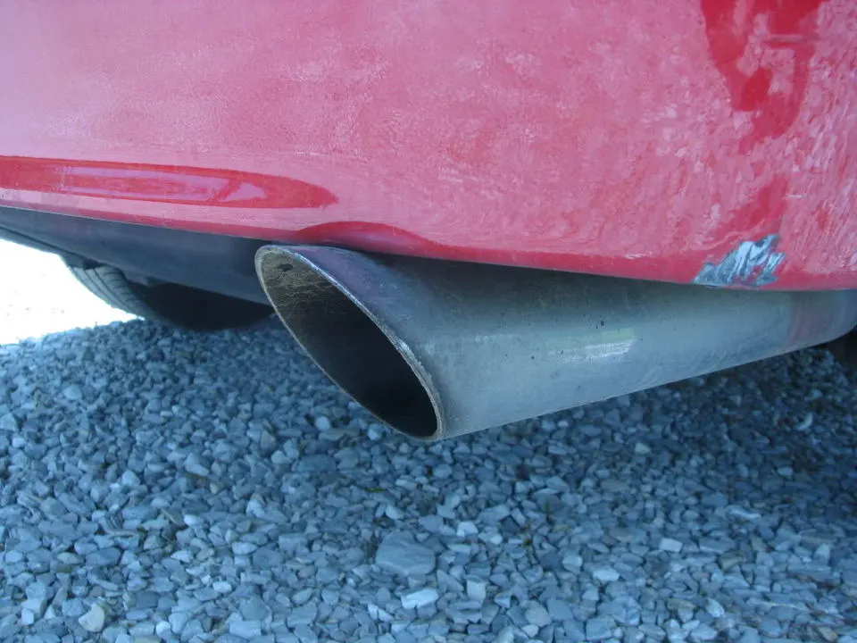

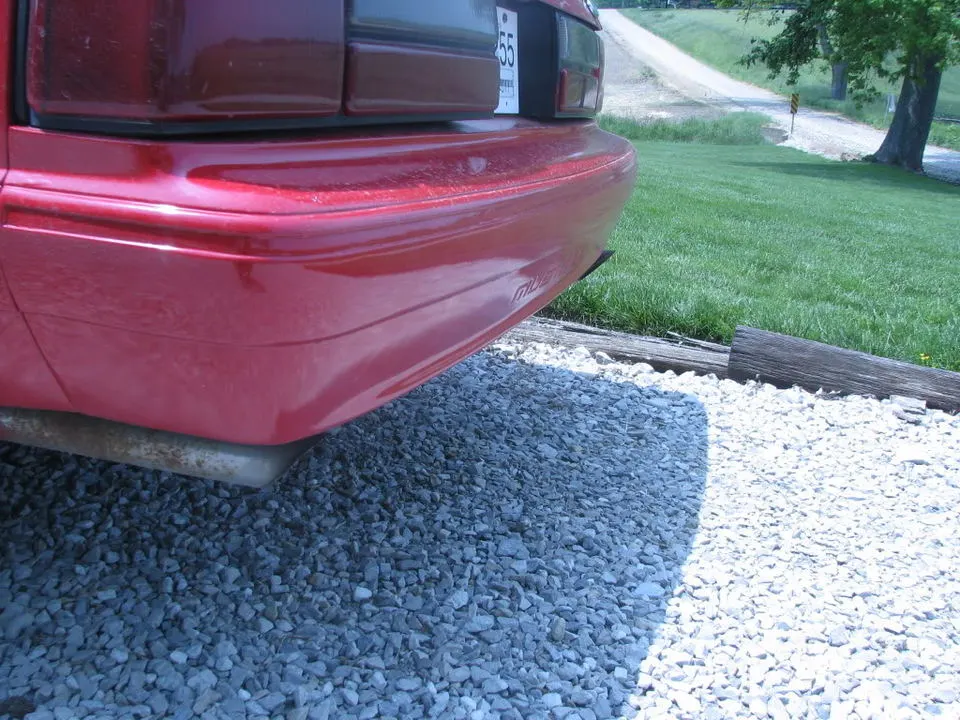

2) The tail pipe on the passengers side sticks out further than the drivers side and is touching the rear bumper.
When going a steady speed I can hear it rattling on the body, how would I go about fixing this, preferably without having to get new tailpipes.

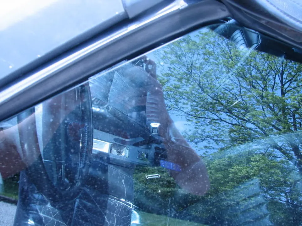

3) There is a gap between the window and the top on the drivers side, it doesn't seem like the window is off track and it feels like it is all the way up, it won't go up any further, what is wrong here? How could I fix it?

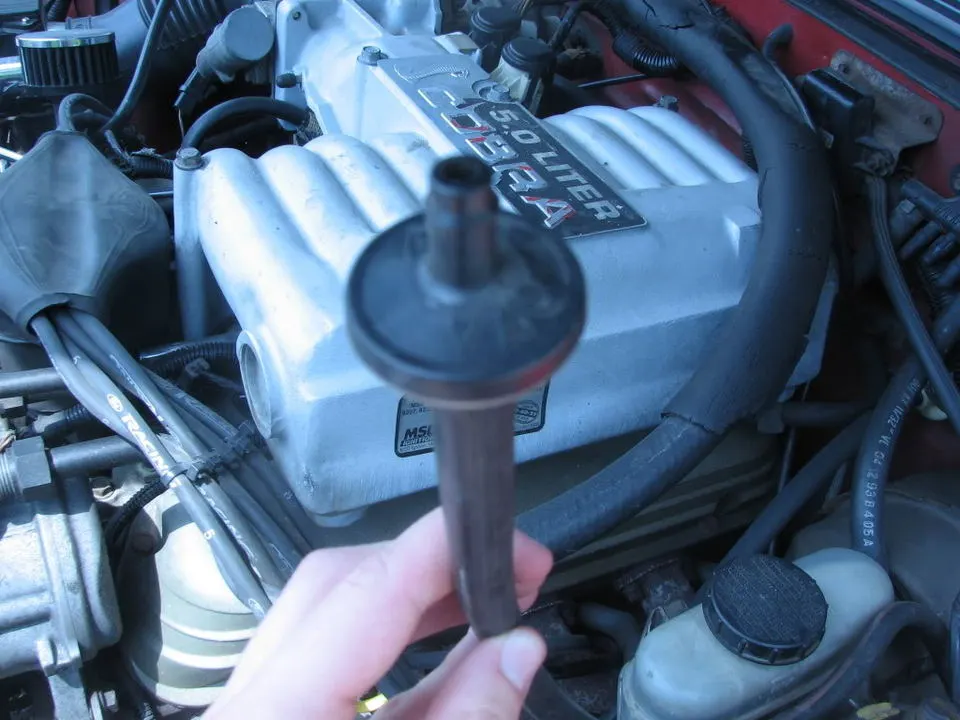

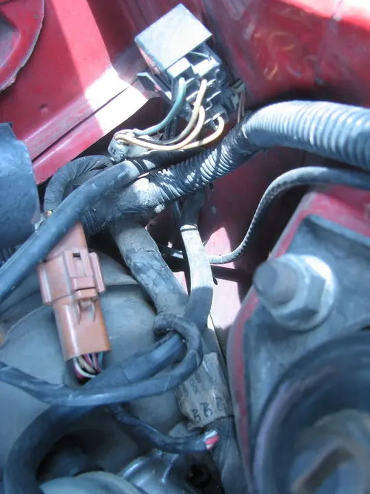

4) The air conditioner and heater both work in the car, but they will only blow out of the defrosters on top of the dash and on the floor, it won't blow anything out of the front vents in the dash. The guy I bought it from said something about a vac line but I didn't quite get what he was talking about. I was checking the oil yesterday and saw this in the engine bay and it isn't attached to anything.
Is that what needs to be hooked up in order to make the a/c blow out of the main vents? If so where does this end of it go?

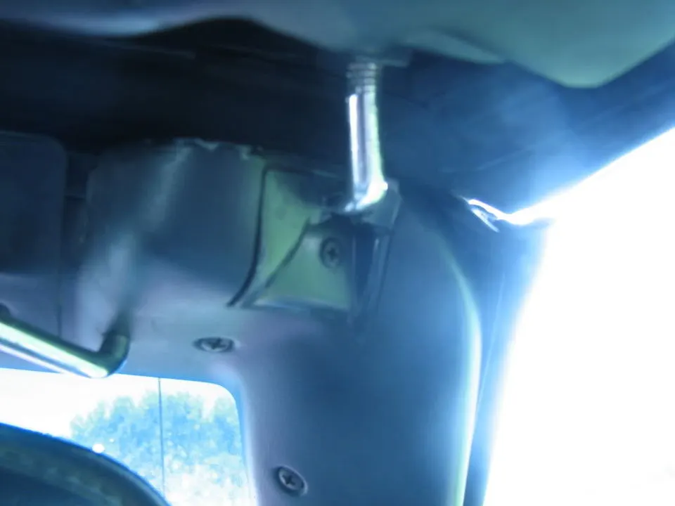

5) This clip is broken so it won't stay down all the way and rattles sometimes, where could I get that little yellow clip at? I looked on late model restoration and couldn't find anything, but I don't know the name of the piece so I didn't exactly know what I was looking for lol.

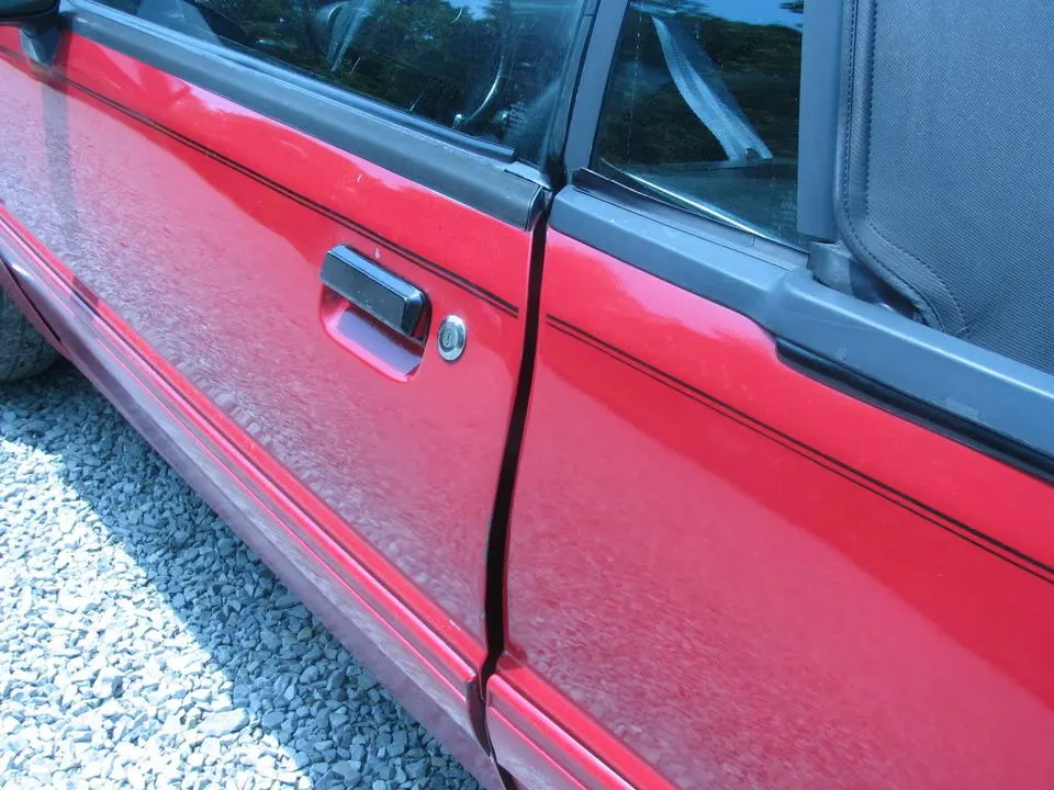

6) The drivers side door will latch all the way but you have to slam it shut or like pick up on it to shut it. My dad and the guy I bought it from both said it just needs a little plastic bushing. THis is the door not latched all the way.
Where can I get this and where on the door does it go?

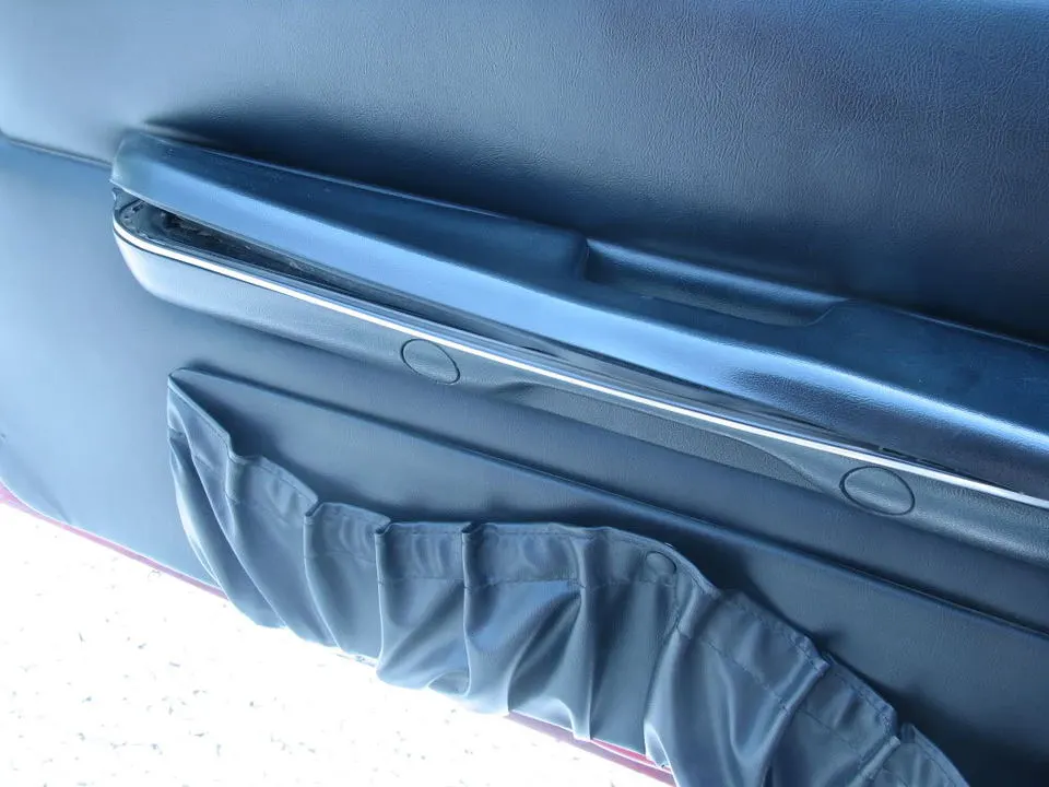

9) I plan on getting this fixed, don't know if I'll try to glue it back down or get a new armrest.

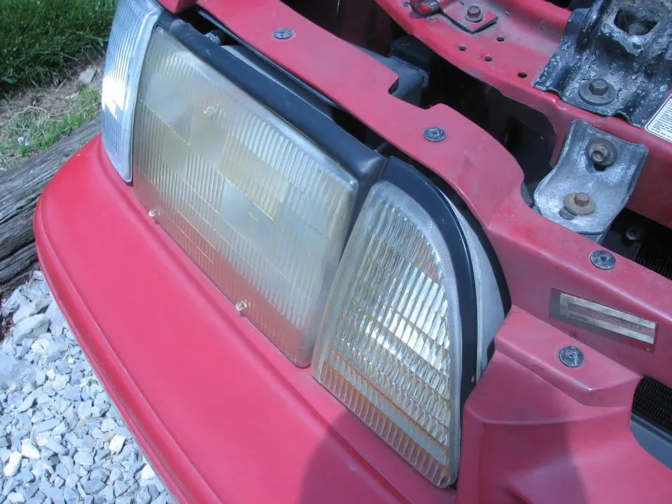

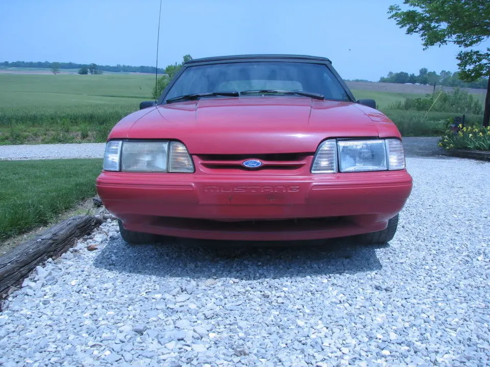

10) I plan to get new headlights because the passengers side is yellow and the drivers side has a big crack in it

#2 - This is probably due to how the mufflers were hung, again my car had this problem only the left side stuck out further. I had different mufflers put on and the shop "did the best they could" to get them even...they got them close enough to my satisfaction.

#4 that looks like the cruise control vacuum dump. I think it hooks up to the brake pedal assembly to turn off cruise when you hit the brake.
#6, you can get replacement door strikers at auto zone. They are in the "help" section of parts. I don't know the p/n, but it's a full striker assembly. Of course, you can try adjusting yours first. All you need is the correct torx socket to fit it.

Oh yeah he said the cruise control was unhooked when he put in the T5 so you're probably right.

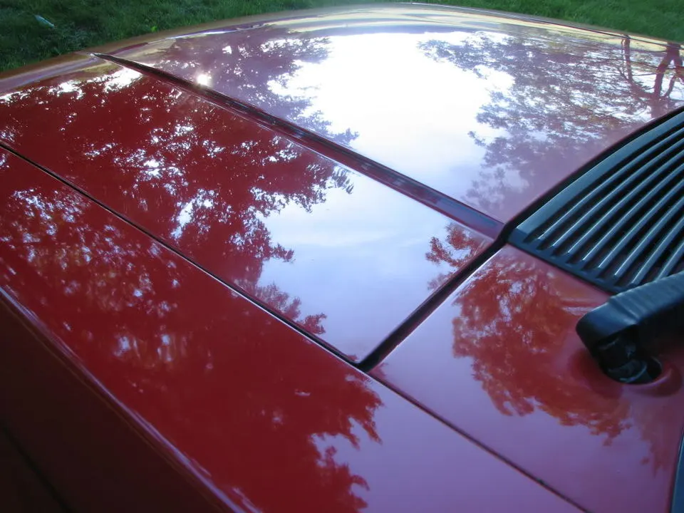

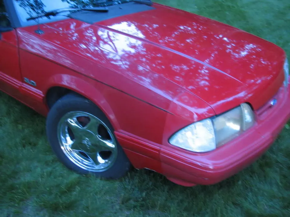

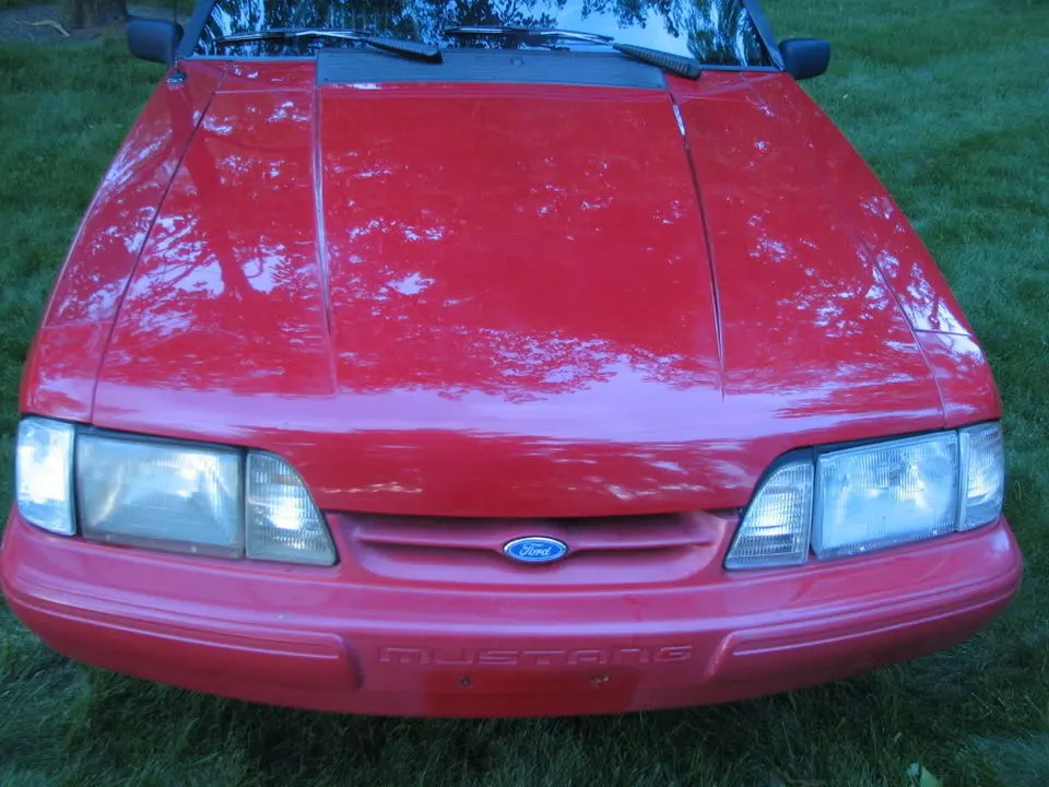

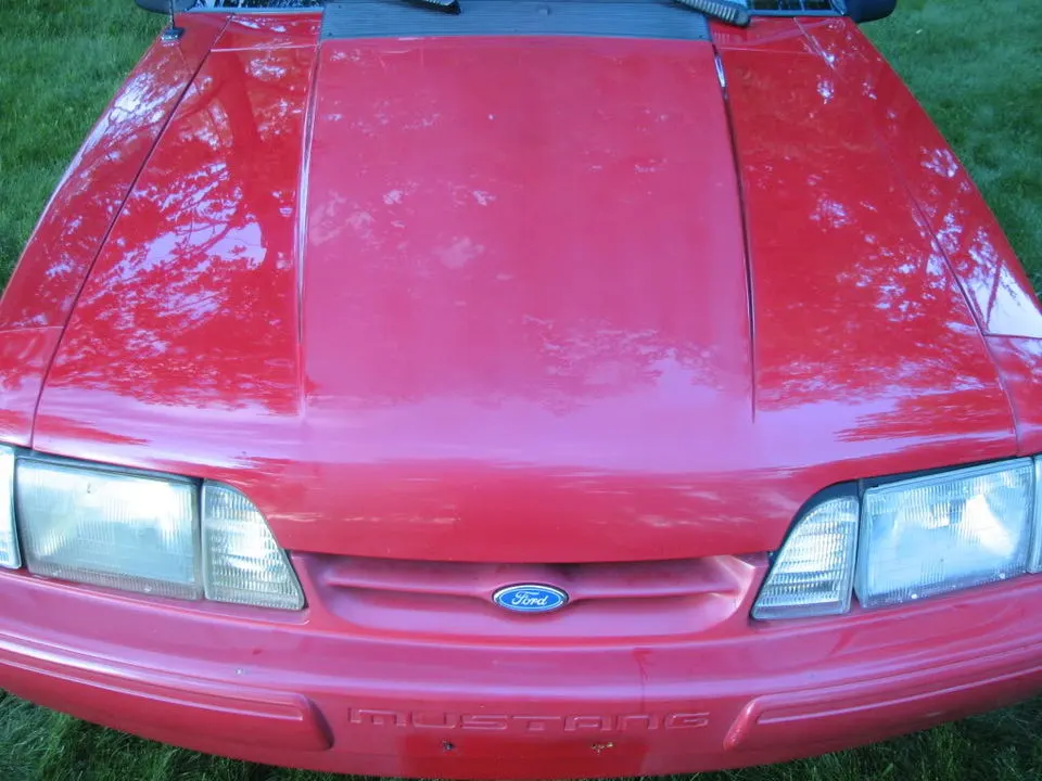

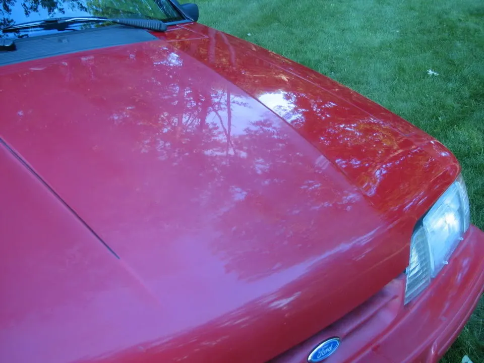

I haven't started ordering anything yet or really fixing anything yet, but I did start on polishing it up today. I will have to finish saturday and possibly redo what I did because outside it looked great but inside it had a weird streaky film look to it, may have to start over and take my time more to get it looking better. But its a start.
Bet you can't tell where I started
I was thinking of leaving it like this, thought it looked pretty cool...
Totally kidding there
Thats all the progress I got, hoping I can get the front bumper to match. I will probably be starting over saturday though as I said it was kind of streaky, but I think it turned out pretty good so far. I'll take my time more saturday though and get it looking sharp.

For the doors, you probably need new pins and bushings for the hinges.
Also as suggested you need new a new striker or bushing and adjustment.
For the tailpipe it's probably hitting the upper control arm or the frame.
Put the rear on jackstands, no the body, go under loosen the h to catback, have someone twist the tailpipe, then retighten when it clears.
For the heat/ac you probably have a vacumm line off, there is one that goes to it on the passenger top of the firewall, it's not too long and has a female end on it.

For the headlights, buy a compoud kit for the one, then get a real ford light for the other side.
Aftermarket headlights are garbage, that goes for all of them.
