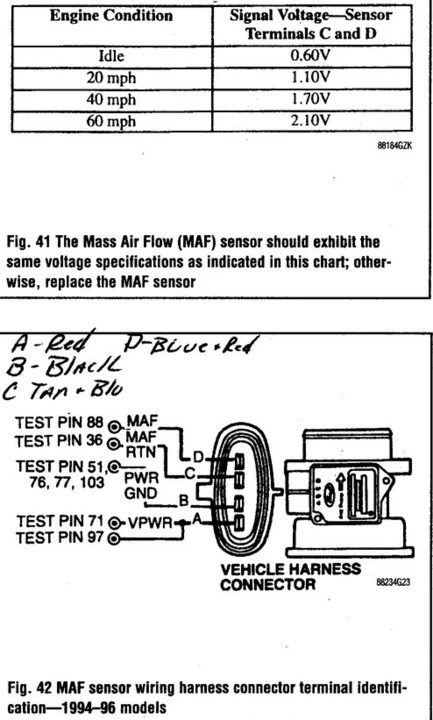

i have had my 95 gt for about 3 weeks now. It supposedly has a cam. The idle is a little rough as you would expect and it hangs a bit, not bad. I took the maf sensor out to clean it and it was slightly bent. It was clean as a whistle so i imagine the previous owner cleaned it out shortly before selling it. Is it still ok or do i need a new one? Is there a way to test it? Also the plug that connects to the maf sensor right at the maf there is a wire that goes from one wire to the other, like a "jumper" wire or something. It goes from the outside wires i will go look at the color of the wires. Is it supposed to be like that or what is the purpose of it?
Edit: the wires are red and red/blue stripe. The connectors that are on each wire say 3m so i figure it is not like that from the factory so why would you do it? I noticed that there is electrical tape on one of the other wires and a couple other wires looks like someone sliced the wire so the bare wire is showing so ill tape them up for sure.:nonono:
sounds to me like someone has jumped the maf wires because of a bad resistor wire ... post pictures of jumper wire and maf sensor....
how to test... post results and if its determined the maf is bad i would disconnect jumper before installing new one....

its the stock one. it says ford on it. i will see if i can test it tomorrow, i dont think i have a volt meter but ill see if i can find one. So if it is bad than i need a new maf sensor basically? How much do they run?
