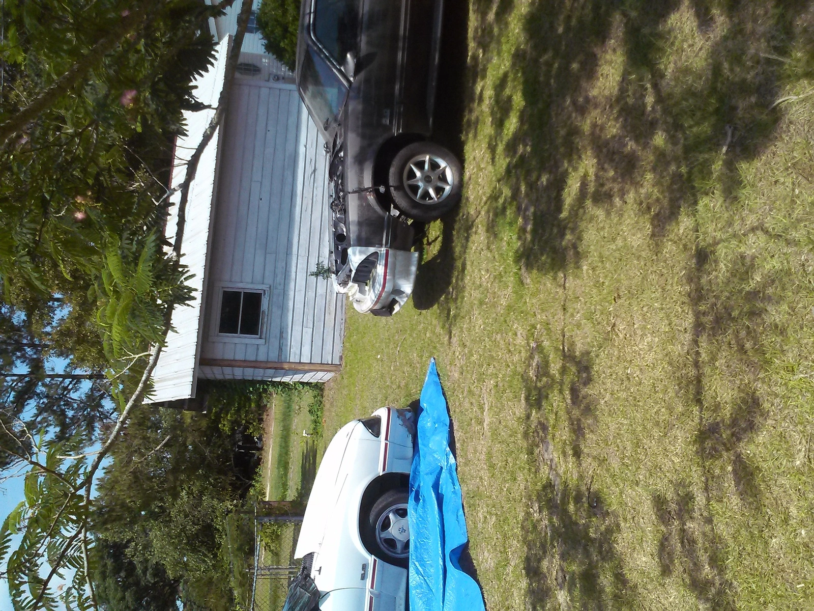

wont be too hard though, I'm gonna have a little help from the guy that built my first car i think hearers some pictures
also i got the Body last night, yes it started life as a V8 but an auto V8, how hard is this gonna be to change and where to start? gpotta put my lights on it too...

I have 2 fox mustangs and was allways able to just look at the other one
I've been bagging up nuts and bolts, no barker so i put a piece of paper in there with what its to! I've just been taking apart interiors and exterior parts so far though. I think that frame on my old car is still good, no dings or nothing on the other side of it, it is possible to move the new body to old frame? would that be easier?
Mustangs are unibody. There is no separate frame.
