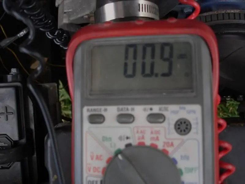

My injectors are not firing on my '66 EFI conversion stang and I'm following along jrichker's instructions to test the ECU wiring.

I have a question about the Ohms readings I'm getting when I hook up the ground wire at the injector and where it runs to at the computer connector. I get an ohm's reading of 0.9 - 1.1 and with the prongs disconnected and touching I get the same thing... does this indicate that my wiring is good?
3.) Set the multimeter to low scale Ohms and measure between the
computer ground located below the computer and the suspect fuel injector
pins. You should see greater than 100 K Ohms resistance. If you see less
than 100 Ohms, the wiring between the injector and the computer has a
short to ground and needs service. Check the harness and look for damage,
kinks or frayed spots.
Where is the computer ground to where I can check this? Do I use PIN 60 ? When I plug into pin 60 and the ground wire for the injector, the multimeter just shows the infinity symbol (rather just the #1) I'll have to go back out and double check that, but am I doing this correctly?
I'm trying to be 100% sure the A9L computer is shot before I go buy another one, since this is an EFI conversion I'm not sure if it worked when I had purchased it.

Since I wrote the test path, I guess I had better respond to your post.
Measure the resistance of the wire form the non red wire on the injector connector to the pin on the computer connector. You will need to disconnect the computer to do this. On 86-93 Mustangs, the computer is located under the passenger side kick panel. Disconnect the computer by loosening the 10 MM bolt in the center of the wiring connector.
  1. Injector # Wire color computer pin
    [1] tan 58
    [2] white 59
    [3] brown/yellow 12
    [4] brown/lt blue 13
    [5] tan/lt blue 14
    [6] lt green 15
    [7] tan/orange 42
    [8] lt blue 52
The end to end resistance of each one of these wires should be less than 2.0 ohms. The resistance between each wire and ground with the computer and injector disconnected should be 1 megohm or greater. Use the engine block, battery negative terminal or car chassis as a ground. Be sure not to hold the metal probe tips with your hands. If you do, the readings will be inaccurate.
Re-connect the computer and its connector to make the next measurements.
Before you replace the computer, make your measurements at the back of the computer connector to insure that you have power and ground. Pins 37 & 57 should have power with the ignition switch in the Run position.
Check the red wire on ech injector for 12 volts. No 12 volts and you need to back up and study the wiring diagram some more. Check the 12 pin connectors and the EEC relay for proper operation.
With the ignition switch is the Off position,
Pins 40 & 60 should have less that 1.0 ohms between them and any good ground on the body.
    [1] tan 58
    [2] white 59
    [3] brown/yellow 12
    [5] tan/lt blue 14
    [6] lt green 15
    [7] tan/orange 42
    [8] lt blue 52
Did the above, and it came to 0.9, which is the same reading i get if I just connect both prongs together.
Did the above, and did not get any reading at all, I tried all 3 sources for the ground. The multimeter just displays the infinity 0.L sign. I have one of the multimeter wires on the battery negative, and the other end at the non-red wire of the injector harness...
Check, almost the same voltage as when I checked the battery voltage.
Check, power to red wire at the injectors.
Check, .5 Ohm for each.
stangman16
Nov 16, 2004
640
29
San Antonio, TX
Mar 24, 2007
  • Mar 24, 2007
For the one where I didn't get a reading, if I put one prong on the chassis and the other on the red wire of the injector, I get about 16 M ohms, but no reading on the ground wire that runs to the ECM
jrichker
StangNet's favorite TOOL
Mar 10, 2000
27,512
2,813
Dublin GA
Mar 24, 2007
  • Mar 24, 2007
All your readings look good. The red wire to chassis test isn't important if you have power to the red wire.
