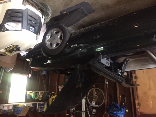

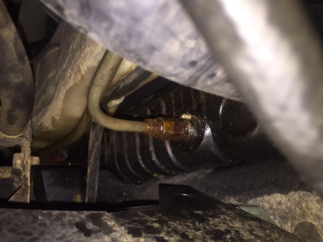

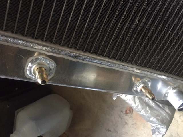

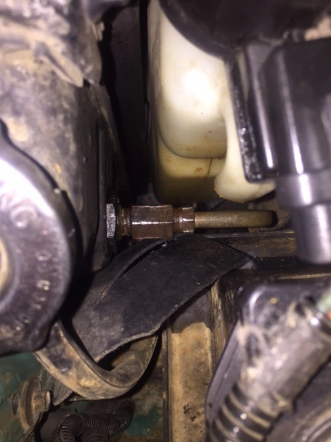

Hello so I am about to replace my radiator and have run into trouble because of the transmission cooling lines. I don't want to break these lines but I have low hopes that I will because they are sooo rusted. I have hit them with that Buster spray and have gone out and bought a 1/2 flare wrench but thought I ask for some ideas. I ordered a new radiator and it came with a set of different connectors but I thought once I accidentally break then lines, these different connectors may come in handy to connect to hose in between the repair. I was even thinking of just cutting these at some point instead of breaking them. Is there a lot on pressure running through these? Also are they full of trans. fluid in there or does ti pump out when engine running? I am open and hoping for suggestions. Thanks

Those actually don't look too bad. You can still get a wrench on them. You'd need to use two wrenches here

Kidding aside, they don't look that bad and as mentioned above, two wrenches and a little bit of gusto and you should be good to go. You will however need to ditch the male flare fittings on the new radiator for some inverted flare fittings if you want to keep the stock connections as they currently are.

Well Thanks for the replies again. Between hitting it with that blaster stuff and a flare wrench they actually came off ok. I was really surprised. The rest of the install went by quickly. I guess if I ever get around to covert to a 5 speed i can ignore these in the future.
