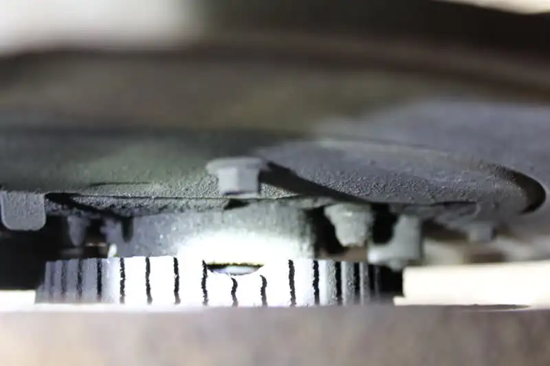

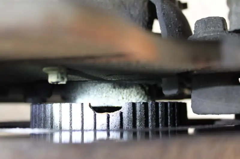

This can't be right is it? Im trying to see why my abs light comes on intermittently
Drivers
Passengers
Yea, thats broken. That sensor is analog and anything blocking or interupting the signal the magnet reads is gonna give inconsistant reading. Hows the car driving out of curiosity?
