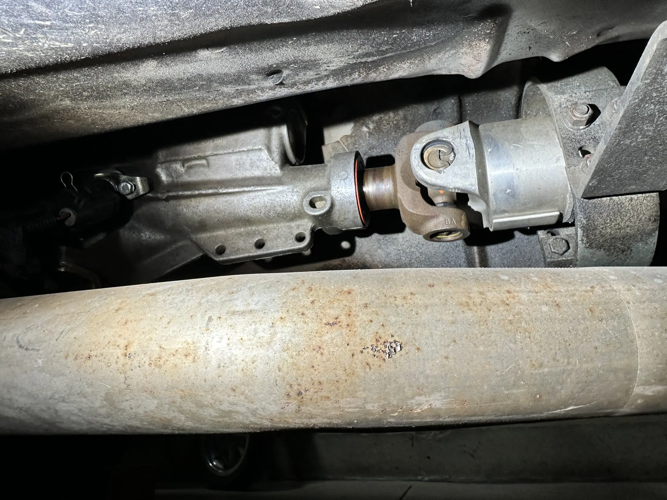

I crawled under the car today and it appears that the driveshaft is solid. I didn’t see any movement up/down or side/side. It does have a little movement/play when twisting it (maybe 1/32”…it barely moves at all), but it feels like it’s more movement within the transmission versus the u joints.

Mine actually has a 9” rear end and an aluminum driveshaft already. I reached out to a driveline shop to see what they’d charge to inspect the full assembly, but I’ll probably pull it regardless and at least chance the joints. They look fairly new, but again, will probably change them out, it doesn’t look too difficult.
Just me but I would pull the DS and have them check that first. No sense in pulling the 9" unless they don't find a problem with the DS or if you just want to.
