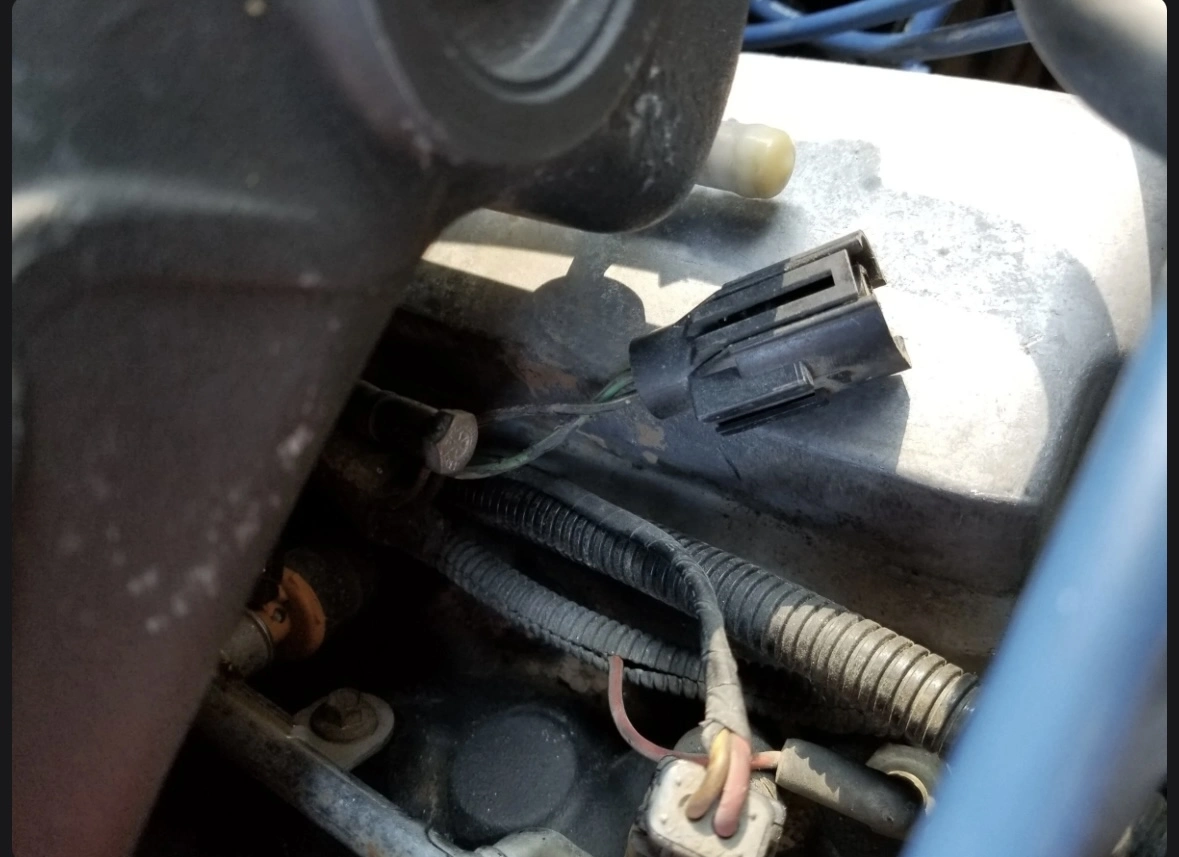

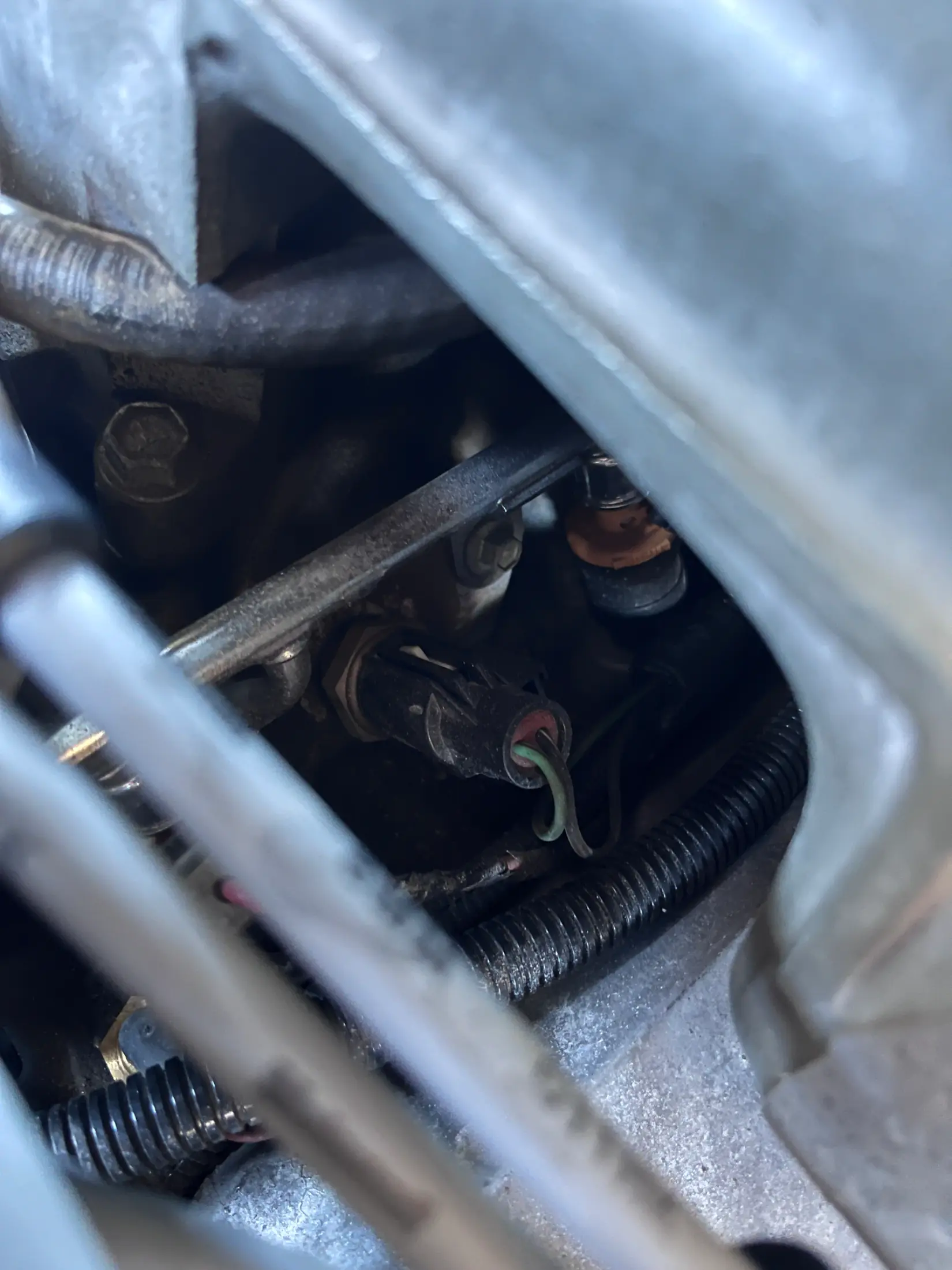

So I bought an 89 mustang lx bout 6 years ago. The motor was sitting next to car and everything had been stripped out of car in the engine bay except the wire harness. I installed a gt40 lower intake with a port drilled for the act as recommended on this site. So now I’ve put everything togeather and I can’t find the act sensor connector. I’ve ordered the sensor and waiting on it but in the meantime time, can someone post me a pic of where on the wire harness the act connects to? I’ve seen pics of the act sensor but have no idea what that sensor connector even looks like
The ACT sensor wiring is in the injector harness. This is a picture of the connector.
