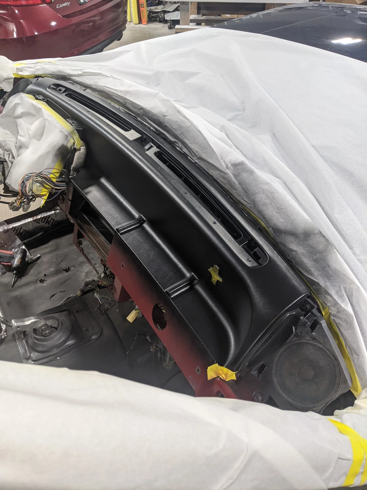

I chose not to use the adhesion promoter, I had saw and read of experiences with it causing the color to be off on the final product
I can't say how it will hold up with out it yet as the car isn't done but the finish is perfect. I used Landau black and Napa red (both SEM)

Yeah, I've seen a lot of notable people on YouTube stay away from it for that reason. However, I was thinking I might try out a trunk panel with the Promoter first to see how it goes. Also, dash came out good! Definitely curious to see how the rest of the car comes out.
