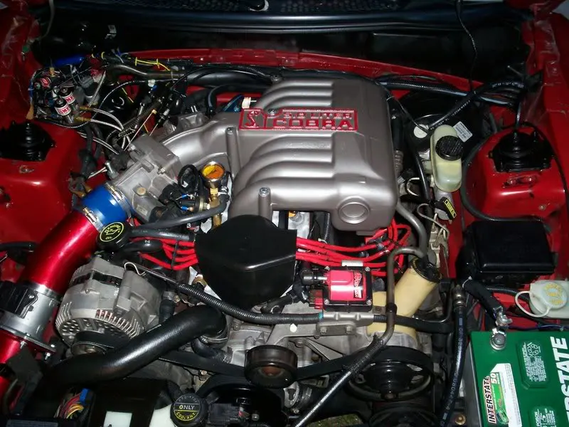

yes, you can use a fuel pressure guage at the schrader valve and this will tell you the pressure coming out of the regulator, this will enable you to adjust pressure. if you use a permanent guage like mine in pic. below ensure its liquid filled.
