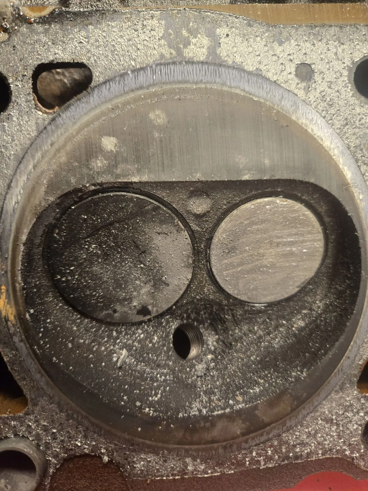

So the back storry and info.

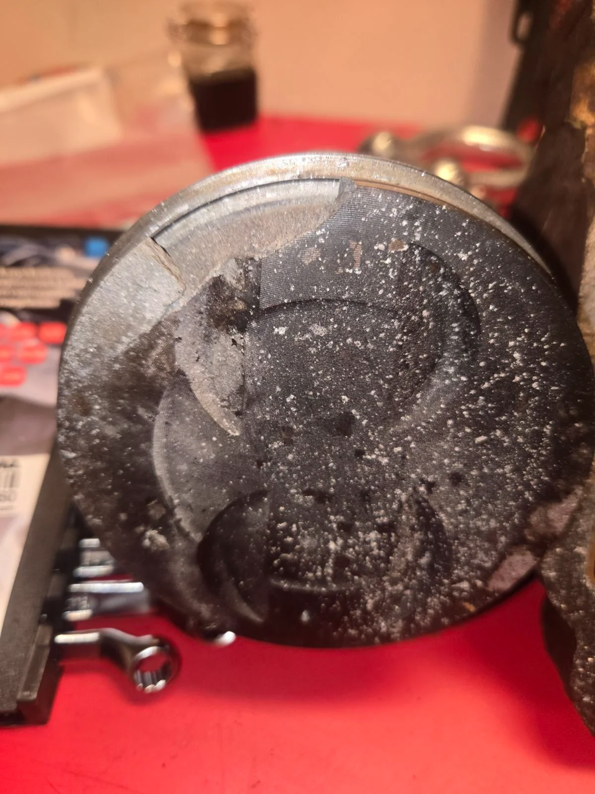

I had an accident. 1995 gt aode.
Is this a comon issue ? Anyone know what could have made this happen ?
Has it happend to annyone els?
Piston 8
Bone stock internals.
Smog delete
Tune
Cold air intake
410 gears
98 pump gas.
No h/c/i
No boost
No nos
Incident happend on acceleration.(no kickdown )

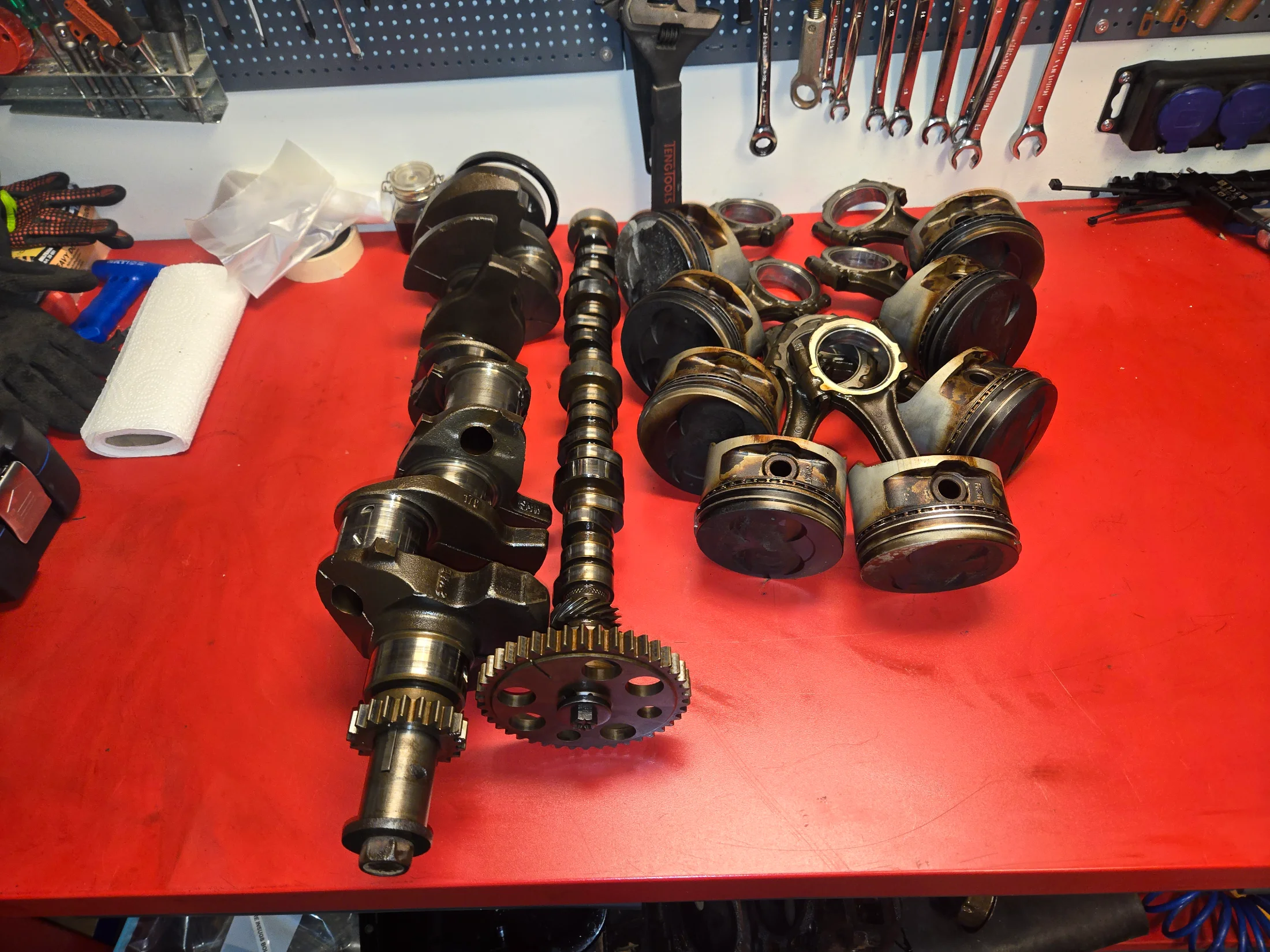

Now the engine is apart and time to rebuild.
And i have no hp number more like a feeling goal.
Im thinking hci a decent one (budget friendly maybe?)
Converter(i think it translates too)
And a sc for maybe 0.6 bar.
what are decent uppgrades to do wile the motor is out? Or needed? Maybe some good fixes and uppgrades wile im doing it?
Also if u got an educated guess on the error that caused this feel free to guess all help and perspektives are welcome.(got a decent list of couses my self)
Gonna be a fun car for goofing around and redlight races/weekend car.
If you know what the adderad side skirt and front bumper is id like too know that also :D
Sorry for bad english and gramar misstakes.(and long post)

Your best bet in your situation in my opinion is going to be to purchase a crate motor and have it shipped.
Do not throw [anything] away.
If you try and do this project piece by piece, the shipping charges are going to murder you.
You can get bumper covers and hardware easy enough at places like LMR: https://lmr.com/product/search?vehicle=1979-93-Mustang&q=bumper&productListPage=1
Here's a link to the skirts:
Now, if you have access to the tools and a machine shop necessary to rebuild the engine then press on with pride. Get a [complete] rebuild kit. I don't imagine you're going to be able to just run the hardware stores for [details].

You said 98 octane gas? In you opening post. Also totally stock , but that blown apart piston suggest going lean .
Never the less you could get a scat stoked kit and go 347.
