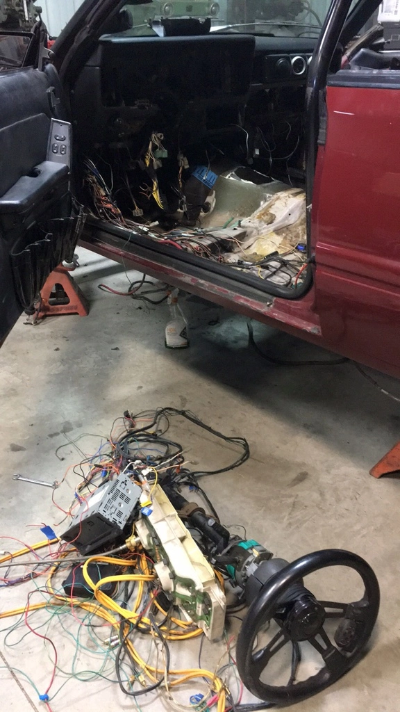

It's looking like I'll need to dig deep into the dash and redo most all the wiring. Which is kind of a bummer since this car seems to have more than any I've had.
One step at a time. Labels on all the MSD before I pulled so I can kinda see what was going on. I'll pull the radio and alarm which should clear a big portion of the rats nest.

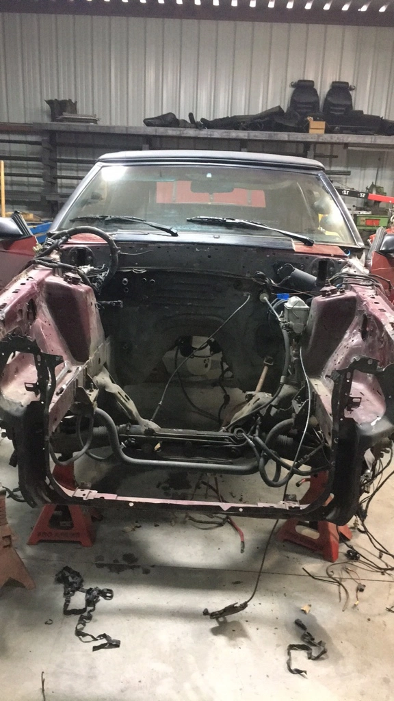

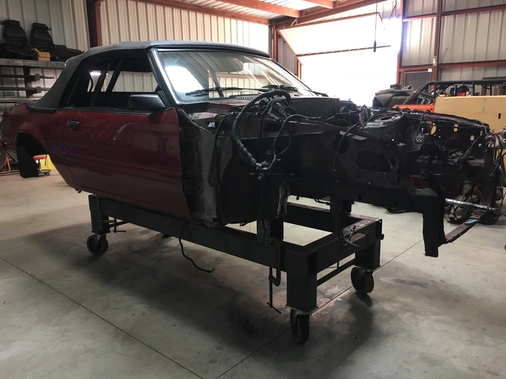

I'm In strip down mode at the moment. I'll pull the core, radiator and disconnect lines today. Can't do much until the power train is out. Once down to the body only I'll put it on a table and check it. I'm guessing it will need to be pulled a bit. Cutting in the frame rails will likely let it move easily. Considering building all new torque boxes. Sometimes easiest to make new than repair.

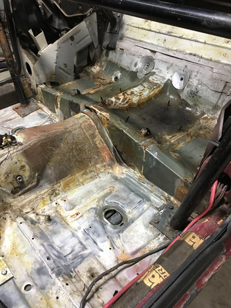

Interior is pretty much gutted. Ready to cut for frame rails and torque boxes.

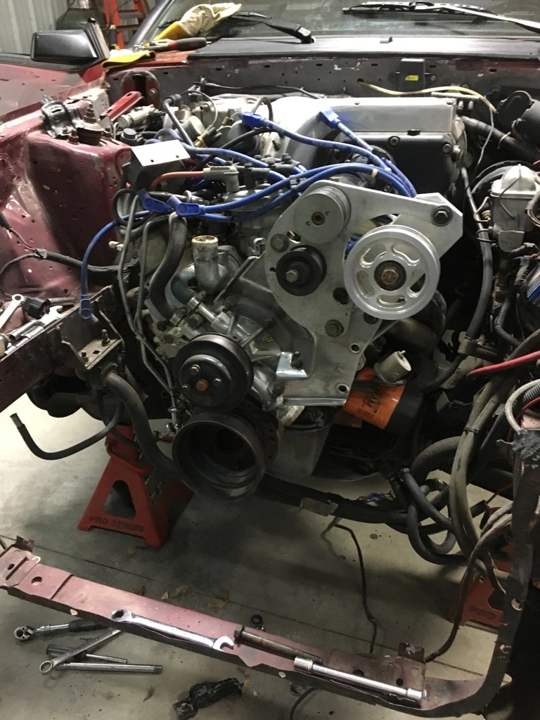

Engine is ready to pull.
Once my buddy is free to help pull I'll get it leveled out and square.
I don't want to start cutting till then.

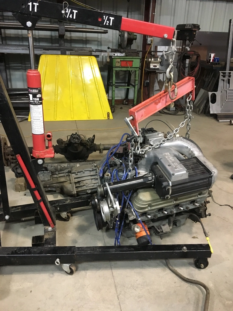

I like having a clear engine pull. I may make the core removable so I don't have to lift so high

Just replace the lower radiator support like @90sickfox did with a bolt in tubular.
Reactions: 90sickfox
TeamZ makes a nice lower radiator support. You could then drop the kmember and trans crossmember and roll the motor out the front. Just an idea. Wouldn't need the body too high to do it either.[emoji106]
