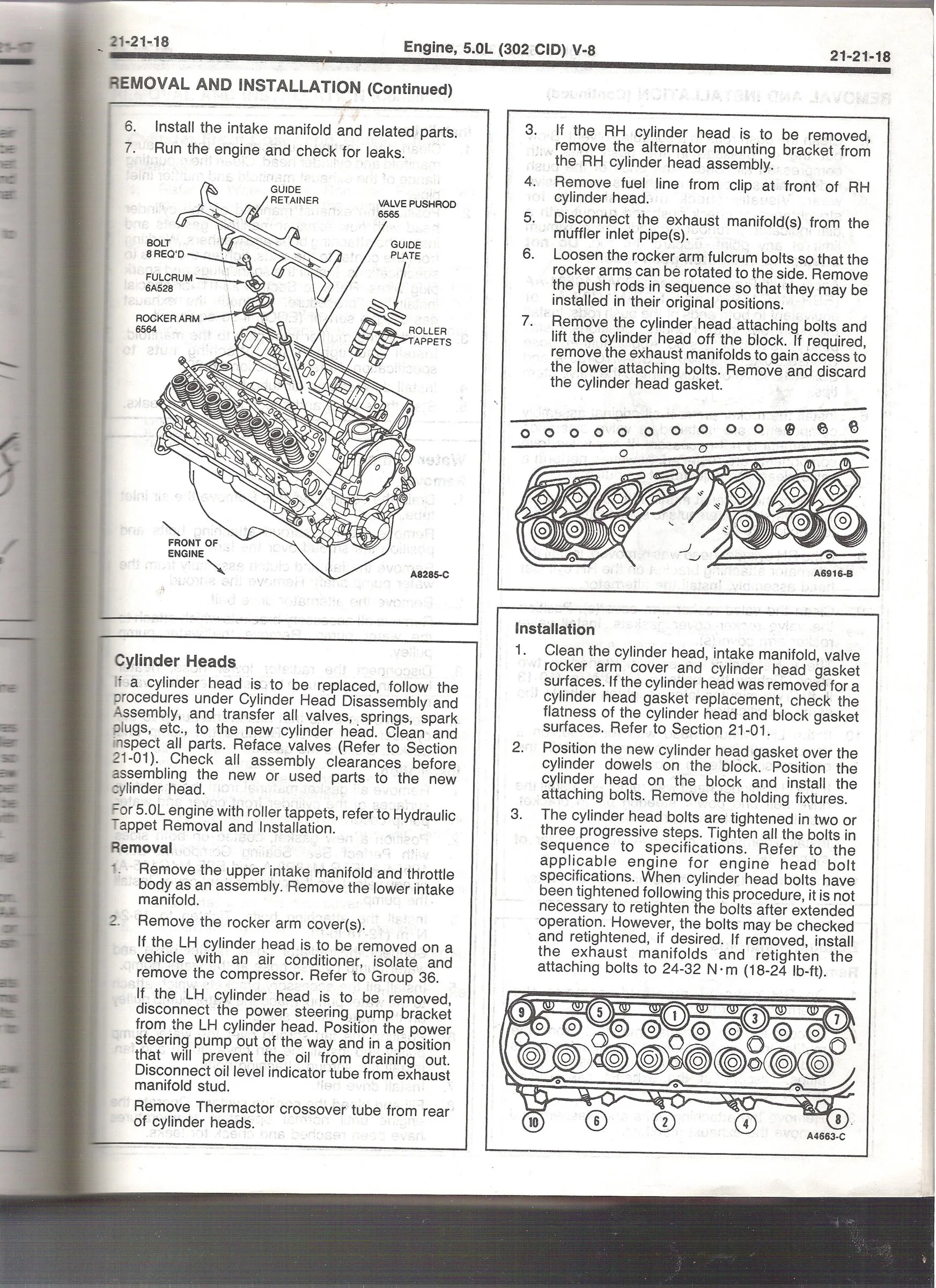

karthief said:
Now I am not doubting your experience and your knowledge, but my ford assembly manuel for my 89 gt says the head bolts are torque to yield and are not reuseable. Thats head bolts right?
And in your opinion are studs overkill for na setups?
Here's what I have straight from the 89 Mustang OEM Service manual
Granted, the last time I actually had the cylinder heads off, I used ARP bolts when I put the heads back on the engine. I ran into the same storm of conflicting information that you are seeing here.
General karthief
Mod Dude
Aug 25, 2016
28,099
10,714
213
polk county florida
Dec 11, 2016
#16
  • Dec 11, 2016
  • #16
Damn, I have that same book and darned if it don't say the same thing!
Once again, I am confused!
I don't recall now where I got my info but you can bet I will look into it.
I changed the head gaskets on my 92 vert and used new head bolts, that maybe where I got it from.
Damn fords, any wonder guys put bow ties in everything
Once again I bow to you and the blue oval gods and beg forgiveness.
