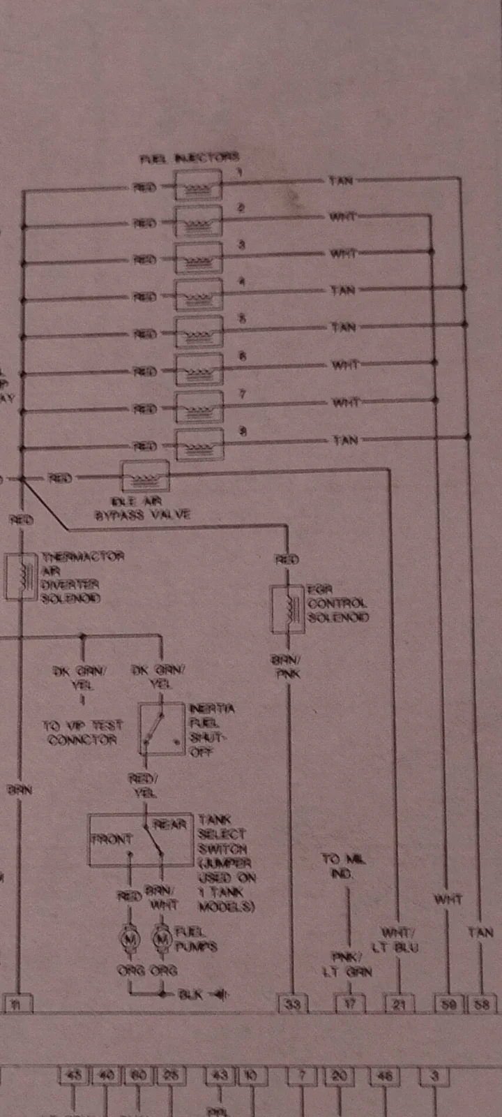

Putting HO heads on a regular 302 isnt rocket science and the camshaft is the real difference over the heads.........
The regular and the HO engines have different firing orders... Ho firing order is 13726548..Standard 302 is 15423678
So your HO brain wont work on a standard firing order engine...You need to swap the camshaft too or repin the injectors at the ECU plug to open at the right time...........
To repin you need a schematic of the ecu plug and then swap 3 for 5 /7 for 4/3 for 6/5 for 6/4 for 7 and if its a batch fire system youll have to either ive with the injector mismatch or rewire them at the fuelrail as there will be 4 injectors on pin 58 and 4 injectors on pin 59 that spray at the same time every 180 degrees of engine rotation of the crankshaft so the right fuel injectors need to be grouped into bank 1 and bank 2 correctly.
Either way you got a lil work to do and Good Luck
