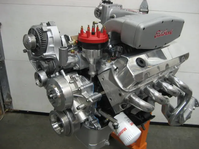

the forged shortblock is stock block with Eagle crank & rods with SRP forged pistons, DSS main girdle, all balanced. at the moment it has an F cam in it. the comp ratio is 8.7 to 1 as it was built for boost. Came with a Canton 7 qt pan, and the balancer & flywheel.
The AFR's I have are 58 cc and been milled so the comp ratio should raise a tad. Its ready for boost which is where I might go in a year or so.
Not alot needs to be done...gonna swap on some different VCs and call it a day.

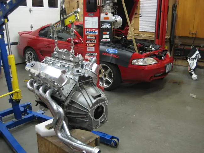

Was able to drop motor with the LTs on no problem...also bought a CR racing/Visteon radiator and dry ran that and the fan and alls good, got an inch to spare. Canton 7 qt fit around the stock K member no problem, dropped it right on the motor mounts and all cleared thank you....
I sold my motor 2 months ago to force myself to finish this thing....wanna drive before the snow so I got my finger out and did it.
Bought a king cobra from Anderson Ford, its built to his specs and good for 450 ponies with the stock feel. You name it I replaced it...only thing original is the starter, alt is being replaced, have a polished one on the road... I got all new Ford sensors to boot. Figured i do it all now and its done.

Here she be.... 8.9 comp,all forged, balanced, girdled, SRP pistons, Scat crank, AFR 185s warmed over by FTI with FTI cam, Scorp 1.6s, Eddy RPM, Accu 75, 1 5/8 ceramic LTs, I'm gonna start with 24s aS my MAF is set for them. I have 30s if i dyno and she needs em. With 373s she should pull just fine.. If i get real bored its ready for boost....:nice:
Its nice to have it done...spent all Summer working on the house and just want this done...miss driving it.
