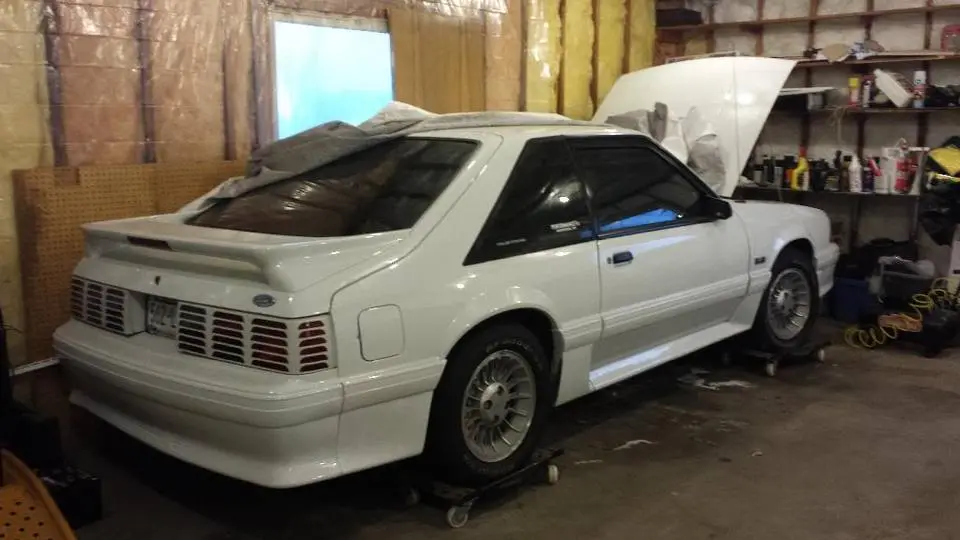

What do I need to do to the wife's car? It's been away for 6 years and up on dollies. I'm trying to think of the things that need to be done to make sure I can drive it without issue. I've already aired up the tires and put the battery on the tender. Do I need to drop the tank? I've got a new filter to put on. I was going to also change the oil and then take it to work. I work at a dealership so I plan to flush coolant on a hoist. Anything else I'm missing?
If it matters, it's an 88GT 5.0L with an AOD.
THANKS!
Also, should I try and spin the crank before trying to start it? If yes, which direction if it matters? My assumption is to rotate clockwise, but I've never attempted it and don't want to break anything...
if you pulled the plugs it would do the same as hand turning id think...
maybe a little lube like mm oil on top just incase to help the rings out?
mine's sat a couple years at a time and I just fire it up 225k never an issue...
Change the oil and coolant. Drain the gas and replace with fresh as well. Pull the plugs and put a few drops of oil in each cylinder. Spin crank by hand. Direction doesn't matter. If it spins freely, floor the gas pedal and crank the key. Flooring the pedal will tell the ecu to keep the injectors from pulsing. Crank in a few short bursts and this will oil the system.

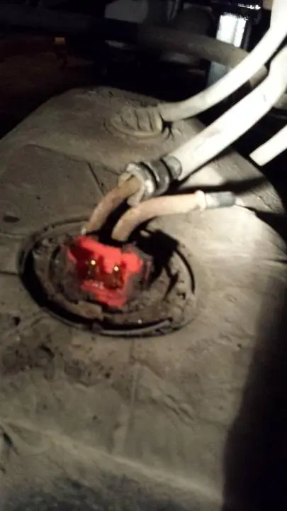

I dropped the tank, most of the way anyway. There is a clip that I couldn't figure out how to remove. It's not the duck bill style but the other one. Anyone know which one I'm talking about? How do I remove that line from the tank? Also, there is a breather valve in the tank, does that just pull out? The hose doesn't want to come off of it so I figured it would be easier to pull the whole valve out.
The gas inside the tank looks pretty good. There isn't anything clumpy or dirty looking. I guess dropping the tank was a bit overkill but I'm glad I did. I may throw a feul pump in while it's out, any suggestions?

I got the tank completely out tonight. Looking into the tank it looks spotless. I dumped all the fuel out and everything seems to look pretty good in there. I'm going to leave the stock fuel pump there for now as I could use the $100+ to fix other issues that WILL come up.
