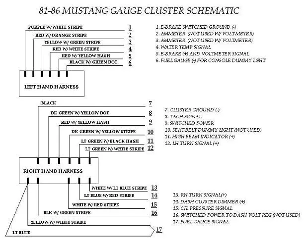

Another question. Does the new gauge plate you're ordering come with the blinker lights, hi-beam and e-brake lights? You'll have to tap into those too. Another thing that I did was got a 12 pin and a 9 pin plug from Radio Shack so that i could remove the cluster without having to remove the wire taps from the factory wiring. They come with both the male and female plugs so that you can make your own gauge cluster harness. You'll also need a 1-2 inch longer speedo cable with a GM screw on end for the gauge side. If you call Autometer's tech dept. they can make this for you.
This project is a little involved but not really that difficult to assemble. It just seems pretty daunting if you're not familiar with the gauges and wiring. Email me if you need somemore help. I really don't mind. I'm just kinda pissed that someone else out there is going to have gauges as cool as mine.

OOPS! Here it is.
