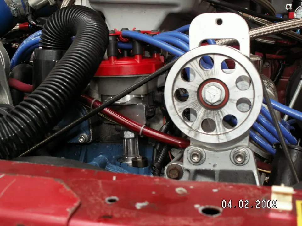

UPDATE
Ok i changed the PIP.....It was nasty inside the distributor. All kinds of dirt and crud. (Distributor was from a truck and i got it on EBAY)

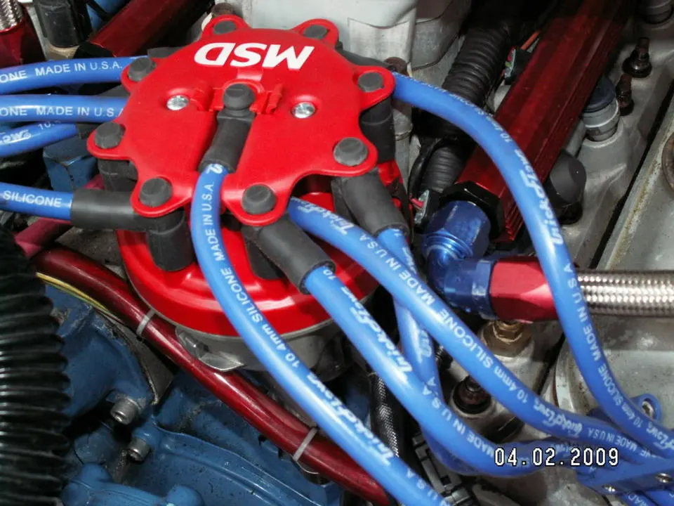

I cleaned it out.....Wire wheeled the outside to look nice. Then i changed the Cap and Rotor with a MSD. Surprisingly the 10mm coil wire fit on the cap.
So far ran a few errands today and no random stalling. So i think im good now. :nice:
On a Side note i noticed the Brass contacts inside of the cap are nearly twice the size of the stock replacement or the Accel piece. Is it worth the extra $$$ I say yeah but prob. only because only like the cap design. Yeah i know the MSD logo is upside down....but theres no clearance to route the Coil wire next to the intake.
And now Pics....
